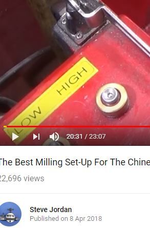

                                        #355907
                                          Well the first hit on that lathe suggests it has two speed ranges which are arrived at by gear or belt not a direct drive and not the 50-2500 shown on the front. Now you can see why more detail has been asked for.
                                          Even then they have all copied the same spec and al got it wrong as the 2 speed ranges are 50-1250 and 100-2500
                                          Take a closer look at Steve Jordan's machine and you will see a big lable that says "High-Low" which referes to the gears for the non direct drive from motor to spindle
                                          Edited By JasonB on 30/05/2018 17:15:33
