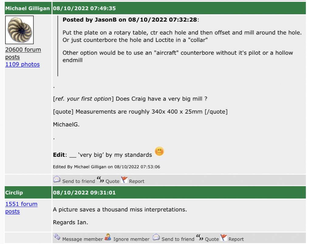

                        Put the plate on a rotary table, ctr each hole and then offset and mill around the hole. Or just counterbore the hole and Loctite in a "collar"
                        Other option would be to use an "aircraft" counterbore without it's pilot or a hollow endmill
                        #616510
                          Posted by JasonB on 08/10/2022 07:32:28:
                          [ref. your first option] Does Craig have a very big mill ?
                          [quote] Measurements are roughly 340x 400 x 25mm [/quote]
                          Edit: __ ‘very big’ by my standards blush
                          Edited By Michael Gilligan on 08/10/2022 07:53:06
                          #616527
                          Circlip
                            @circlip
                            A picture saves a thousand miss interpretations.
                            Regards Ian.
