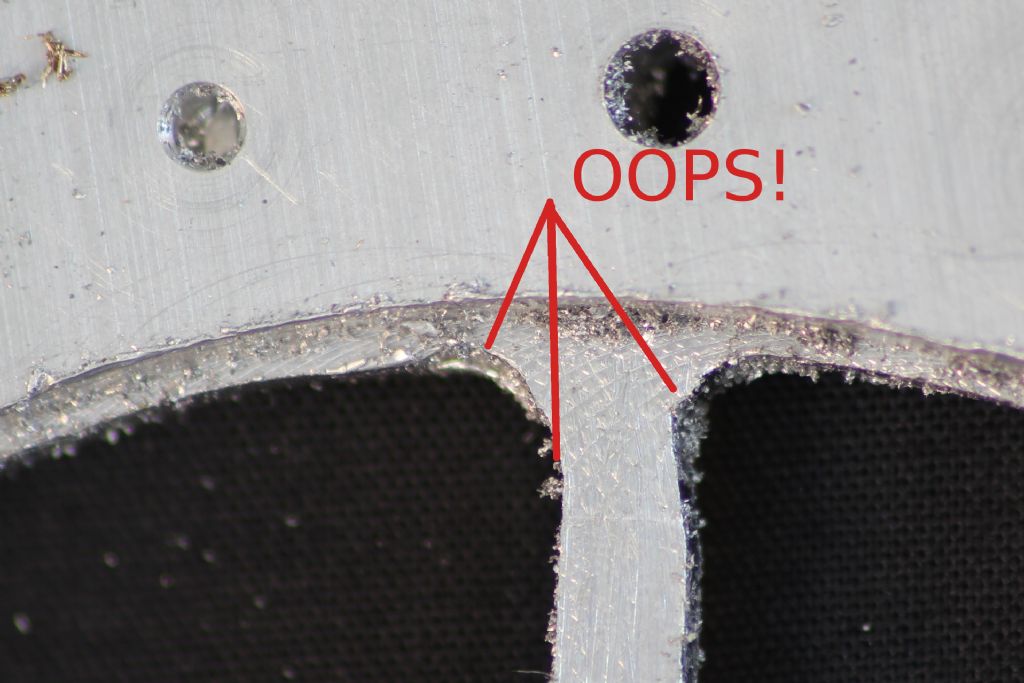

      I'm building the Jan Ridders Coffee Pot Stirling at the moment. Although my self-taught skills have improved considerably I am still in the bottom 10% of the class when it comes to finish, and I'm trying to improve.
      I generally manage to put holes in the right place, turn to wanted diameters, and mill to the correct depth, more or less. The things I make usually work but the finish is poor. (This is not false modesty!)
      One of my mistakes is that when starting a cut, or changing direction, I have a strong tendency to turn milling table axis controls the wrong way. This drives the cutter into metal that has to be left untouched if the object is to look good. Quite small errors can spoil an otherwise acceptable bit of work.
      This picture is a close-up of the flywheel. You can see that I have crashed no less than three times into this particular spoke. It is very annoying because the other 5 are quite good, at least by my standards!
      I feel like a learner driver having trouble with parallel parking again. My confusion is something to do with reversals of right-left and forward-backward movements, and ditto with my rotary table. (I usually get up-down right thank goodness!)
      Is there a trick to this like "lefty loosey, righty tighty" or is it just practice, practice, practice? All hints and advice gratefully received.

          You might be able to make that good with alutite, especiually if you can use clay or similar to make small 'mould'.

            I think for the most part it is just practice, and more practice, eventually it will become second nature.one little thing might help in the early stages. Stick a piece of paper on the bed near to the x, handle, mark an arrow on the paper pointing in the clockwise direction of the handle and another arrow pointing down the bed to show direction of travel. Do the same for the y axis. I guess thats why we had 5 years+ apprenticeships years ago . Even now after all these years I leave particularly demanding work to first thing in the morning before I get "brain fade".

              Its a bit like riding a bike – you have to get used to turning in the right direction. You fall off a few times before you can ride it. – Sorry, no better advice.

                Buy a Sharpie pen and draw arrows all over your machine/rotary table until it becomes second nature to turn the handle the correct way. It wipes off no problem.

                  You could try fitting travel stops on all axis so your table movements will be restricted to the part you want to machine, same applies to the rotary table, stops can be fitted to prevent overtravel.

                    Most rotary tables turn in the direction that you turn the handle. It all comes easy to me but I have over 50 years of doing it. Don't worry we all went through the same dilemma, soon it will become second nature to you.

                          Like you, I too had difficulty in getting my head around the handle-twiddling on my first mill. In the end, I thought of the table and crosslide as big "nuts" and the handle as the head of a bolt threaded into it. Think lefthand thread and turn it anti-clockwise to bring the (for example) Y-axis travel towards you. Similarly with the X-axis movement.

                            The next MEW includes a suggestion for retro-fitting stops to a rotary table by putting a pair of moveable rings with 'ears' around the table. They closely resemble embroidery rings.

                                  When I surface with my mill, I always put a rag over the wheel I must not turn. Not quiet the same, but it saves holes being bored in flat surfaces.
