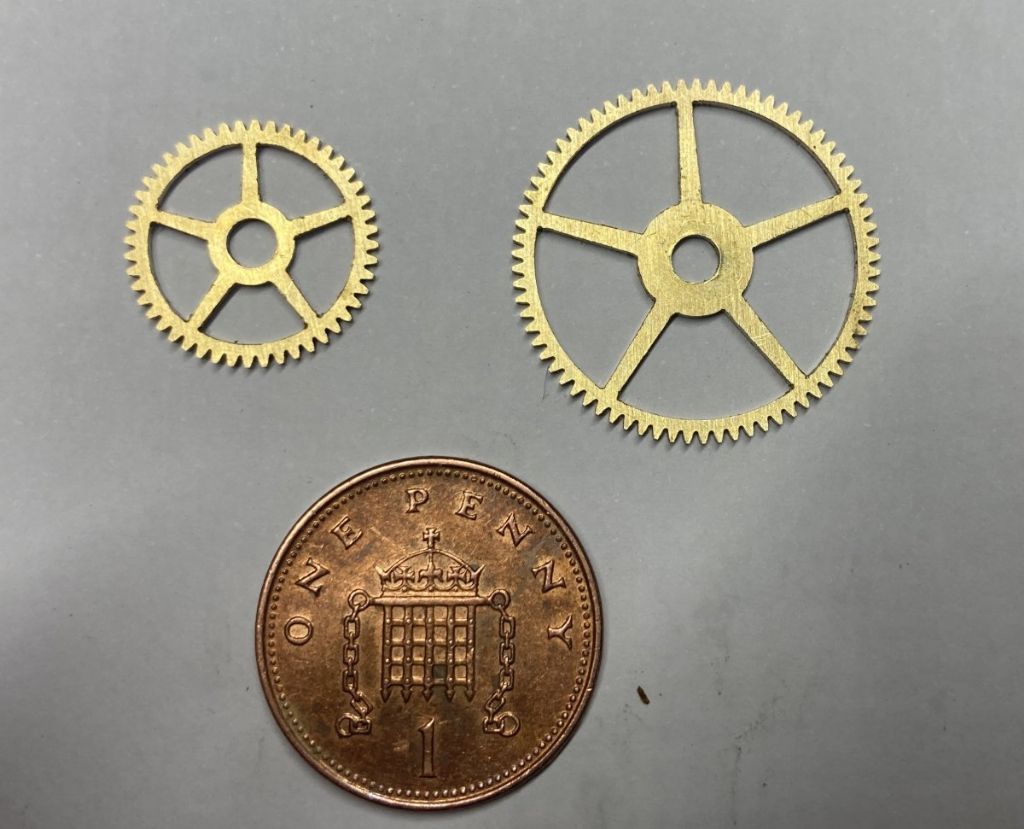

      I've had a go at crossing out some small clock wheels on my Sherline rotary table and mill. Here's a 48 and 73 tooth wheel. And a penny.
      These are straight off the machine with a "fingernail" deburr.
      I drilled out the corners first with a 0.4mm bit then milled out the rest with a 1mm 2 flute carbide end mill. The material is 1mm CZ120.
      There was a lot of trig and calculations to get the indexing right but I'm quite pleased with the results. With the 0.2mm radius corners, there is a minimum of filing to do.
      My question is, is there a better tool than a 2 flute end mill for this process?
      I have been taking depth of cuts no more than 0.3mm so 4 passes to get through. Does any one know of a bit that could do this in 1 or 2 passes?
      I have quite a few of these to do.
      Please bear in mind that my max spindle speed (2,800) is an order of magnitude slower than ideal!
      Cheers,
      Steve

          I don't think you could go much deeper with a 1mm cutter particularly when hand feeding which is hard to keep constant unless you like buying new cutters
          A general rule of thumb is D/4 often a bit less on the very small dia cutters so your 0.3 is just over that.
          Only thing that may speed it up a bit is switching to a 3-flute cutter which although I would use at teh same depth could be fed faster

            Thank you Jason , I thought I was at the limit with depth.
            It is not a question of speeding things up – my thought is the less passes I have to make, the less chance of an error!
            I have a CNC rotary table so I cut the hub and rim under power and hand feed for the spokes.

              A freind of mine did his wheels that way on a Seig X1 CNC conversion. He used an engraving spindle (the type with a flexi drive and remote motor) mounted insted of the milling head. The cutter he used to favour were router type (more like a rotary burr). We use the same cutters on our PCB machine to rout out PCB's and they cut at a fair old rate. You could consider mounting such a spindle as an auxilliary to your mill offset from the mail spindle.
              regards Martin

                For full width slotting my preferred milling cutter manufacturer recommends a maximum DOC of 0.5D for 6mm and over, and 0.2D for less than 6mm. For making a nameplate in 1mm thick engraving brass sheet I used a 1mm 3-flute carbide cutter with a stepdown of 0.2mm:
                I ran at 24000rpm and a feedrate of 350mm/min.
                For similar in steel I used a 0.5mm 3-flute carbide cutter, also running at 24000rpm, but 120mm/min feedrate. Depth of cut per pass was 0.05mm:
                The original cutters came from Drill Service, but I broke two of them, both after about an hour of machining, so I was operating on the limit. A change to a cutter of the same spec but from Cutwel lasted the two hour machining time with no problems. So I suspect the 0.2D 'rule' tends to go awry for very small cutters (<1mm) and harder materials.
                Andrew
