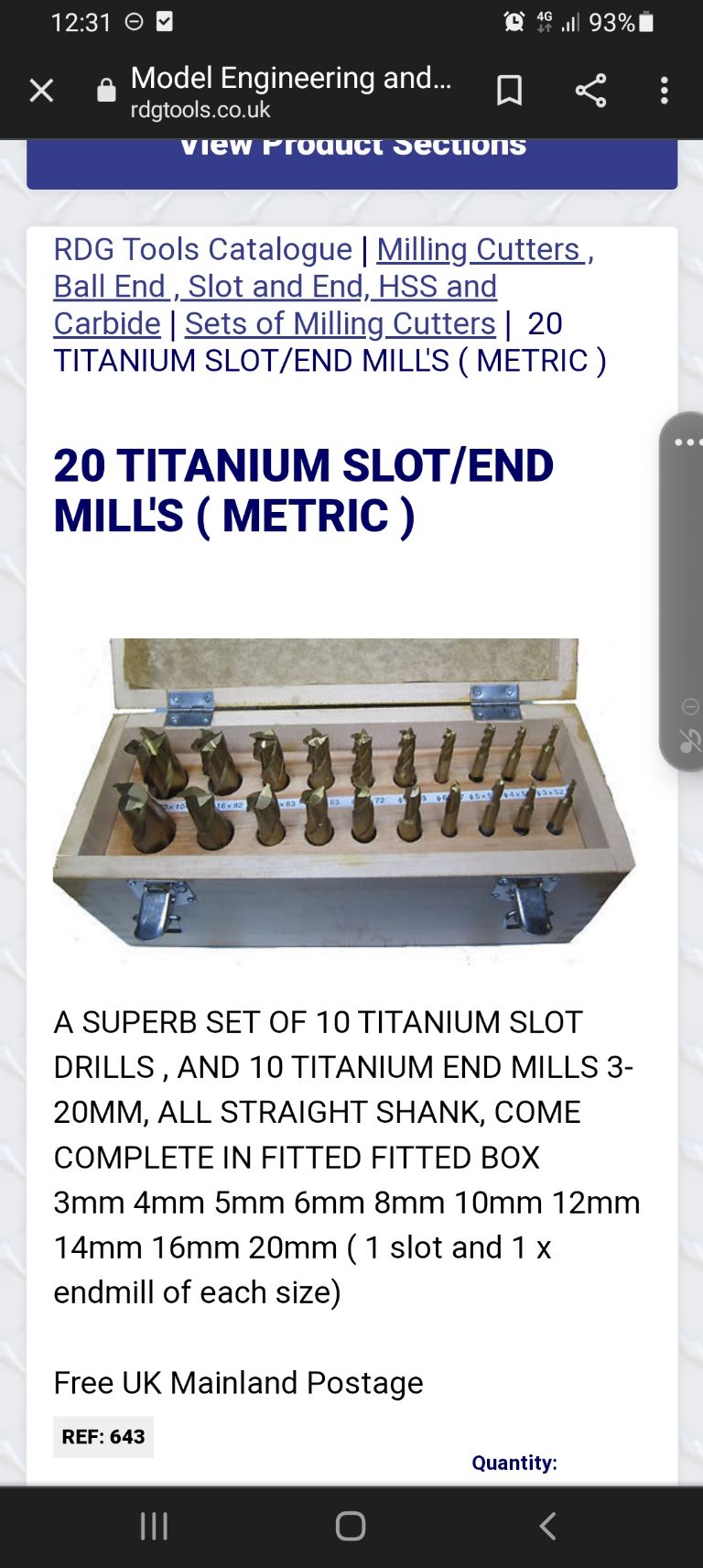

      So I've just got my first mill up and running sojust had a go at some actual machining. I've bought myself a set of cutters from rdg tools and thet are labelled as slot drills and end Mills. To me the only real difference Sean's to be in the number of flutes (2 or 4) Are either of these suitable for 'plunge' cutting? I'm trying to machine a slot that doesn't break through the side of the work and I'm not having much luck but I'm doing much better when feeding in from the side.

                    RDG's description of these as Titanium Slot/End Mills raised my eyebrows! Pretty sure they're not made of Titanium, or are the special type of cutters used to machine Titanium.
                    Not a problem though, because they're almost certainly the usual HSS coated with Titanium Nitride for extra hardness. Might even be the same set as the ones I have (not bought from RDG) which work well.

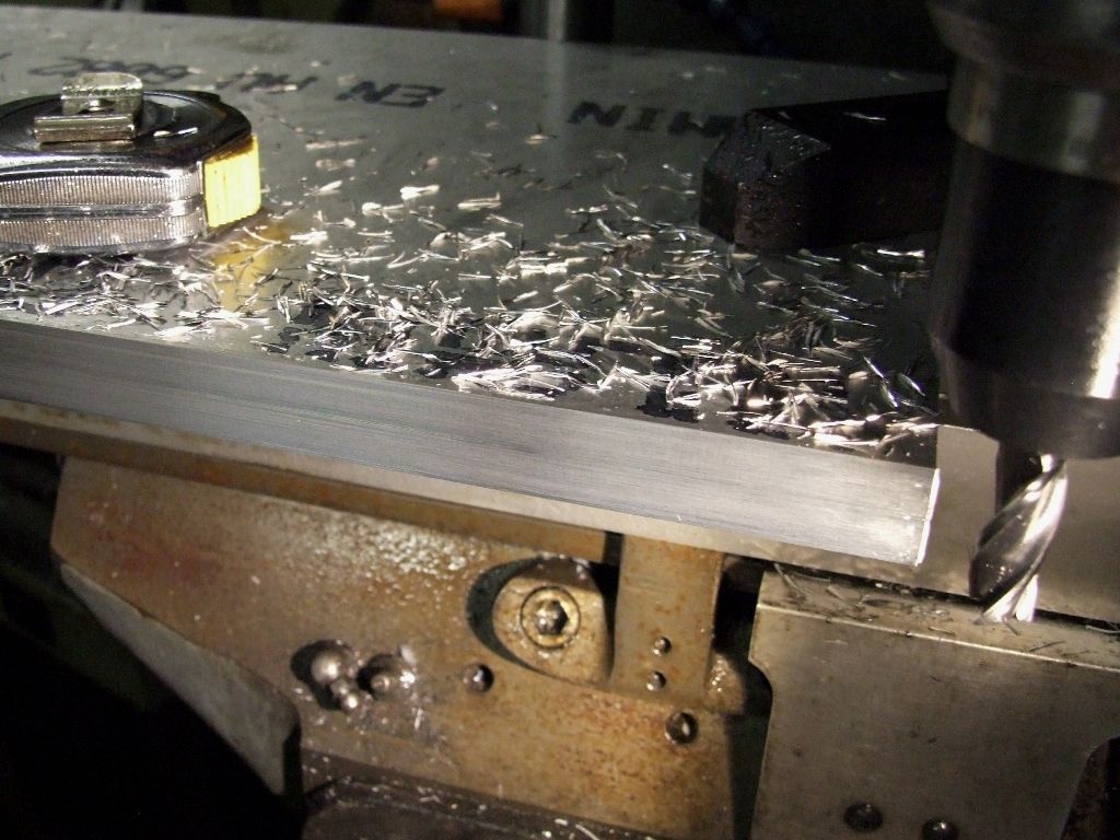

                                    A few pictures for interest, milling the edge of tooling plate, 25mm thick, with a (worn) 10mm carbide endmill. First, conventional milling and cutting dry:

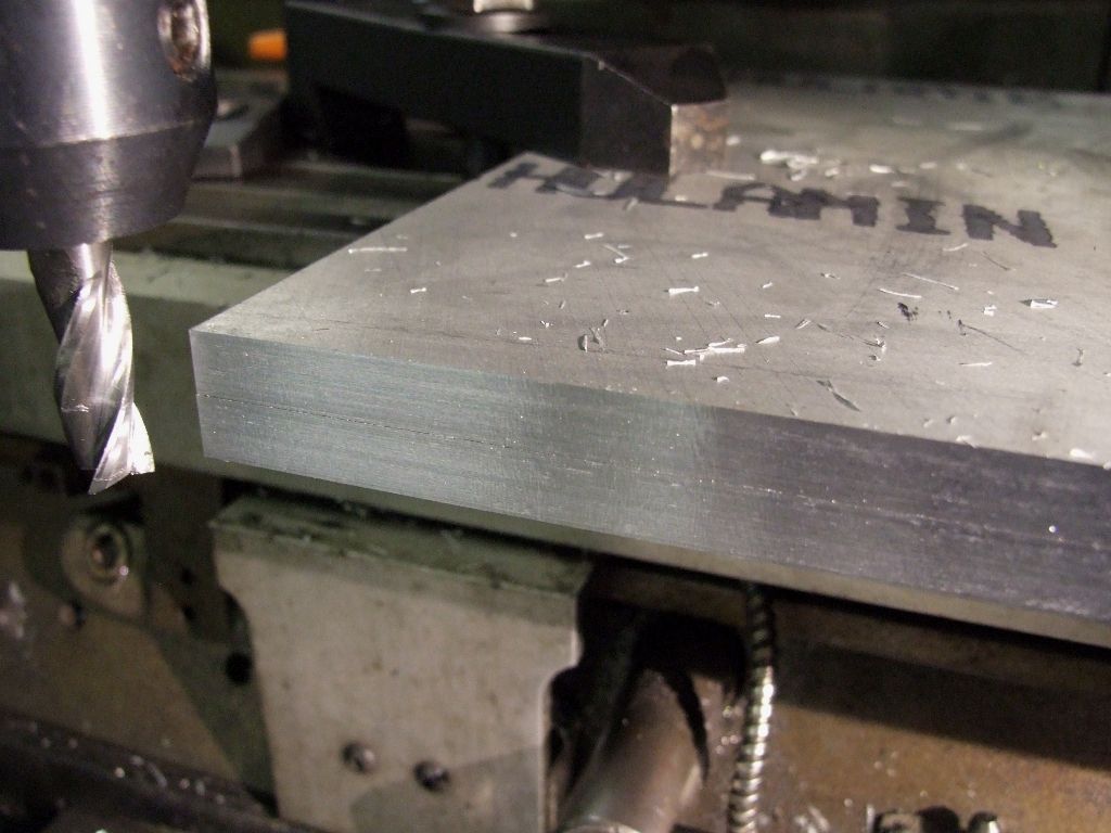

                                    Climb milling, cutting dry:

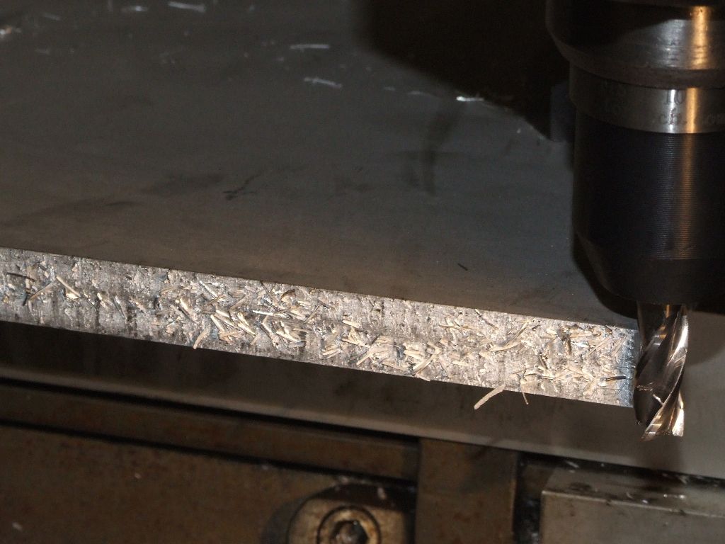

                                    And conventional milling with a squirt of WD40:

                                      Just to clarify:
                                      Climb milling removes more metal per watt and produces a better finish but it requires a well-adjusted powerful machine in good condition to take deep cuts. Most hobby mills aren't rigid enough to take deep climb cuts and they also hammer the drive and motor.
                                      Conventional milling stresses the machine far less but tends to leave a poorer finish. So I remove most of the metal by milling conventionally and then finish off with a shallow climb cut, not deep enough to cause any vibration.
