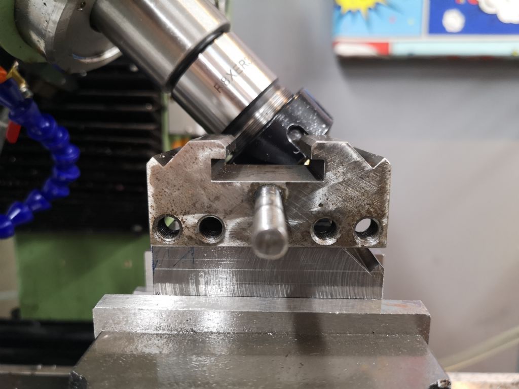

      I'm currently attempting (with varying degrees of success) to replicate my T1 Dickson tool holder.
      The next step is to mill 4 'v' slots (see the image below).
      Looks like you can buy insert tool holders which cut 'v' slots at 90 degrees, which would suffice if I mounted the work end-up. However I'd like to avoid buying tools I'd only use once or twice.
      I'd it we're just one tool holder I'd be happy to just shove it on the vice BUT the goal is to mill say 4 at a time from one piece of stock before chopping them up.
      The current plan (unless convinced otherwise) is to hold the work at 45 degrees and use an endmill to make the cut.
      How would *you* hold such a piece?

          Hi Lee, Guys,
          Whilst your picture shows one way of getting a 45 degree angle, its not a good way of holding work for milling. My recommendation would be to buy a proper inverted cutter and secure the work to the mill table properly. At a pinch you could use a 45 degree HSS or carbide countersink and take it easy with the cut.

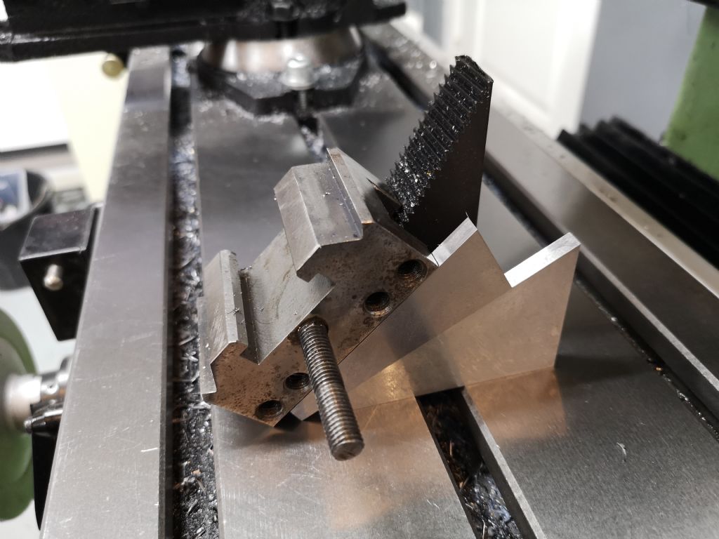

          #473263
          duncan webster 1
            @duncanwebster1
            one of these? Check you have enough headroom before parting with money!
            adjustable angle plate
            #473267
            Lee Jones 6
              @leejones6
              Don't worry John, that setup was just an example of how I need the work oriented.
              I have been looking at those Duncan. Is that the canonical answer?

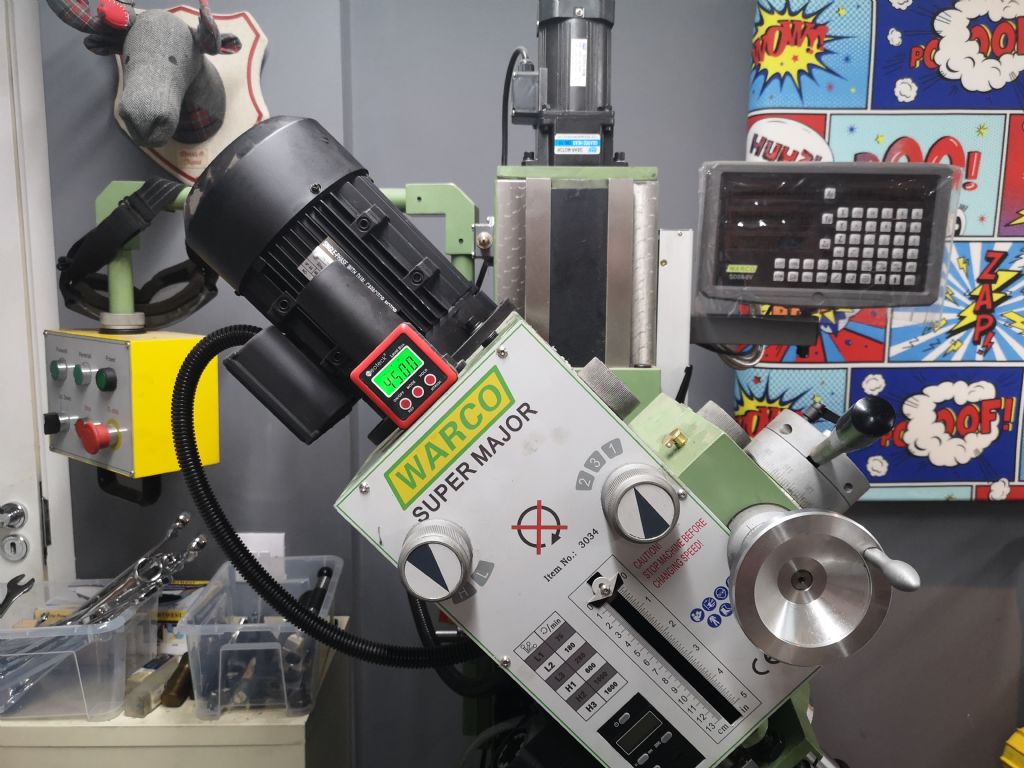

                You have a tilt head mill so why not use it, tilt head 45deg and mount the block flat and solid to the table with the vee you want to cut along the Y axis. No special tools of fixtures needed.
                You can also cut the Tee slot at the same setting which should help keep all cuts running parallel
                I would suggest the longer edge of the Vee is cut with the side of the tool, you paid for long cutting edge so best to use them.

                  Posted by Lee Jones 6 on 20/05/2020 14:41:40:
                  I've used the method shown for non-critical work. But given that the position and accuracy of the Vs are critical to the locking of a toolholder I'd use a tilting angle plate:
                  The table would be set with a precision clinometer, not my cheapo digital angle of dangle meter.

                    I don't think the cross-traverse is long enough to use the tilting head, which is why I passed on that idea.
                    What do you mean by the last sentence? What long cutting edge did I pay for?

                      lee taking your photo as an example.
                      If the upper Vee was cut you would more than likely use the full width of a cutter and maybe 2 or 3 passes at a shallow depth, this tends to wear the bottom of the cutter particularly the corners so you end up with a cutter with ablunt end and unused sides..
                      If on the other hand you were to mill the lower vee the tool would best be brought in from the side taking a tall cut and moving inwards each pass, much like when you widened the groove on your toolholder when the tool slipped. This makes use of more of the side flutes and spreads the wear over a greater area prolonging too life.

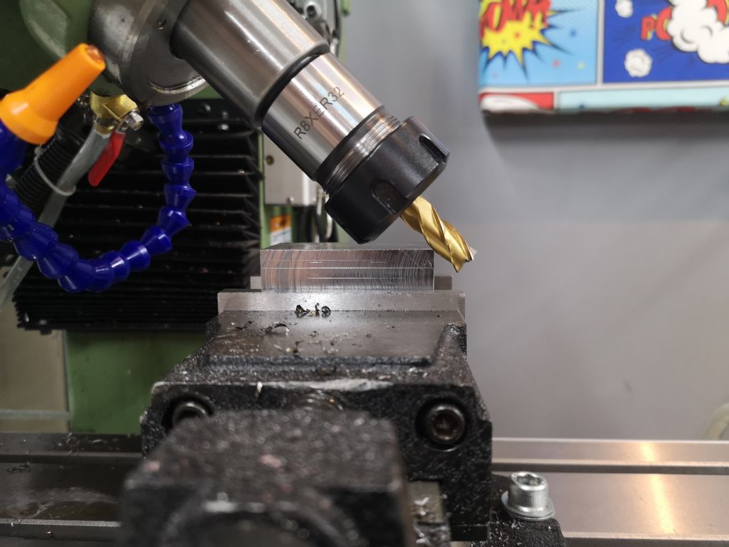

                                  #473372
                                  Lee Jones 6
                                    @leejones6
                                    NB: This is the test piece (not full size).
                                    Whose crazy idea was this:
                                    Let's see how this goes:

                                              Seeing the head at that crazy angle reminds me that the Abwood tilting vise was a good buy. Only used once, so far, but is not eating anything.🙂 I hate moving the head from good tram, just to do one job then have the aggro of re-tramming it….
                                              #473456
                                              Lee Jones 6
                                                @leejones6
                                                Holey poop! 12 videos @ 45mins each. That guy really needs to learn to edit!
                                                Yeah, I really didn't want to tilt the head either but;
                                                a) I've never done it before, so it'll be a learning experience
                                                b) I'm not sure how trammed it was already anyway

                                                Lee Jones 6
                                                  @leejones6
                                                  This was last night's progress (obviously my work is underneath):

                                                      Nice one Lee, you will learn some much from 'having a go', rigidity in machining is one of the key elements & your set up is better than a tilting vise in that respect, as for re-tramming you will also learn from that experience & hopefully become a better machinist.
                                                      Tony
