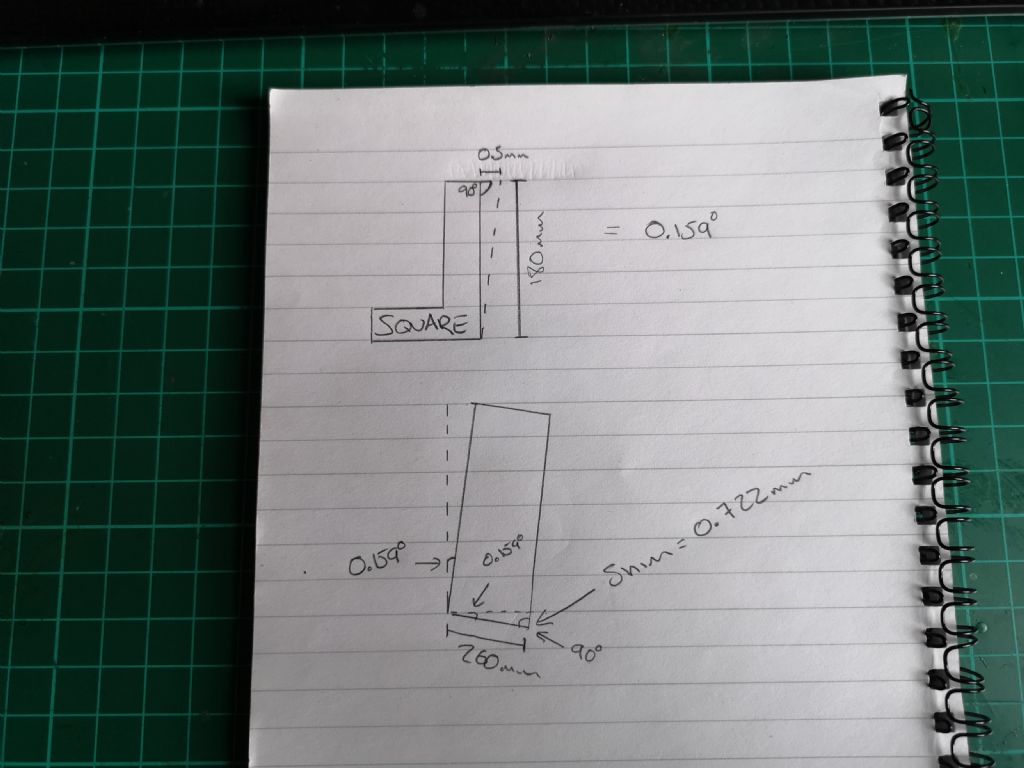

                          How does this look, from a back of a fag packet perspective?

                                    Posted by Lee Jones 6 on 06/12/2020 13:10:28:
                                    It's out by 0.5mm over 180mm????
                                    Holy leaning tower of Pizza, Batman. That's bad, even for Chinese junk. One heck of a shim you need there at over 0.75mm.
                                    You might want to double check everything and make sure. Then try to determine if it's the column or the machine base thats been machined wrong and think about getting it remachined by someone who knows how to use a square.
                                    If your machine is still under warranty now is the time to contact the seller. If they swap you for another machine, check it to as these things tend to be done in batches all the same and it's not unheard of for the replacement to suffer the same problems as the original.

                                        Don't mess about with converting to degrees and back again. Use ratios. 0.5mm over 150mm is the same as 1mm over 300mm. For your example the shim required would be 0.5 x 260/180 = 0.722mm
                                        Also read up on soft foot. This occurs if the mating faces between base and column are not plane surfaces. Basically if loosening and tightening one bolt at a time causes the column to move you probably have a case of soft foot.
                                        If you start moving the bolts holding the column to the base a torque wrench is often recommended to get repeatable results.Also tighten the bolts in the same order each time may be a good habit.

                                          I converted to degrees to obtain the shim stock thickness required. Not sure how to do that with ratios.

                                              The formula is in the post above for shim stock thickness.
                                              error x distance across shimmed distance / distance error was measured over = required shim thickness
                                              0.5 x 260 / 180 = 0.722

                                                Interesting. I'll try to remember that for next time.
                                                I came to the same numbers using trigonometry in just a couple of minutes too.
                                                … and I ended up with a pretty diagram. laugh

                                                  Yes that definitely looks like a consistent "lean" on the vertical column, tested both ways with the square.
                                                  On the one hand its too bad its out of warranty but on the other youve used the machine for 18 months without this fault causing you problems. It does not wreak too much havoc if you machine each job with the head in the one position and use the quill for many operations. It is only when you say drill a hole with the head down low then move the head upwards to fit a tapping head and then the head is out of line with the hole. Or machining one part of a large casting with head in one position and then moving head up or down to machine another level of the casting and you find the head has moved half a millimetre along the x or y axis etc.
                                                  #512112
                                                  Lee Jones 6
                                                    @leejones6
                                                    Posted by Hopper on 07/12/2020 10:36:02:
                                                    I was struggling to see why this would be an issue for me, as the head would still be trammed to the table.
                                                    But you are right. With every move of the head (to say, insert a larger twist drill) the head moves laterally.
                                                    Thanks for taking the time to write that.

                                                      Posted by Lee Jones 6 on 07/12/2020 10:39:13:
                                                      You're welcome. Of course, you could just work around it by moving the table to bring the job back into alignment but that can get to be a PITA on complex jobs and the one time you forget to do it will be the critical last step in a complex job you just spent days on…
