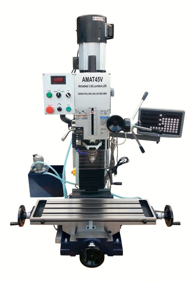

      Hi,
      ZAY7045-ZX45 type mill/drill.
      I want to know exactly how I wind the quill down from a given point.
      How do you deal with the quil play before & after you lock it down regarding the Z-Axis accuracy.
      I bolt a sturdy bracket to the quil, then place dial indicator on it. I also limit the travel equal to the dial indicator travel, which now travel in reverse moving the quill down.
      I can stiffen the quil play before lock down with a provided bolt, however even with this I dont get the indicator not to indicate a variation off the zero mark I set.
      Now I cannot see how I can solve this as a result when fitting DRO to the Z-Axis.
      How do you deal with this-?

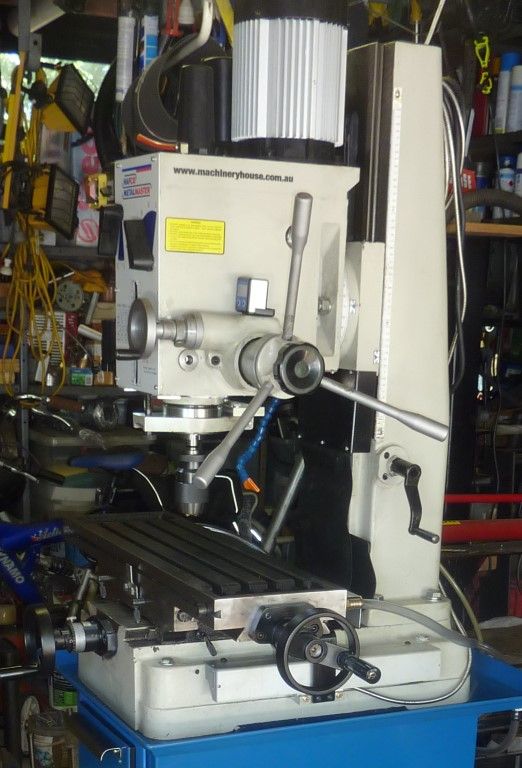

                        dro 4.jpgMy mill/drill is a HM-46 machine with a geared head and dovetail column and filled with a DRO. (another clone of the RF-45 made by Rong Fu and similar to the ZX45)
                        Raising and lowering the column with the crank lever on the column is a cause feed and I use the quill for fine adjustment.
                        I can lower the quill buy less than 0.1mm for fine cuts.. It does not change when I lock the quill.

                              Mine is the same mill and I always use the fine adjust knob to lower the cutter and don't have a problem. As I have said, I can do fine finishing cuts of less than 0.1mm. The fine adjust wheel has a positive feel and a slight turn will raise or lower the quill without any backlash. The quill height does not change when I lock it in position.
                              The RF-45 milling machines are designed by Rong Fu in Taiwan. Mine was made there but sold in Australia buy Machinery House as a HM-46. There are lots of other clones and I believe the ZX45 is made in China. I'm not sure it they are made to a different standard but I recommend the one I have.

                                      Hi, basicly I observe 2 types of play, and unlike the X/Y horizontal axis, you got something that wants to come down with the play involved, the return spring also play a role.(I will look further into this tention)
                                      1-The play between quil rack/pinnion type gear, I can adjust this more tight, but tightness gives you a false imression of where the quil heigt may be, so if you misjudge, I believe a utter can pull it in soewhat depending on baclash left after you adjusted it stiffer-I now understand this trick.
                                      2-The play between the fine adjust workgear mechanism. Now they have fixed pressed the round scale and it has 2x bearings. Not much I can do here, this play is in the design.-I now understand this too.
                                      Because its vertical operation the quil/spindle will move, because you misjudge the direction of the play , and made the quil movement stiffer, then lock it down, in this case you may lock it down with unforseen play in the wrong direction, and a cutter may pull it in somewhat….I annot say I like this situation at all.
                                      Note: I took the fine adjustment mechanism off and apart. It looks new & well made no play in bearings.
                                      The grease was stiff not expected, so clean and regrease.
                                      I will spend more time on this, then do a test cut with dial indicator fitted and see if I cut what I think I should have by measuring the part.(Face cutting)
                                      Thanks for the replies. At the moment I cannot see how a DRO fitment to the quil(Z2) will be accurate here and to be trusted, I will look at SGW's version, the DRO will experience the same as my dial indictor, and yes the stop is the only real flimsy setup on this mill/drill. I did roughtly modified it(This was done few days after I fitted the mill)by letting it slip in an aliminium channell, and replaced the top switch(Removed) with a proper quality switch mounted lower portion secure to indicate the top of the quil position for tapping. This one ectually came with a broken top switch because of the flimsy stop, the stop just crashed the switch as it swivels around.
