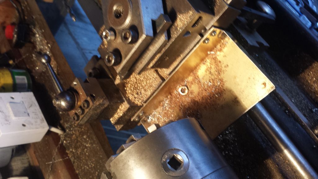

                              geoff walker 1
                                @geoffwalker1
                                Hi Ega,
                                I use this swarf tray to catch parted material. It was a readers tip some years ago in MEW, can't remember the issue number.
                                Two lugs on the tray slide into the cross slide tee slots, so easy to fit and remove. sorry about the angle of the picture. geoffswarf tray

                                #315922
                                ega
                                  @ega
                                  geoff walker 1:
                                  Thanks for the tip; don't worry about the angle of the picture – my lathe isn't set level either!
                                  I know that many authorities recommend a travelling swarf tray; I once used one myself but now prefer the device shown here
                                  which is just a length of unequal aluminium angle held to the saddle via the tapped hole for the travelling steady. The short leg of the angle is covered in self-adhesive velour Fablon which slides nicely against the edge of the cross slide.
                                  I like your namesake, Geoff Theasby's, idea of the magnet although as has been said there are some real disadvantages to their use.
                                  Edited By ega on 08/09/2017 16:02:20
