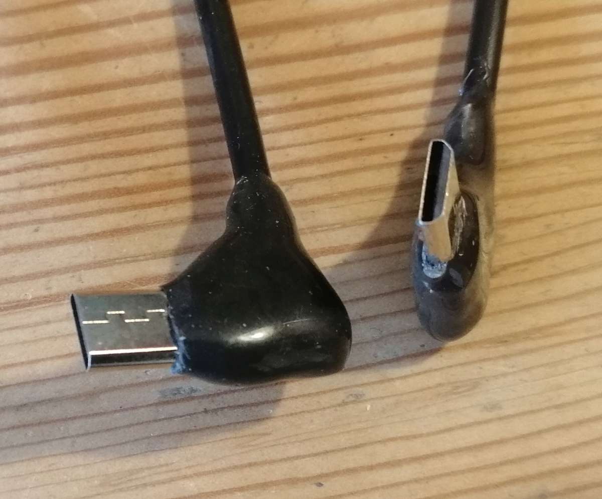

      One of the materials I use occasionally is a metal loaded epoxy that is sold by RS Components as one of their ‘RS Pro’ range. I find it invaluable for creating this connector ‘shell’ for the 15 pole version of a micro USB that Sony call their Multiconnector on the A7 range of cameras. (see picture wired to 8 core cable)
      As far as I can measure on the cured epoxy it has no electrical conductivity. The product Safety Data Sheet (11 detailed pages) gives some of its characteristics but makes no mention of conductivity.
      Purely out of curiosity, I wonder what metal might be used. I’ve heard of ‘Rubber Loaded’ adhesive too)

      Sony A7 15 pole Micro USB

                Unlike the “proper” metal filled epoxies like Devcon Araldite and JB weld which have a metallic content to give them strength, according to the datasheet and SDS this appears to have metal compounds as fillers. Primarily magnesium carbonate by the look of it. Also limestone (calcium carbonate) and talc.
                Makes it fine for the OP’s application (basically thickened adhesive filler) but not for things you would use the various Devcon or JB products for. It seems similar to Plastic Padding (remember that?) which was stone dust filled polyester.

                      I agree that generally the RS Pro is the lower cost products but this particular adhesive seems unique to RS and as far as I can tell is not a re-badged version of any other standard product. I was just curious why RS describe it as metal loaded but I suppose the magnesium carbonate is the metal content but its not metal as we know it Jim.
