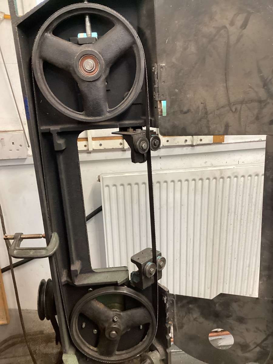

                                                Putting the blade on is easy
                                                1 screw the tension screw down to give plenty of clearance
                                                2 rough fit blade but ignore the guides
                                                3 the important bit. Use a small G clamp to teach the blade some manners  and keep it in one place
                                                4 fit into guides and tighten the blade
                                                the clamp stops the annoying habit of the blade sequentially jumping off the top then bottom pulls when the other is being fixed!  Originally I kept the bottom in place with my foot, but not that easy these days…….  This way is much better
                                                I keep mine permanently on the middle speed, for blades 30 years ago I bought a 100 ft coil for a very good price, then joint  with a tiny chamfer produced with a wood jig on the inisher. A micro flame silver solders it together.  Got enough left for 5 blades. They do last a long time IMG_1341
