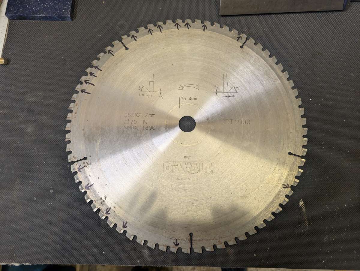

      Good morning all,
      I was recently gifted a very nice Dewalt chop saw which came with a metal cutting blade. Unfortunately some of the teeth (which I assume are carbide) were chipped when the previous owner used it to cut stainless steel.
      Are these blades repairable (is it even worth it) or should I bite the bullet and buy a new one?

        Most saw doctors can braze on replacement tips but at about £5 each it may just be better to get a new blade if too many need replacing as you will also have to pat 25-30p per tooth sharpening.

          I would just get a new one the cost of repair and sharpening will not worth it. When using a chop saw bring the blade down slowly to start the cut and feed slowly, DO NOT force the blade, allow it to cut at it’s own speed. De Walt, Was the machine intended to cut steel, or just aluminium and wood ? Good luck. Noel.

                    #770139
                    DC31k
                      @dc31k
                      On Robert Bowen-Cattry Said:
                      It also came with an abrasive disk which I have been using for now
                      Please post the model number. There is no saw made by DeWalt or anyone else that is suitable for both a toothed blade and an abrasive disk.
                                    If it turns out that the toothed blade was being used incorrectly, that might save you wasting money on a replacement.
                                    It’s a Dewalt D28700. The blade is also Dewalt, I will try and post a pic up when I get a chance.
                                    #770577
                                    DC31k
                                      @dc31k
                                      There’s ya problem lady.
                                      https://www.toolstop.co.uk/dewalt-d28700-355mm-abrasive-chop-saw-110v-p2425/
                                      “No Load Speed 3800 rpm”
                                      https://www.dewalt.co.uk/product/dw872-gb/2200w-355mm-tct-chop-saw-soft-start
                                      “No Load Speed (RPM) 1300”
                                      Homework exercise: work out the surface speed of the blade for both machines in metres per minute and discuss.

                                        Robert Bowen-Cattry
                                          @robertbowen-cattry70600
                                          Fair enough, will stick with the abrasive disk. Saves me buying the much more expensive carbide blade.
                                          As I said at the start of the thread, the previous owner had given me the saw with both the blades (including the one he had broken trying to cut stainless).
                                          #770966
                                          Robert Bowen-Cattry
                                            Good morning all.
                                            This is the blade that I was given with the saw. I’ve marked the damaged teeth.
                                            PXL_20241218_202415657
                                            It seems pointless getting it repaired as I can’t use it with the saw for metal.
                                            #770969
                                              Even if you could use it at £5 per tooth replacement plus a regrind it would cost more than a new blade
