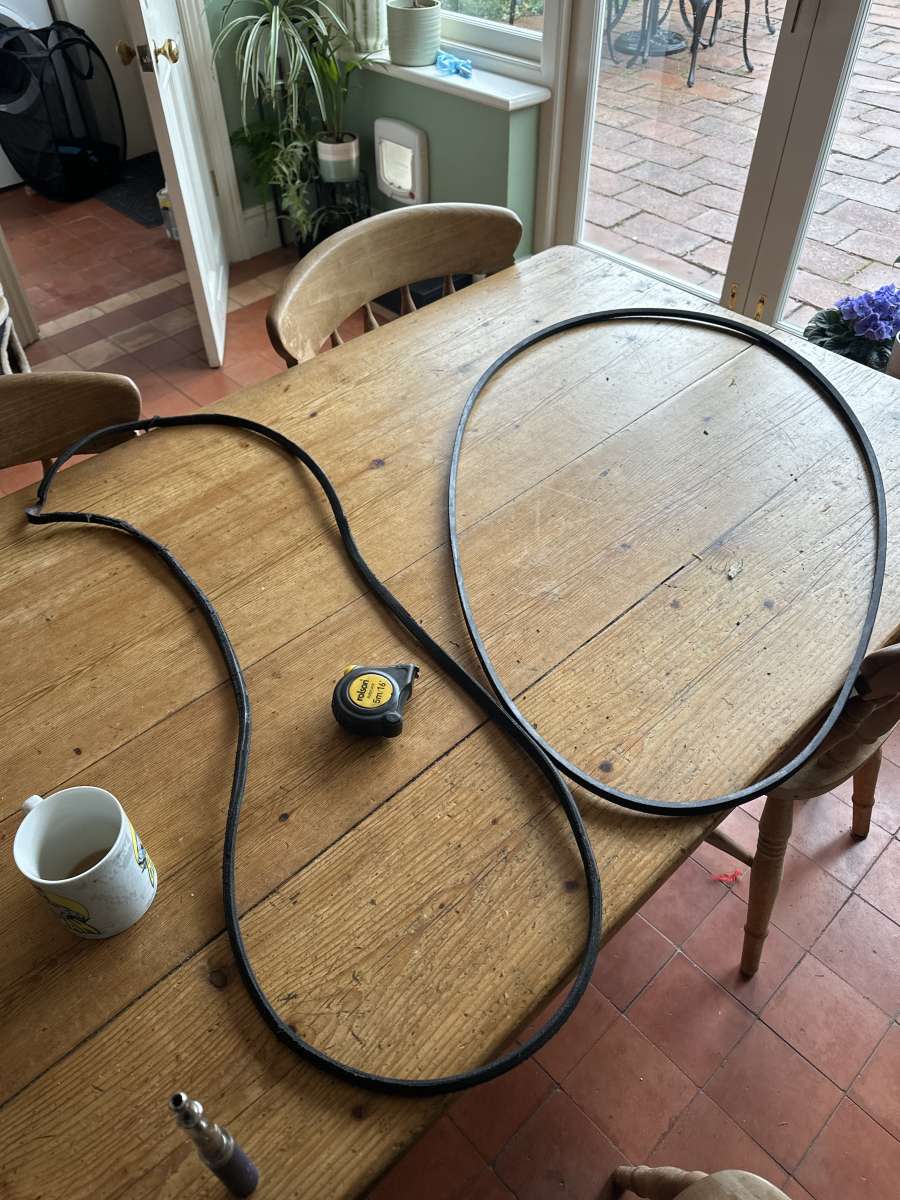

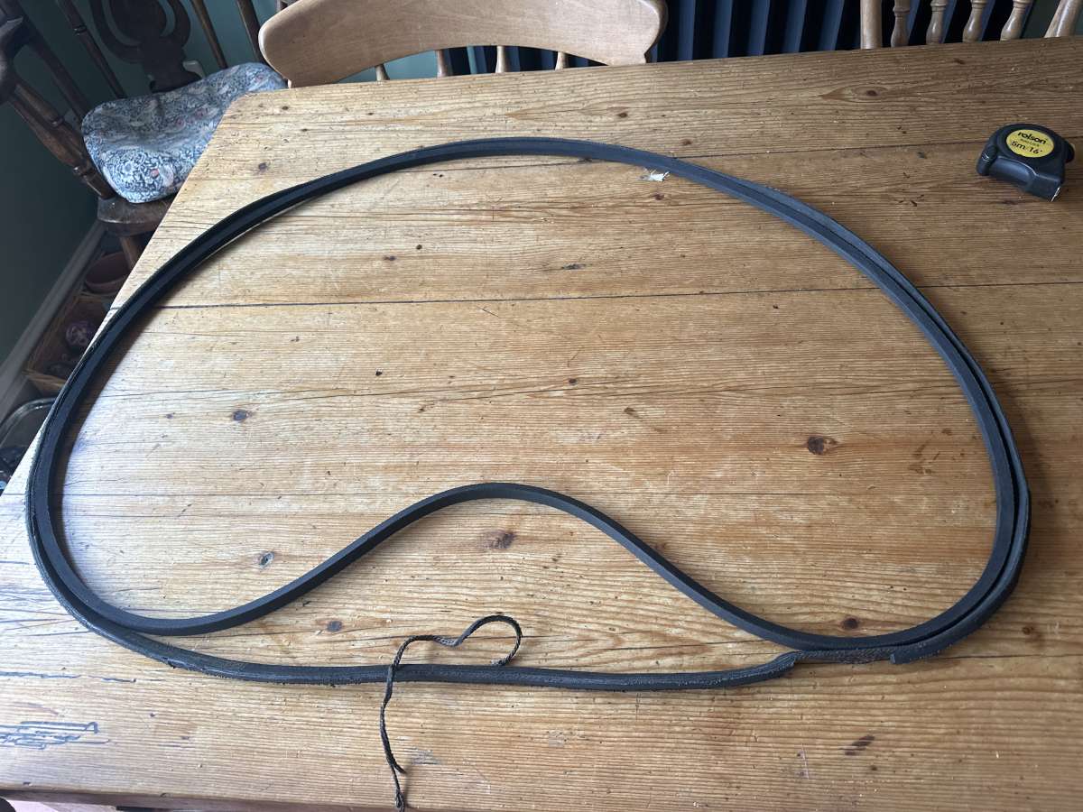

        A visible photo would help, Steve
        Edit: __ Astonishing! … it appeared, as if by magic
        #688712
          Looking at the photo … I can only suggest you overlay the two belts and compare them directly … the old one certainly looks longer to me.

              New one on the inside, old one on the outside
              Now the new one looks longer!
              #688736
                I’m clutching at straws now, Steve … but, are they the same profile/section ?
                If the new one is bigger section, it will sit higher in the pulley grooves.

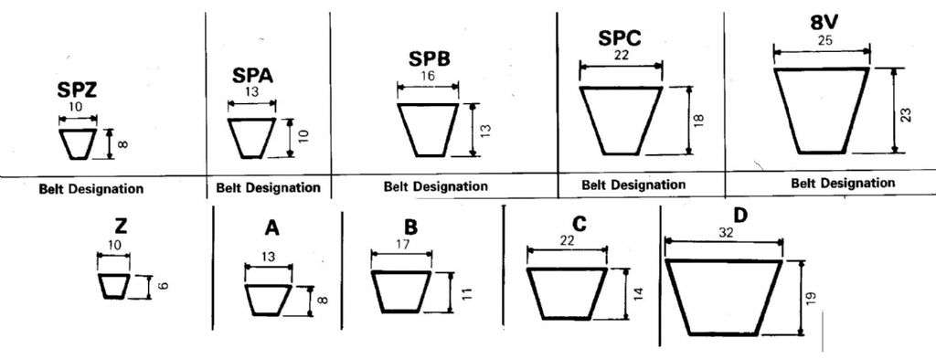

                      Hi, these are all the standard vee belt sections with their sizes.
                      354509
                      There are other non-standard sizes as well though.

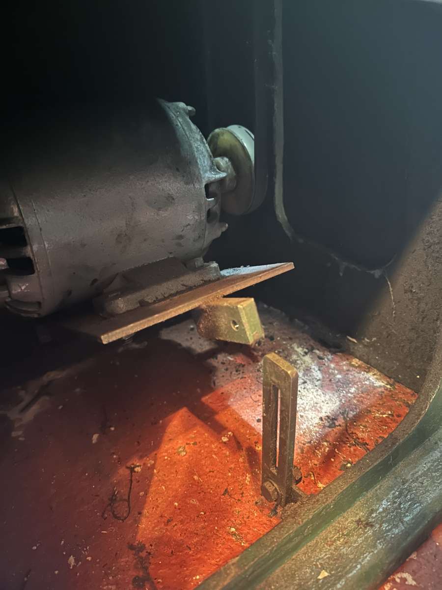

                              It’s annoyingly close…. It may simply be that the old belt stretches slightly under the weight of the motor.
                              IMG_4429
                              #688906
                                On Steve355 Said:
                                But, the pulley at the motor at the base of the surface grinder is about 10cm higher than it needs to be. The new one is too short.
                                Please forgive me for asking, Steve … but was there a x10 typo in that statement ?
                                #688914
                                Steve355
                                  @steve355
                                  No… if you look on the pic above, the bolt hole needs to move down about 10cm so it can be bolted to the slot. So I guess the belt needs to be about 20cm longer. Which sounds like a lot. Must be right though I suppose.
