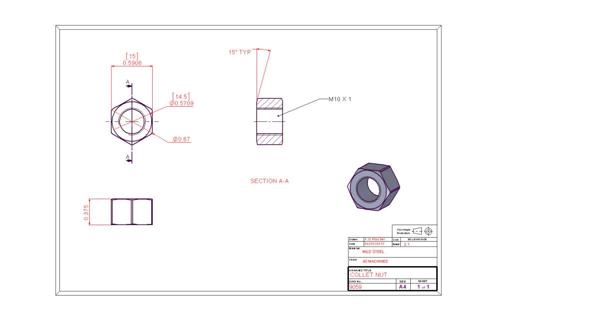

      Does anyone know of a way to accurately measure the taper on Pultra 10mm collet or know what the taper is because I want to make some arbors to hold diamond discs.

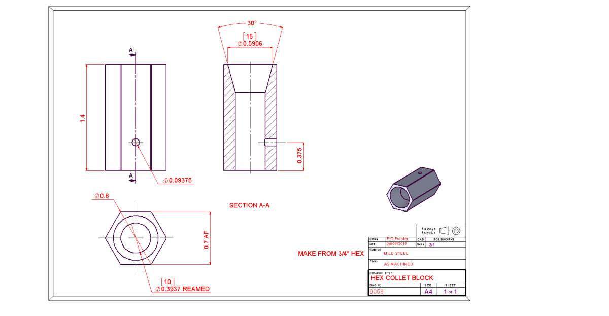

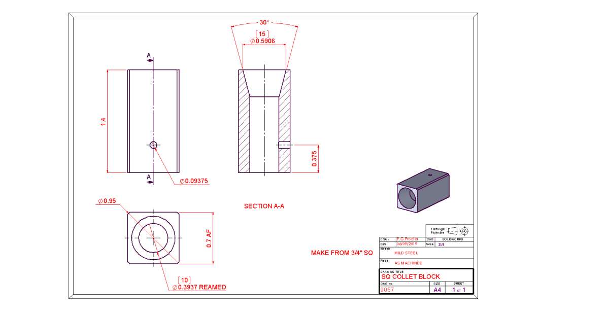

      #686859
      Phil P
        @philp
        Hi
        They are 30° included angle. I made some hex and square collet blocks to use them as work holders for milling.
        HEX COLLET BLOCK

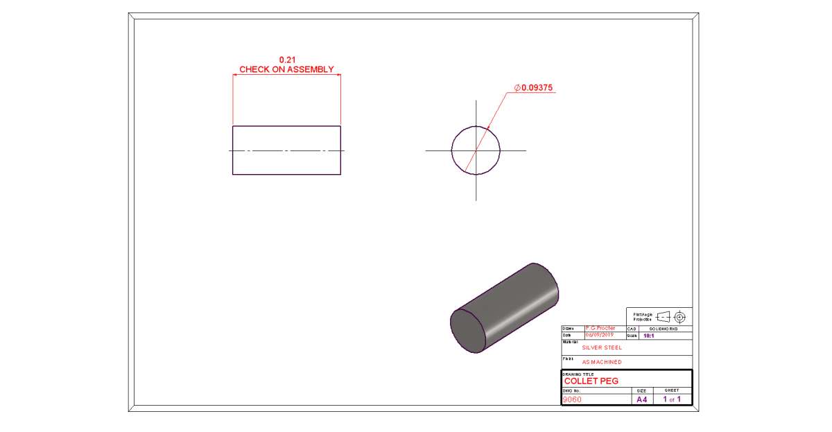

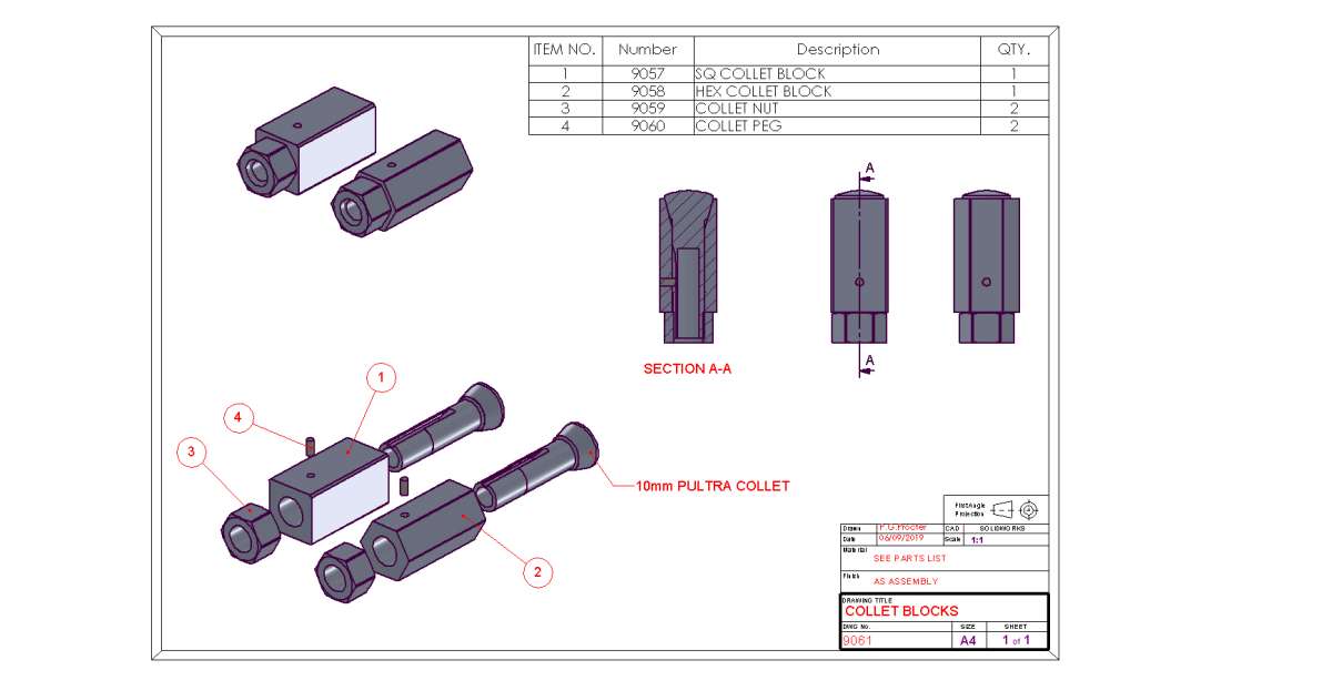

            Here are the other drawings. When you make the nut, try to ensure the thread is perpendicular to the two faces, and also that the two faces are parallel. That makes sure that you can stand it up in the milling vice and it will be nice and square before you nip it up.
