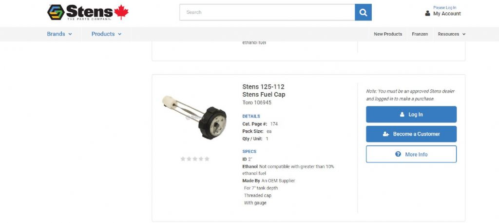

                                          Is the existing clear part flat or top-hat shaped? Most of the ones I've seen on small engines are top hat shaped or have curved flanges, and were moulded plastic originally (not sure which plastic though.)
                                          If flat, a watch crystal could certainly work. Most glass shops in my area that do cutting of glass can cut a round flat piece to order. I've had some done for lamp restorations. Ones local to you may also be able to cut rounds.
                                          That's why I suggested the wood stick fuel gauge for Mark's mower tank originally. Can't beat the price, and the risks are mighty low.The bean can cover idea that Clogs suggested is also a very simple and cost effective alternative to finding a suitable plastic or glass bit that will do the job.
                                          You might try a look at the Stens website in the USA, they make or distribute a huge variety of small engine parts. They may have a replacement fuel gauge assy of the type you need. Example below.fuel-gauge.jpg

                                            Filler neck is an odd size and gauges not available. Too easy to just buy one. Did much research already.
