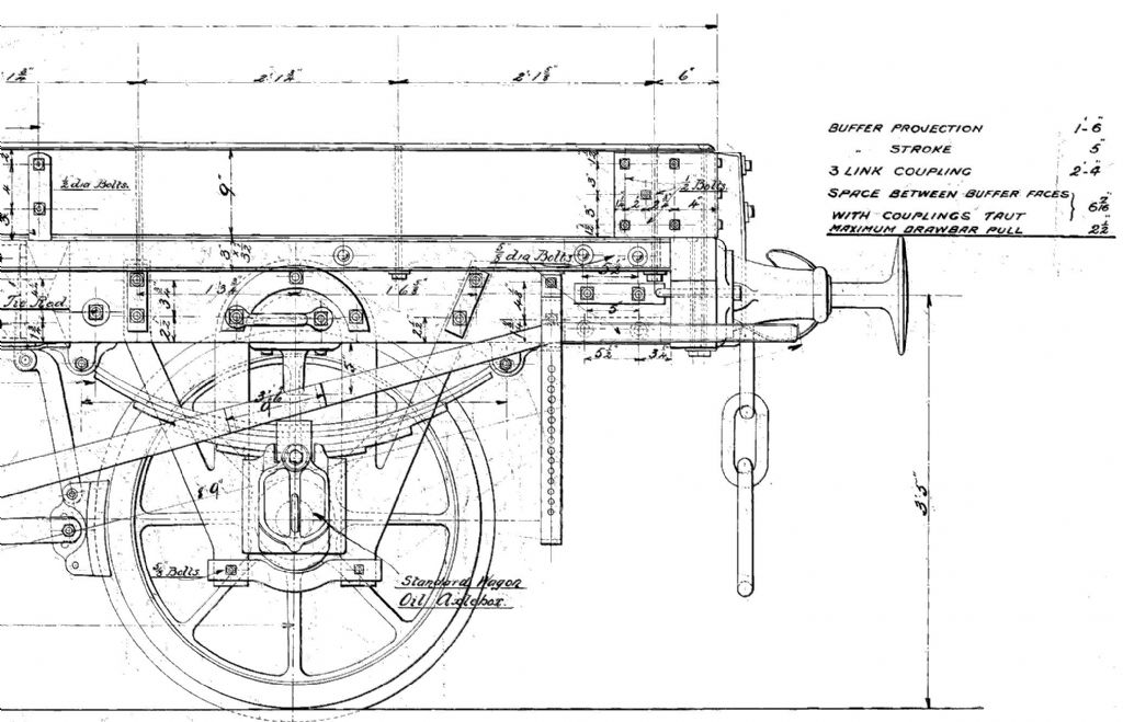

      For some historic models I need about 400 Square Nuts, Steel, with 4 mm Spannersize and 3 mm Height in 8BA or M2. These do ot seem to be available anywhere, or are they?
      If I'll have to bite the bullet and make these myself (have a Myford S7, but not a Pultra Lathe, though)), what would be a clever method to produce alle these nuts?

                                        Yesterday evening and this morning I made together 63 such nuts – learning – using read and front toolposts with lathe cutters and a toolholder/turret in the tailstock. I learned that doing all operations in the lathe was too ambitious for me: The 4 x 4 steel profile easily bends if the profile sticks more than 3 times the width of nut plus cutoff-tool out of the collet. In the end I did the tapping at the bench.
