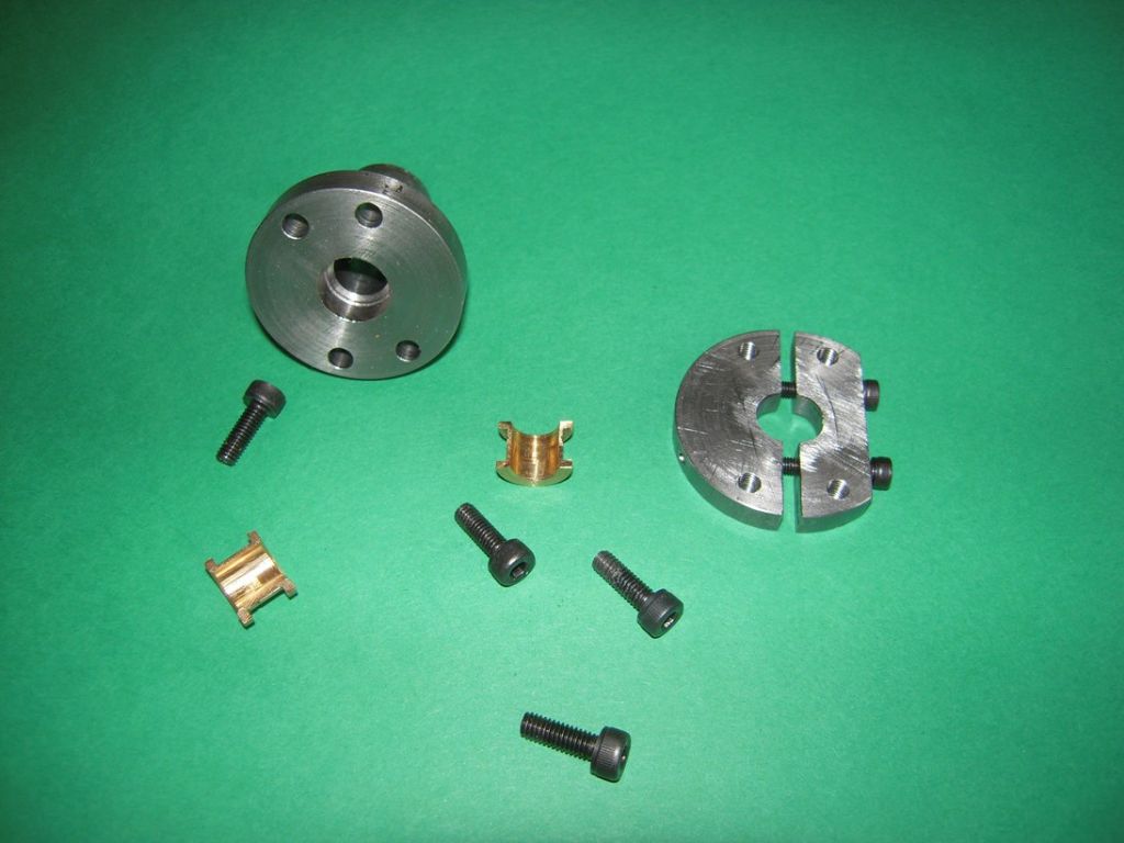

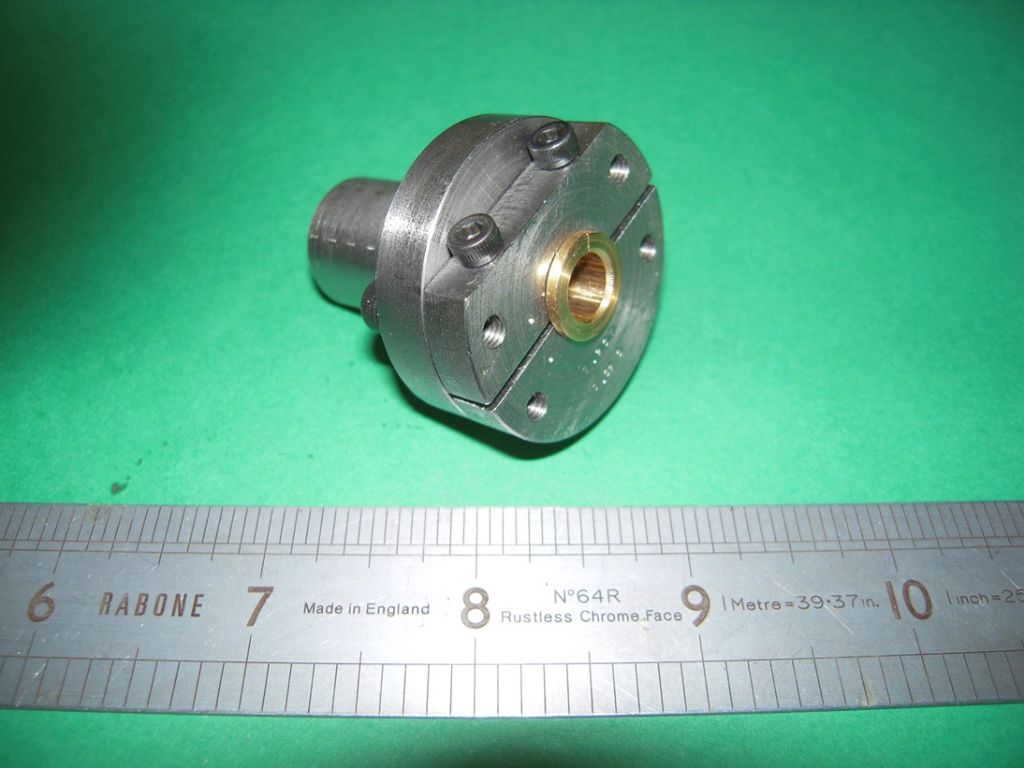

                        JA
                          @ja
                          My attempts at using solder and glues failed so I made a proper fixture to hold the halves. This allowed the ends to be faced in addition to the boring of the bearing.
                          A little bit of thought and accurate machining is required.
                          bearing fixture 1.jpgJA
                          #401688
                          Anonymous
                            Posted by JA on 22/03/2019 12:31:32:
                            Same for me; the solder joint either gave way when machining, or the bearings required a serious amount of heat to melt the solder – not easy. Depending upon the bearing I made a simple jig:
                            Crankshaft Bearings
                            Or made a jig plus the actual bearing housing:
                            Andrew

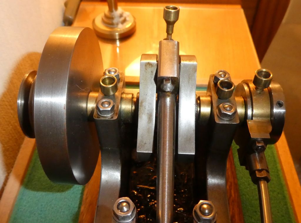

                                  Rik Shaw
                                    @rikshaw
                                    For historical accuracy split brasses are a nice touch but I will make mine differently. I shortly need to make 4x PB journals for the crankshaft on my current Double Tangye in progress. They will be made from solid bar, no splits, no soldering! The feed spigot on the oil cups will stop them rotating.
                                    The only splits found on this model are between the CI standards and journal caps. The completed journals will be slid onto the crankshaft then the standard caps will be fitted holding the crankshaft in position.
                                    Rik
                                    #401801
                                      A lot depends on the layout of the particular engine and crankshaft/pin. With disc cranks and separate pin on the Tangye solid bearings are possible but they won't work if you need one in the middle of a double throw crank or your big end bearing fits between two webs of a solid crank.
                                      What I often do where it is possible to slide the bearings on is to make them as split ones but don't unsolder them, makes it easy when taking the engine apart and reassembling and less chance of mixing things up. The main advantage is if you do get wear or find your fits are a bit slack it you can simply melt them apart at a later date and treat as split ones.
                                      #401814
                                      Rik Shaw
                                        @rikshaw
                                        Quite understand what you are saying Jason and I understand that not all crankshafts are equal. However, and as you point out, the DT design does allow for solid journals. My only other engine also had journals from solid. Maybe I'll try another model in the future with the split variety but until then it will remain a "pleasure" to come.
                                        Rik

                                              You don't actually make it and solder back together. You solder two pieces of bronze together and then ream or bore the hole before melting them apart. two main reasons:
                                              1. A split bearing can be tightened to take up wear.
                                              2. On a typical one piece crankshaft you would never be able to fit the big end bearings if the bearing was solid with a hole in it. No other way to get something like this
                                              To fit around the middle of this

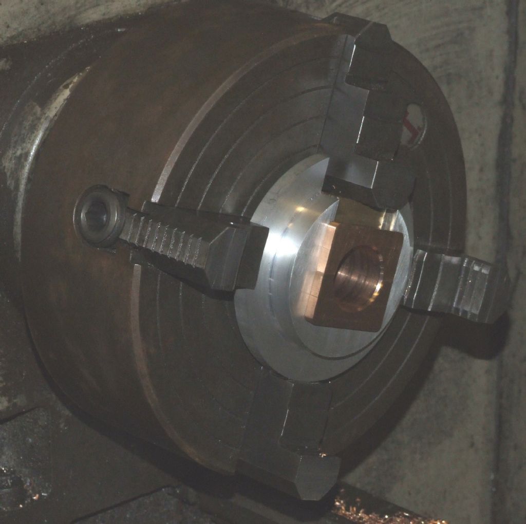

                                                  #402662
                                                  Iain Downs
                                                    @iaindowns78295
                                                    Just to add a little digression to the thread here.
                                                    I've recently made a pair of bearings (cast iron) and split the cube 4 ways and then glued (off the shelf superglue) back together before boring.
                                                    This (as far as I can see has worked well). A modest amount of heat (and a sharp tap) broke them apart and a little alcohol cleaned them up.
                                                    I'll do this again!
