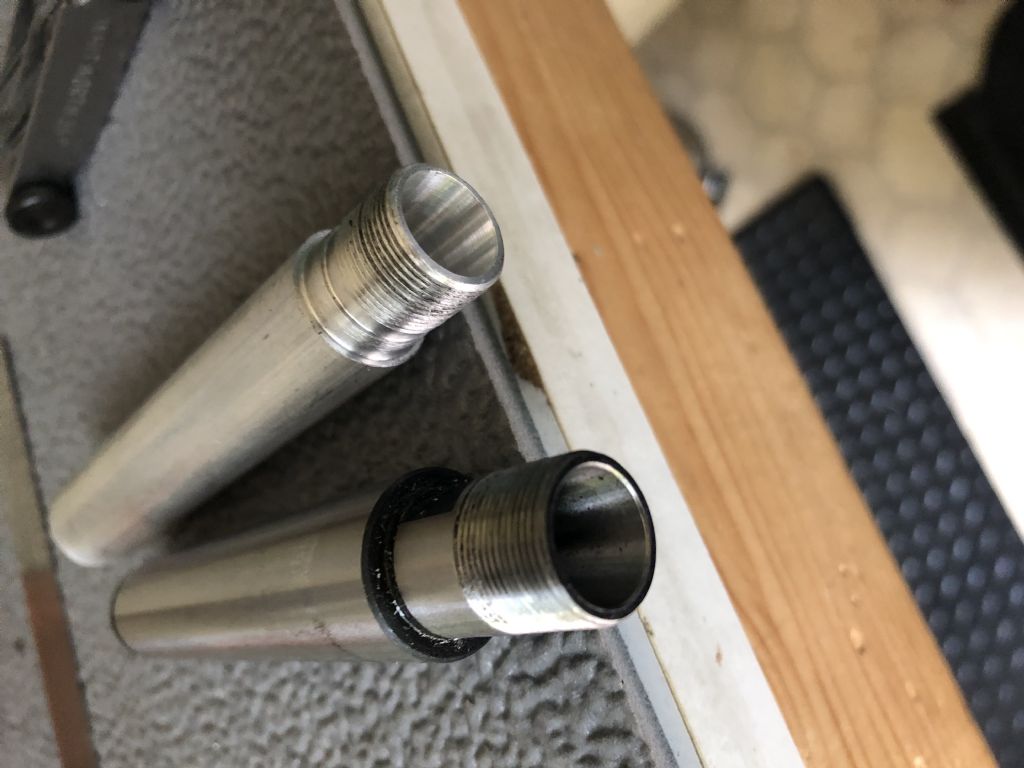

      I am hoping someone on here can help me , I have the soft blank to make an ER11 collet chuck for my Pultra and I am unsure about the internal taper, according to google search the included angle should be 16deg but when I cut the taper in a bit of aluminium using Rocketronics, large end 11mm and 7.5mm small end overall length of 17mm so putting -Z17 and -X1.725 being half the difference between 11 and 7.5 I get 5deg ( so 10deg included) and not 8deg ( 16deg included) what am I doing wrong ?
      I want to get this sorted out before I do it on the proper arbor.img_1953.jpeg

          Posted by Dell on 03/10/2023 18:33:15:
          Assuming 1.725 is a typo for 1.75??
          1.75mm over 17mm is 5.88° by my maths. (tan^-1 (1.75/17) )
          8° would be 2.389mm over 17mm ( tan(8° ) x 17mm ) or 11mm down to 6.22mm diameter.

            Well, according to your diagram the length of the tapered section is not 17mm. The dimension 17mm includes a parallel section. For an 8 degree taper with a difference in diameters of 3.5 mm, the taper length would be 12.452mm. Incidentally, half 3.5 is 1.75, not the 1.725 you show.

              Thanks for replies the 1.725 was a typing error I don’t know how the 2 got in there, will blame it on my age anyway I have just found a calculator online and the taper length should be as Mike said 12.4mm giving a taper degree of 8.033 so that’s where I was going wrong , it just goes to show that it’s worth doing something that we have never done before using a bit of scrap, anyway I will cut another bit of scrap aluminium again tomorrow just to be sure.
