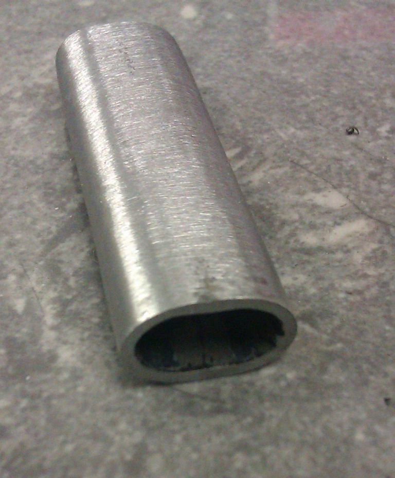

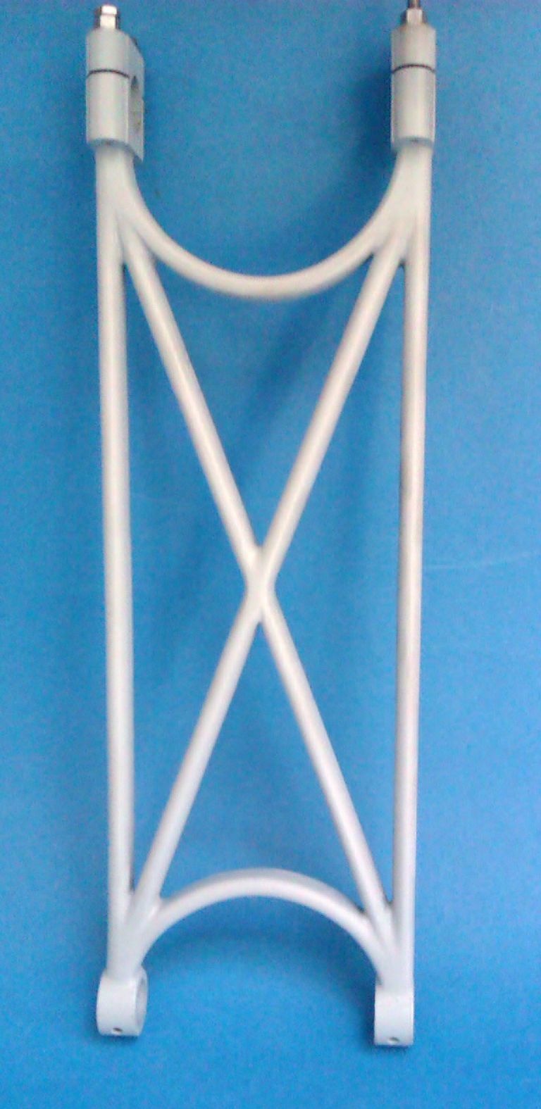

        For my next steam project I intend to make Anthony Mount's Easton & Anderson grasshopper beam engine but at double the size, the X braced frame that supports the end of the beam was originally a casting with eliptical section members.
        Casting a one off is not really an option so I intend to fabricate and thought I would see if anyone had made eliptical section in the past, the size needs to be about 11/16×9/32 (11x7mm). I need 4No 10" lengths, the half circles at the ends will likely be easier turned as a ring. Material steel or brass.
        I have a few ideas as follows
        1. Reprofile some tube either by rolling or pressing, 3/8" dia would be about the right starting point.
        2. Mill using a 1/4" roundover bit to knock the corners off and then blend by hand

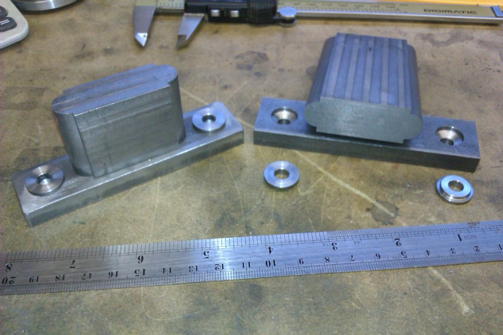

        3. Again on the mill but work out co-ordinates to produce the profile in a number of fine steps like the ARC function on a DRO and then final blending by hand
        4. Buy it in, I have found a company that does what I want and will get a price on Monday but as they deal with race cars its likely to be an exotic cr-mo alloy and not cheap plus I would prefer to do it myself
        So has anyone done something similar and if so how did you go about it?
        Thanks, Jason
        Edited By JasonB on 02/09/2012 18:39:07

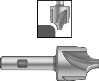

          You could use a corner rounding endmill as shown above to mill each edge of strips of stock. If the stock is passed through the endmill at an angle rather than at 90 degrees, an approximate ellipse will be cut. You will likely need a simple jig or fixture like a mitre box to hold the stock at the correct angle and also support it as each edge is cut. Three corners will need a shoe or screw adjuster to support and centre the stock for the last edge cut. A window for the endmill in two sides will be needed.
          In the prototype shop of the first large firm I worked for in industry the proto shop foreman devised this method and I cut a lot of strips in the fixture he built – we were making a casting pattern and needed elliptical and semi elliptical sections (over 30 years ago now, but I have always thought the corner rounding endmill and angled stock was a smart idea on the foreman's part.

              You can now buy corner rounding insert cutters a well, you could also water jet cut the frame as one and then make the elliptical section by way of machining/filing.

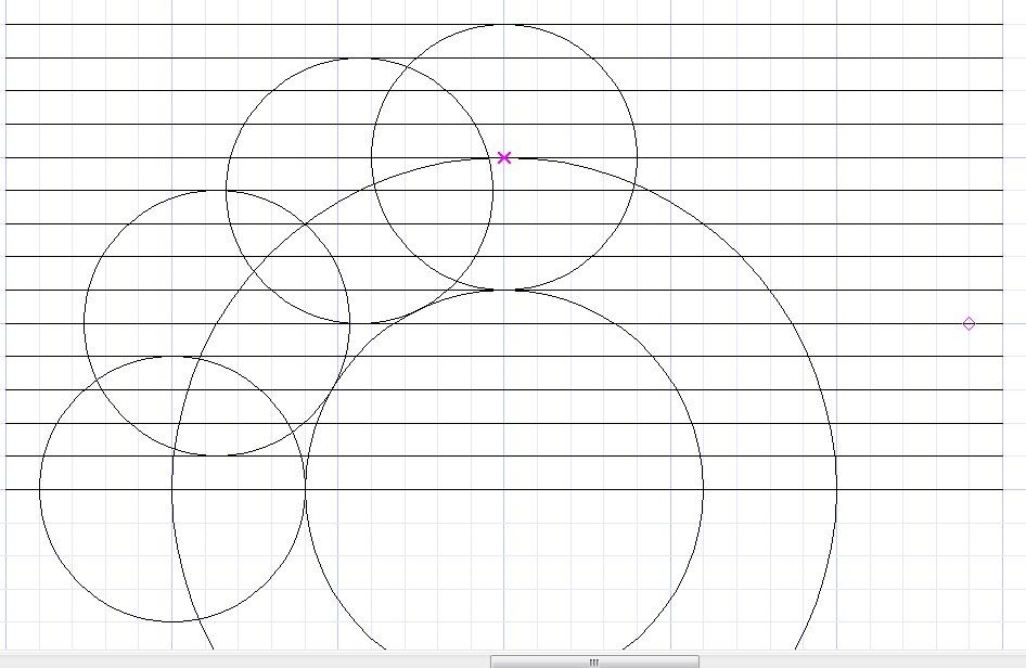

                    #97655
                    David Clark 13
                      @davidclark13
                      Hi There
                      Draw the section in cad.
                      Draw the section in cad say 4mm larger.
                      Draw horizontal lines 1/2 mm apart. Use the point where the horizontal lines cross the larger profile as the co-ordinates. Then use an 8mm ball nose cutter at each co-ordinate except the Z should be 4mm lower to allow for 1/2 the ball. Run along the bar, backwards and forwards will do, you are not taking a big enough cut to worry about climb milling. Turn the job over and do the other side.
                      regards David
                      The profile below is round but illustrates the point.
                      Part of the ball profile is always in contact with the profile.
                      The horizontal lines are 1mm apart but if I had drawn them at 1/2 mm it would have been to cluttered. You can also use this method in 3 D but it don't half take a long time to program it. Imagine a half round cylinder with another cylinder sticking out of it upright at right angles. Took me a couple of days but very enjoyable challenge.
                      Edited By David Clark 1 on 02/09/2012 20:35:25
                      Edited By David Clark 1 on 02/09/2012 20:39:44
                      #97657
                        David thats what I was describing in item 3.
                        "3. Again on the mill but work out co-ordinates to produce the profile in a number of fine steps like the ARC function on a DRO and then final blending by hand"
                        J
                        Edited By JasonB on 02/09/2012 20:35:18
                        #97659
                        David Clark 13
                          @davidclark13
                          Yes but most people won't understand hence the drawing.
                          regards David

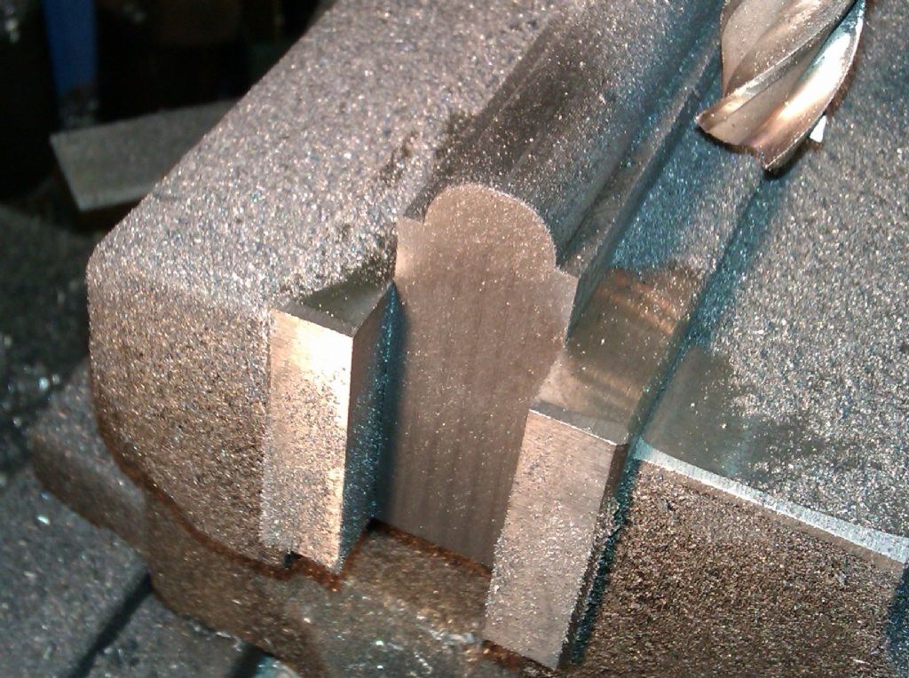

                          #98325
                            Just an update, I have decided not to buy in eliptical tube so will be making the section myself.
                            I will still try the press/roll method but having just done the bearing supports using the co-ordinate method I think that will be the route I will go down.
                            These couple of shots will give an idea of whats obtainable just using the DRO to calculate a half circle, the elipse will need working out in CAD. and I will use a rounded corner milling cutter so the steps can be a bit bigger as it takes a while to work round a 1/2" dia in 0.010" steps!!
                            J

                                    #100523
                                      Just a quick update.
                                      Thanks to Maurice I now have some photos of the original engine and it looks like the part is more oval than eliptical which makes things a bit easier. I was in B&Q the other day and picked up a length of their 10mm x 1.0mm ERW tube to have a play with.
                                      After a few tests the best results were after annealing the tube to press it in the vice with a 9/32" drill in the jaws to give a constant to tighten down to, does not look too bad after a quick clean up.
                                      It does come out of the vice with a slight dip in the middle of the flat section like a slight figure eight but a sanding disk soon blends it out.
                                      There are some of the other parts that I have done on this engine in this thread
                                      J

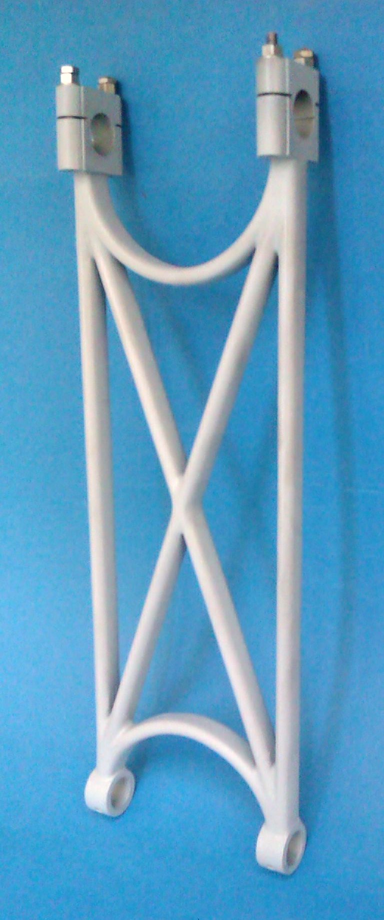

                                      #105270
                                        Well finally got this part of the engine finished. I made the four main parts out of the squashed tube shown above and the two half round pieces were machined from flat bar and then bent to shape. Used a bit of 5" PFC as a jig to keep things all in place while it was silver soldered, and it cleaned up quite well if I say so myself, click for larger images.
                                        J

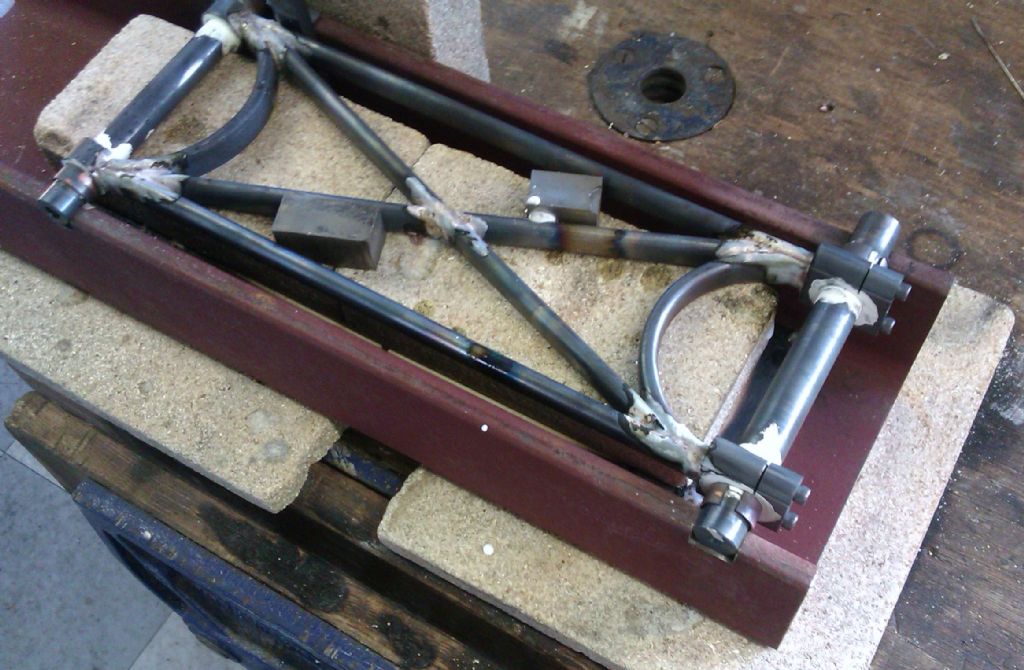

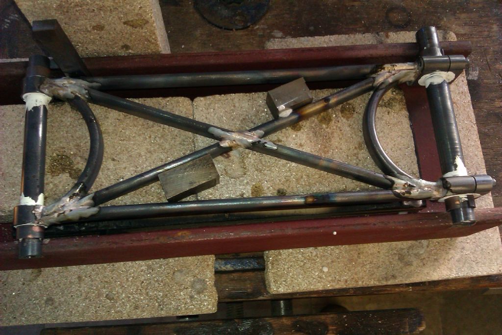

                                            Terryd
                                              @terryd72465
                                              Hi Jason,
                                              great work as usual, how did you manage to hold such a complex structure togather while brazing? I love your techniques shown in your postings on the other forum,
                                              Best regards
                                              Terry
                                              #105348
                                              Bernard Laycock 1
                                                @bernardlaycock1
                                                I was interested to see that it might be possible to turn the oval bolting flanges on glands. At the moment I do it by using small and large filing buttons and would be fascinated if someone could explain to me how they can be turned.
                                                Bernard
                                                #105349
                                                  You will just have to wait until I get round to describing how that part was made over on MEMsmile p
                                                  What you can't easily see in the above two pictures is that I notched out the channel to take two rods
                                                  The split top bearing housing was clamped to one rod and the bottom "rings" held with grub screws to the other, some pieces of scrap copper tube were also used to stop things moving sideways.
                                                  The bearing housings also had small spigots machined onto them which located into the straight side tubes and some pins were added to do the same at the other end.
                                                  The other parts were all carefully scribed to the side rods which kept them quite well located and I just needed the two blocks of metal to hold the short diagonal pieces in place. To stop everything dropping the two firebricks were packed up so they supported all the parts.
                                                  It would have been nice to fillet braze all teh parts but not having oxy I opted for silversolder and a wipe of JB weld just to blend things together.
                                                  J
