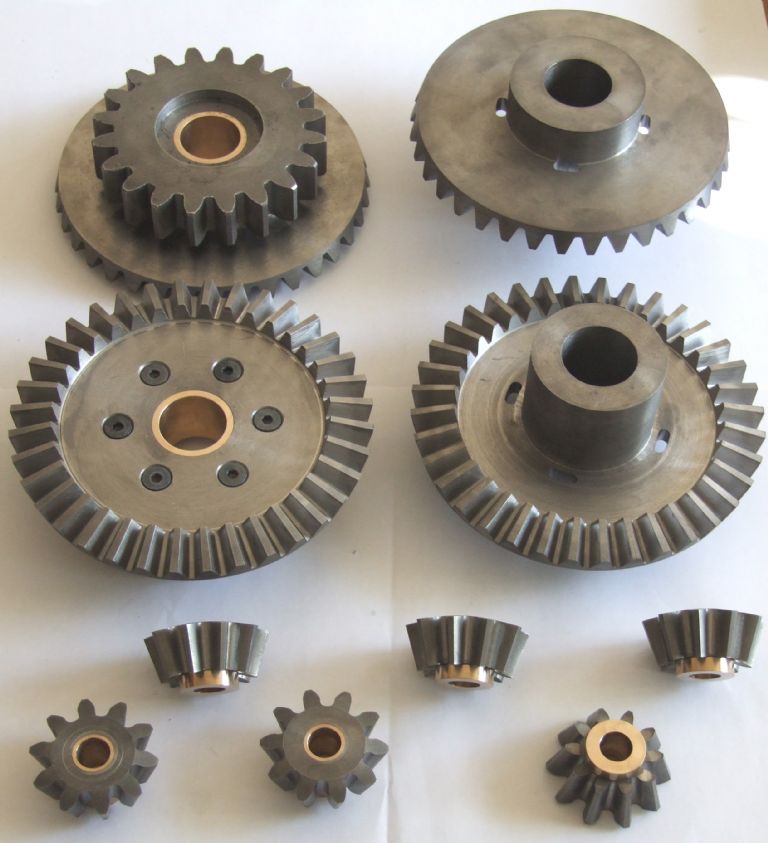

                  That's about right for the equivalent tooth numbers. For these bevel gears:
                  Cast Iron Gears
                  the equivalent number for the 10 tooth pinion was 10.3, while for the 36 tooth gear it was 134. If you look at the tooth profile for the gear it is almost straight sided, like a rack.
                  Andrew
