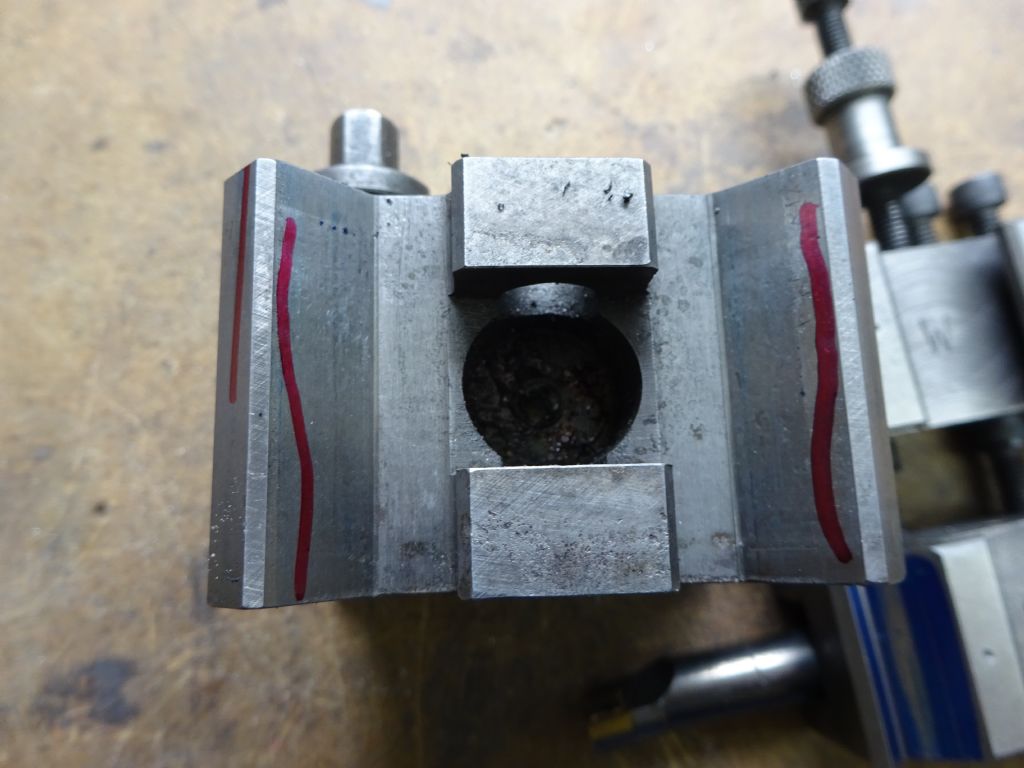

      As a first involved project in the new horizontal mill I wanted to make a toolpost, first a small practice one for the mini lathe then a larger one for the keighley. The horizontal mill suits making the profile in a dickson much better than it makes dovetails like most home made QCTPs.
      Just need to check one thing first since its been a while since I used a dickson and I didn't properly pay attention to it.
      Does the toolholder seat on 4 faces (top pic) or two faces (bottom pic where there is clearance on the outside face).
      I would imagine 4 faces would over constrain the part, but then why both with the extra angles?

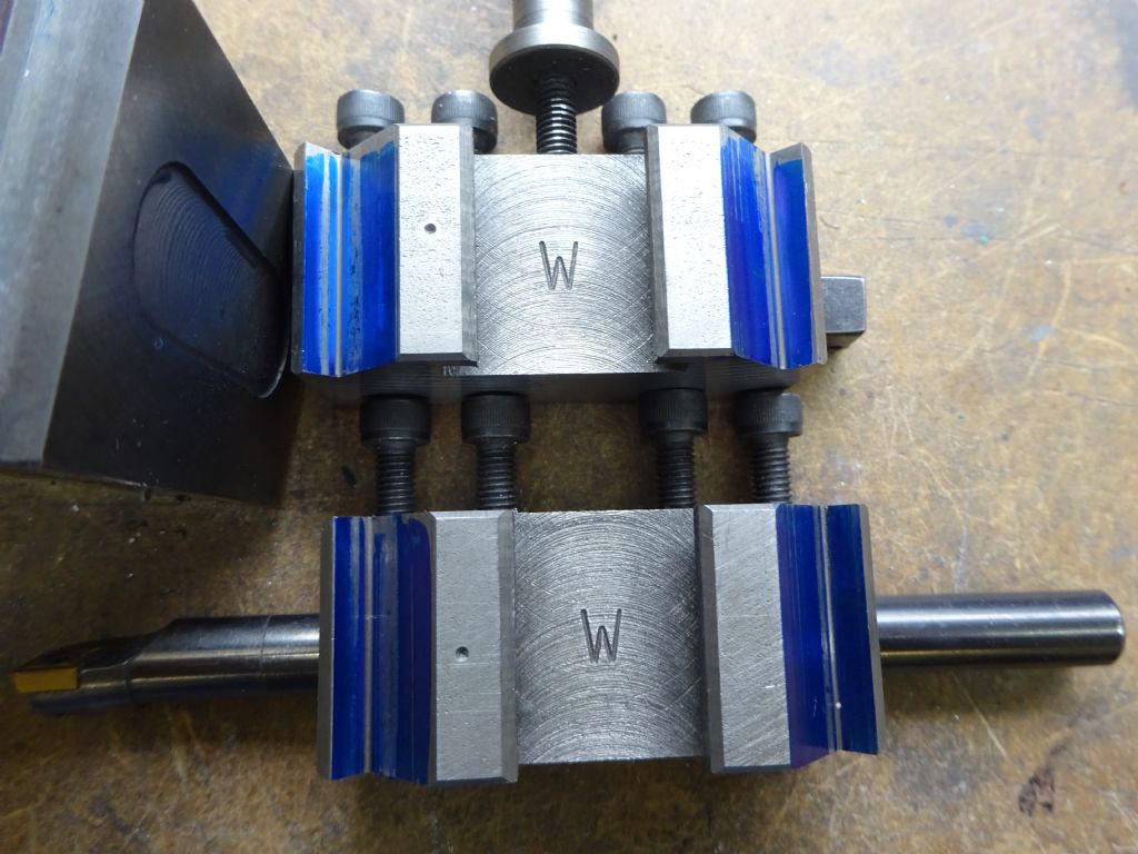

                I think if I blued them then they would show mating surfaces, as rainbows says why go to the effort of machining the return ends if they were not intended to touch.
                As you say it may not be critical for hobby machine loadings.

                            A rough and ready swipe with a marker and a bit of rubbing shows that my genuine holders make most contact at the ends of the inner faces.
                            This is marked in red on the post but there is a faint hint of blue on the rest of the surface and also the outer ones. Must stone down those 3 marks top left as they seem to leave a scratch in the blue.
