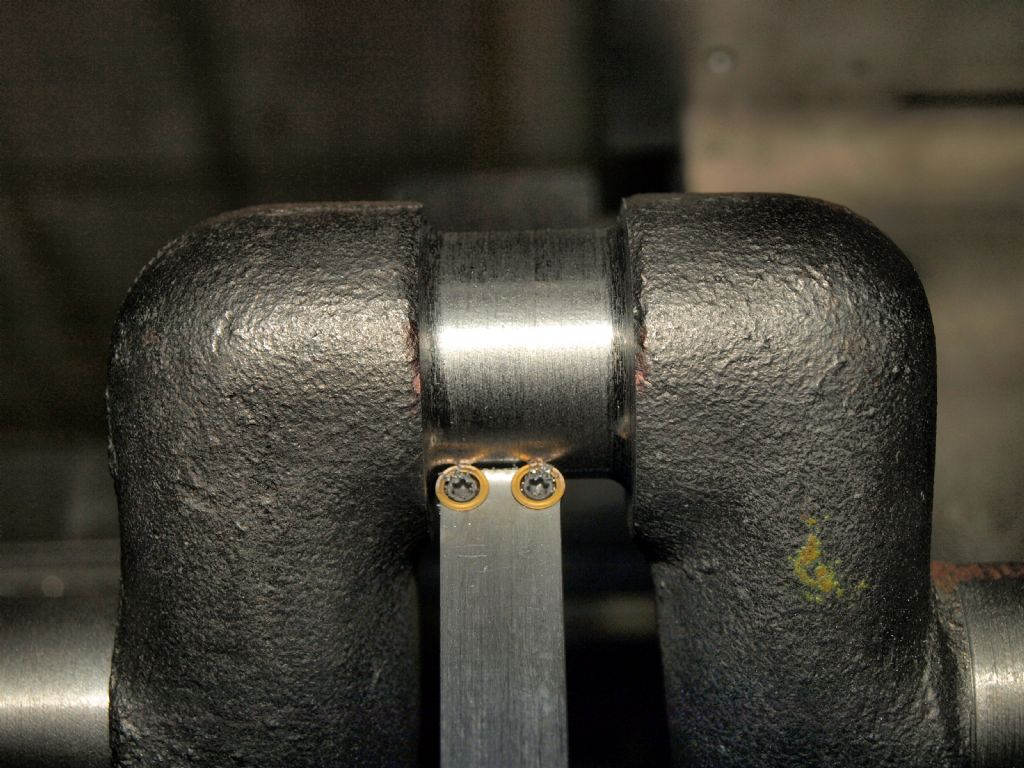

                    Jason has asked me to post this photo of the crank journal tool using round inserts. Setting is straight forward as a ground tool, if it needs sharpening, just rotate the inserts!
                    I hope you find it interesting

                    JOHN BRIDGE 1
                      @johnbridge1
                      Thanks Kwil, It looks like a very useful tool if I ever get to do anything useful with this lathe of mine.

                          Wow Kwil, either those are very diddy inserts or that’s a meaty crankshaft 3 or 4″ Traction engine?
                          I like the idea of grinding crankshaft journals. A set up using my rotary table on my grinder appeals, but I’d need a different shape wheel. With a diamond wheel a mirror finish could be assured.

                            Neil,
                            They are 5mm diameter and it is a 4″ Traction engine, throw is 1.5″. The crankshaft was left +0.0005″ for grinding/lapping.
