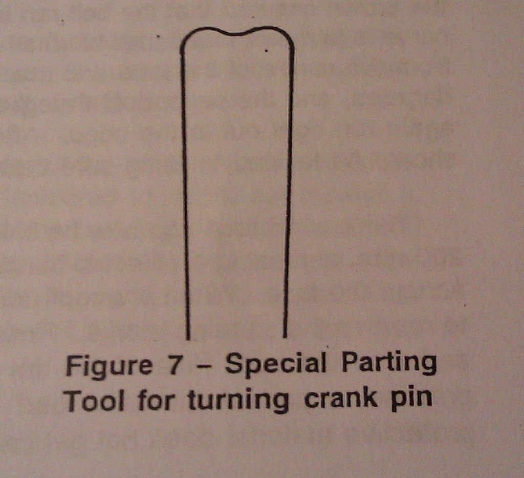

              Yes something like a parting tool with the outer corners radiused and the middle of the cutting edge hollowed out to reduce the amount of chatter.

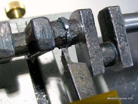

                      Thanks for all your help the pic shows what I am trying to do, I have done the bit shown and removed the part where the two halves where joined together. I now want to machine the this part of the shaft to the correct diameter but cannot see how to do it with the tool shown. It seems the tool has not enough sideways movement before contacting the webs.
                      #83992
                      JOHN BRIDGE 1
                        @johnbridge1
                        Hi John, Sorry I? did not read your post before I posted my pic. your referance to the parting tool is what I am after, I do realise the importance of getting the shaft spot on.

                            Apart for the general problem of machining a crankshaft, you are also up against a possible specific problem here with the actual part that Stuarts supplied. As can be seen in your picture, the crankshaft supplied is actually two forgings which have been welded together in the middle with the throws at right angles. The problem that I had with this with a Stuart Double Ten was that the weld material was harder than high speed steel, and even carbide did not seem happy trying to cut it. So what I did in that case was put the Stuart one aside and make another from a big piece of free cutting bar. Yours may not have this problem…mine was too old for me to consider returning it to Stuarts, someone had had the set of castings for years.
                            Another point is that the parting tool you show does not have enough reach. Rather than being a piece of square HSS with the parting too ground on the end, it wants to be a blade type of parting tool, so that you can extend the tool far enough to reach into the journal and be able to traverse across without fouling on the webs at either side. It also wants to be very narrow, eg 3/32 rather than 1/8. I also grind a little V down the tip for this job, so that the corners do most of the cutting.
                            Next, a crankshaft like this is very springy, and the pressure from the centres is trying to collapse it. So you want to provide support at the webs where you are not machining, eg in this case at the crank throws. A good way to do this is to clean up the web a little with a file and put a short bolt through with a washer on each side. need a picture for this really…the bolt will be in the gap where the shaft is interrupted so that it can help take the endload from the centres.
                            Finally, the way I do crankshafts like this is to do as much roughing out as possible between centres in the mill. To do this you need a vertical mill (of course) plus some way of supporting the job between centres on the mill. I have a Vertex dividing head and tailstock now, which is ideal, but I have done small shafts on the Unimat 3 using the milling attachment. Using a slot drill, long series if necessary, you can rough out most of the material without the cutting loads being anything like as high as they will be with turning. You still need to finish the journals in the lathe as the milling will not give a wonderful finish. (Grinding would be nice but I am not set up for that!) I did an article on this back when I used to write for Model Engineer, you would be welcome to a copy.

                                  John Olson, Hi John Thanks for your reply, the picture is not of my crankshaft but it is the same as mine and the tool I am using is narrower but I am still having problems, my casting kit was bought by a dear friend in 1975 he is no longer with us so I would not have much success at getting it replaced I think, I would like a copy of your article please.

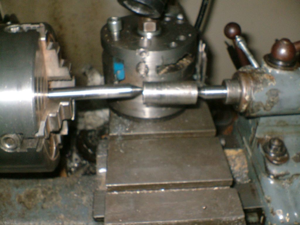

                                          I actually had a go at a small 4way crankshaft in steel tonight…what a nightmare on a lathe.
                                          ding ding ding…na…there’s got to be a better system.
                                          I’m going to have a go on a shaper, with a strong dividing head system via my vice, a baby crankshaft is small enough to fit into it.
                                          …an intruiging problem.
                                          With teeny stuff there would be problems presenting the grinding wheel into the crankpin and maintaining good stiffness for either the crank or the grinding wheel…you can’t scale nature…
                                          So maybe an hour or so with a diamond grit file to clear the rough crankpin bits, then a final cut with a decent parting tool on the lathe would be a better idea…it’s not like you’re doing a lot of them, you’re just finishing one off.
                                          Or invest in a carbide parting tool, and use gentle cuts.
                                          Carbide would probbly solve all your problems, it’s amazing stuff, and you would find other uses for it whenever hss struggles.

                                              Take most of the material away with left & right hand tools then as I said above grind up an Eclipse type parting blade as the pic below.
                                              This gives radiused corners for strength and the hollow on teh front reduces chatter, work the tool from side to side with very light cuts. May need a bit of stoning to get both sides cutting the same.
                                              I visited one of our other members last week and he showed me a tool he had made to turn the crank for a 4″ traction engine. It was a hefty lump of 1.5″ x 0.5″ bar on edge and in each corner he had mounted two small circular replacable carbide inserts which act just like the tool above but massivelty rigid.
                                              J

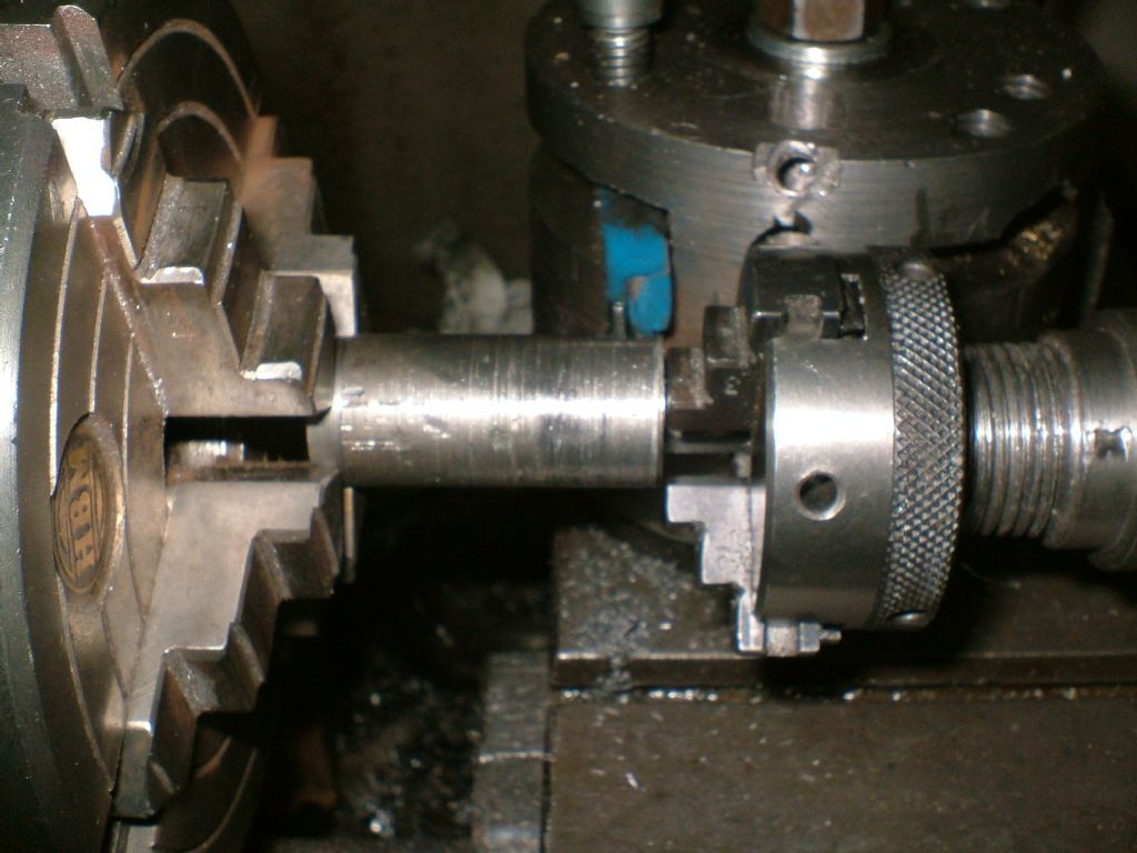

                                                    The other problem is stiffness between the centres, you need to squash the workpiece between centres, which becomes a big issue as you hog out more material.
                                                    Perhaps holding the workpiece between two four jaw chucks would be better, certainly it would be less stressful
                                                    If you only move a single jaw on the 4 jaw when revolving the workpiece for the next offset crankpin, so you reposition the WORKPIECE, and don’t move 3 jaws, then you will get…well moderate concentricity
                                                    The original setup between 4 jaws will need some dial indicator work.
                                                    I made a revolving centre for my chucks to fit on the tailstock(great for hogging down wonky bars of metal), a smaller one would be more sensible, you can see the general thinking.
                                                    Thats a three jaw in the tailstock example, obviously I would use a good small 4 jaw…if I could afford one.
                                                    So with a good quality revolving centre in the tailstock you have stiffness and security, but very little crushing force on the workpiece.
                                                    Final high accuracy finishing work with light cuts and a carbide quality parting tool can still be done between the centres

                                                      For positioning the workpiece a centre which protudes only slightly from the middle of the 4 jaw body would make setting and resetting the job miles easier.
                                                      This photo is obviously not what I mean, each 4 jaw would have a specially made centre where the workpiece could be positioned easily between these centres, and then the 4 jaw chuck jaws secure the workpiece in position
                                                      Saves messing about checking stuff once the initial work for the holes for the offset centres have been done.
                                                      To get the holes set accurately at each end I would do one end, then make a template of the first end, which I would transfer to the other end for marking out.
                                                      That would be pretty fiddly and need some thought though…The holes at the opposite ends really do need to be spot on.
                                                      Maybe better men than me could help out here, since these holes are quite critical for accuracy and a good crankshaft
                                                      Sooo
                                                      Set your holes up properly
                                                      hog out most of the material with a small milling cutter
                                                      finish off with a good parting tool
                                                      Seems to be the easiest system for an amateur
