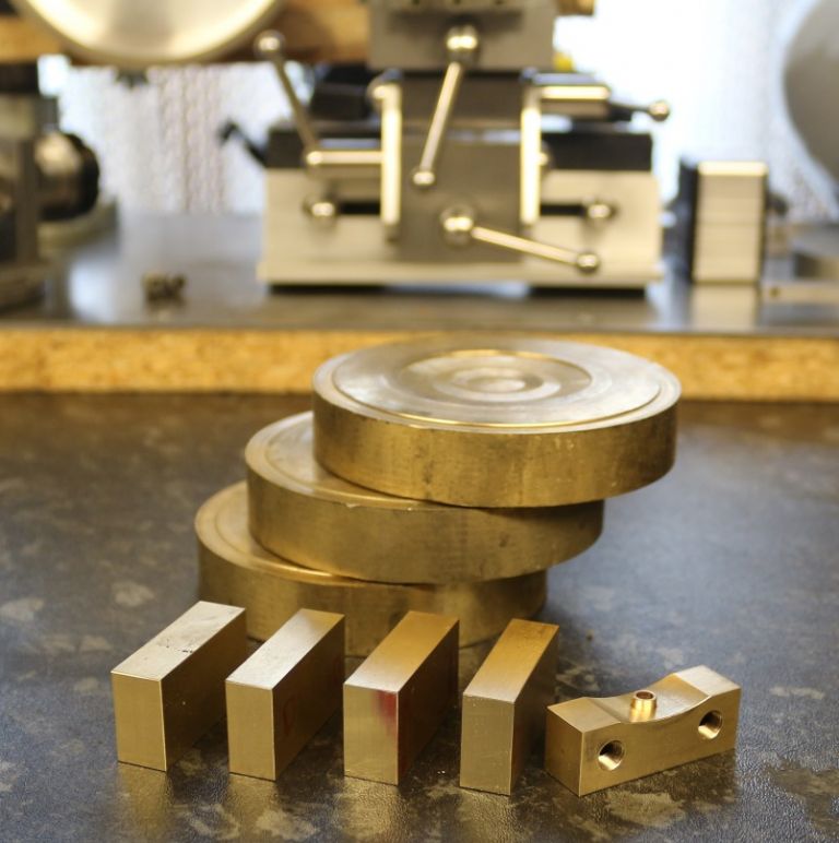

                                  Just reporting my machining of the Aluminium Bronze casting.
                                  Boulton and Watt bellcrank engine
                                  The six holes are tapped 6BA. After locating the holes positions with a centre drill a drill with its rake relieved for drilling brass was used. The material was uniformly hard without a really hard skin. However there was a hint of work hardening when drilling. Tapping was done with a thread cutting paste. The actual tapping was easy but the material grabbed the tap making extraction difficult. Fortunately I did not break any taps but a tapping guide was an absolute necessity during extraction.
                                  All the turning was done using a couple of HSS left hand knife tools with minimal top rake. The cutting speed was about 110 ft/min and all the cuts were light with slow feeds. The use, or not, of a cutting lubricant made not difference. The main problem was the build up of swarf when machining the inside diameter. The metal came off as a fine nice curly ribbon (just like the text book). The intermittent cut over the bosses did not pose a problem.
                                  I consider the work a success with a good surface finish. The profile of the bosses will be finished by file.
                                  Many thanks for the advice.
