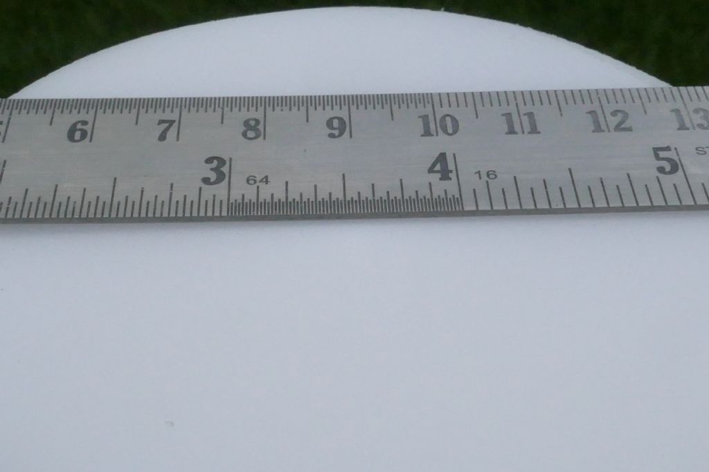

                          I needed to square off a piece of 4" diameter nylon bar stock so I set it up for fly cutting and videoed it for an example on machining plastic. It is similar to acetal for machining purposes.
                          The tool is a 6mm button insert held in a fly cutter. It was set out as far as I could go and still have 2 screws holding it so it is a little over 100mm diameter. This left a little to be removed from the front and back edges but this is an area that will be machined off later so not a problem. RPM is 140, depth of cut is 0.5mm and feed rate is 50mm/min (0.357mm chip load).
                          The photo below is the finished face, the ruler is there for something to focus on for the autofocus.
