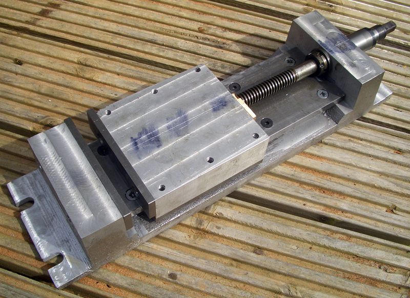

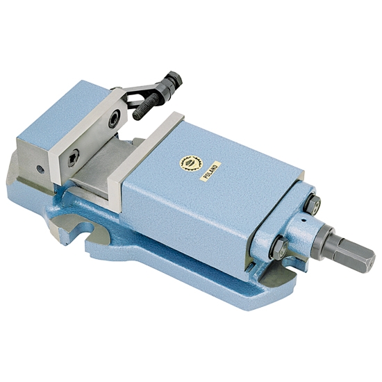

              Wouldn't contemplate anything else but this one.

                Interesting Warco vice – had a look at the patent – no downward clamping mentioned?
                Assuming you have one Niloch, any problems observed with the workpiece rising as the final tightening takes place?

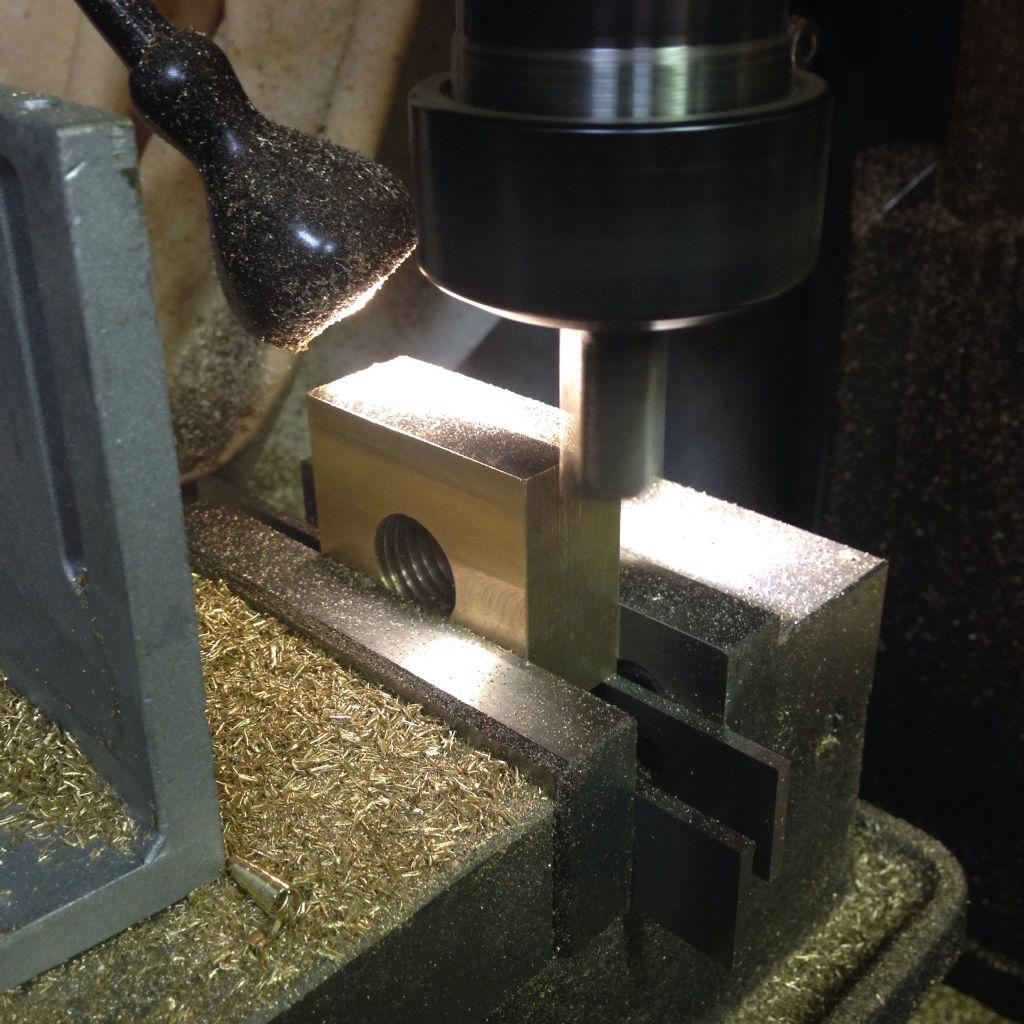

                    image.jpgI bought a vertex swivel base mounted one, after having a poor quality Chinese one. My work accuracy in improved no end.
                    They are a bit chunky when fitted with a swivel base, and sometimes I wonder why I opted for the swivel, but hey we live and learn!

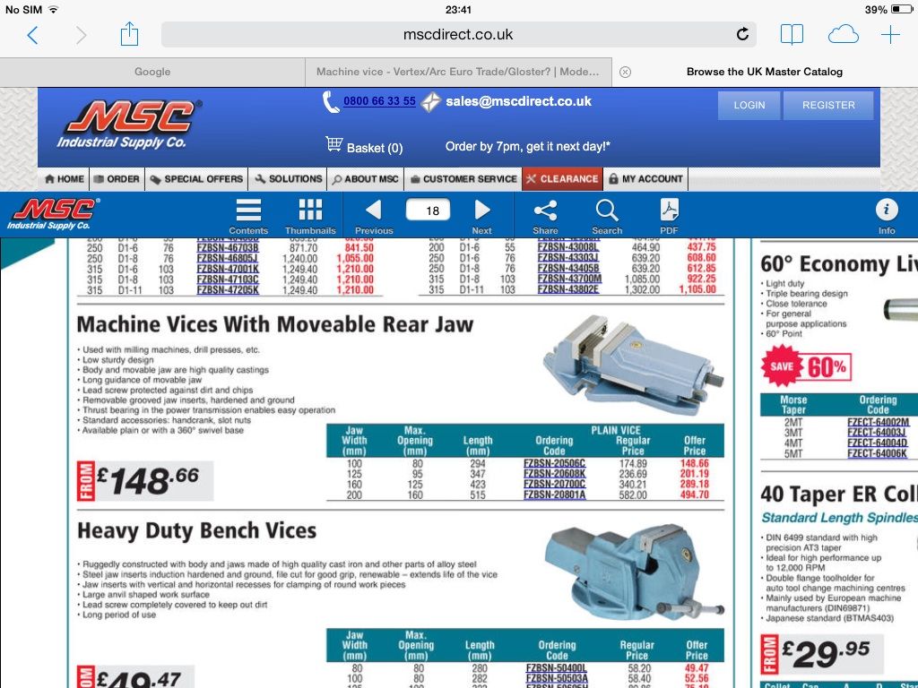

                                        These are ok, brought mine from MSC, no connection..
