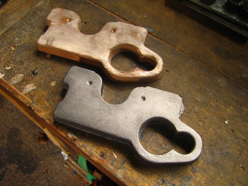

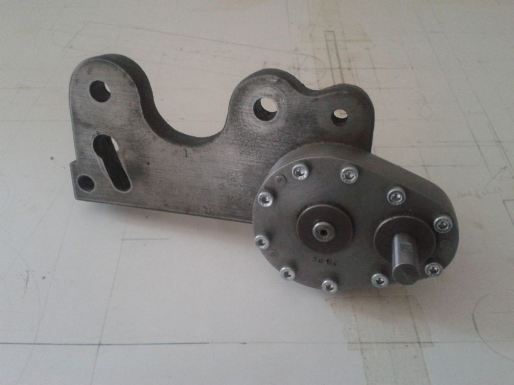

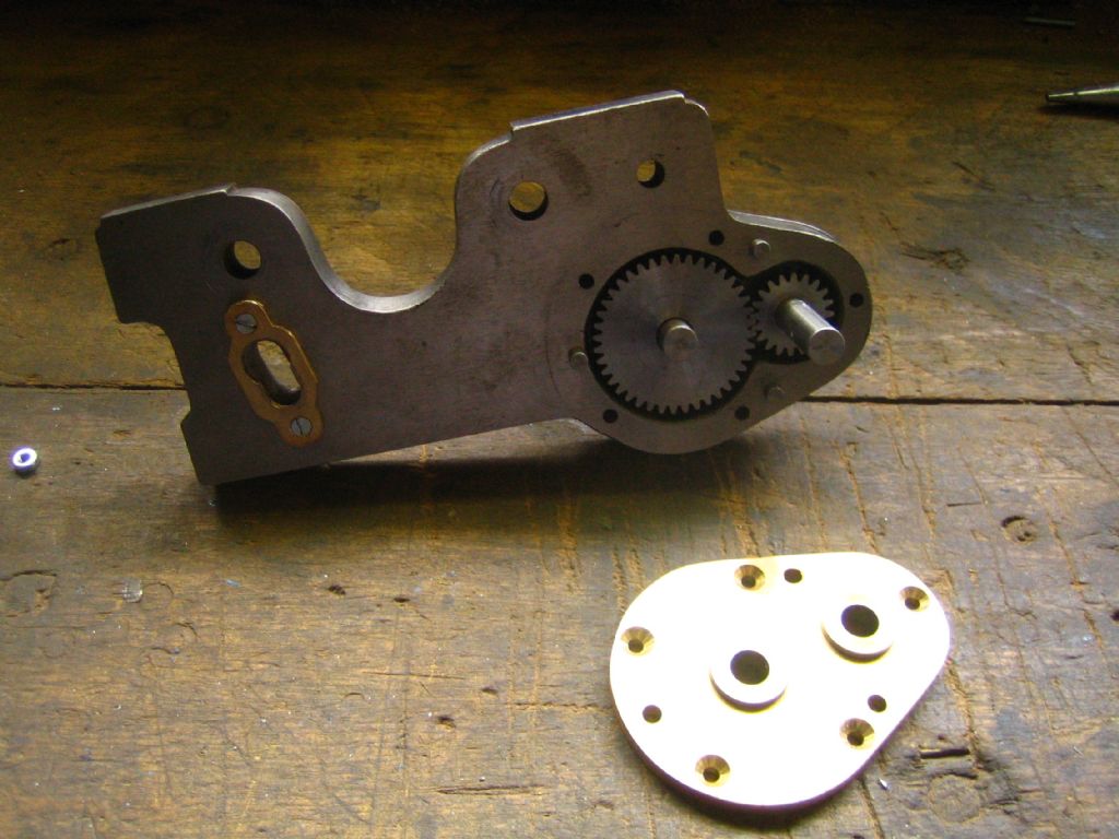

                      geoff walker 1
                        @geoffwalker1
                        Hi Ian,
                        Picture below of the mew issue 234 conversion.
                        If you have a go, don't buy the gears from Muffets like I did, very expensive. Use either Boxford or Myford change wheels and modify them, i.e. change the hole size by bushing the existing hole. Lot cheaper way.
                        I also made a pattern and had a complete new apron cast for the myford, lot of work but neat with the gears enclosed inside.
                        Geoff
