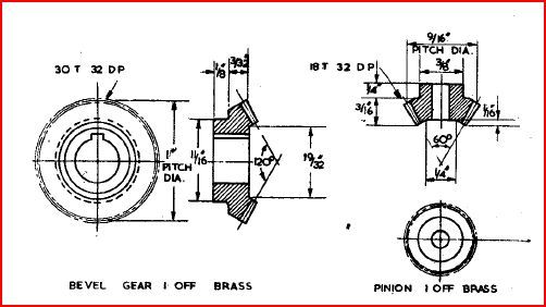

      Reeves governor gears are £52 for the pair.
      I only need the lower one so would appreciate knowing if anybody could recommend where I could get one machined please?
      Thanks.
      Stuart

              Can you post what the gear spec is eg No of teeth, DP, etc
              Individuals from HPC start at about £20 but would need to know size

                From the model engineer article i need the smaller of the two, the pinion gear that goes on the bottom of the governor shaft.
                Hopefully this will help — 18t, 32dp. and 9/16 pitch diameter. It specifies brass in the article, but the bevel gear already fitted is steel. The lady at reeves said they supplied steel ones.
                I will see if I can attach a picture
                Stuart

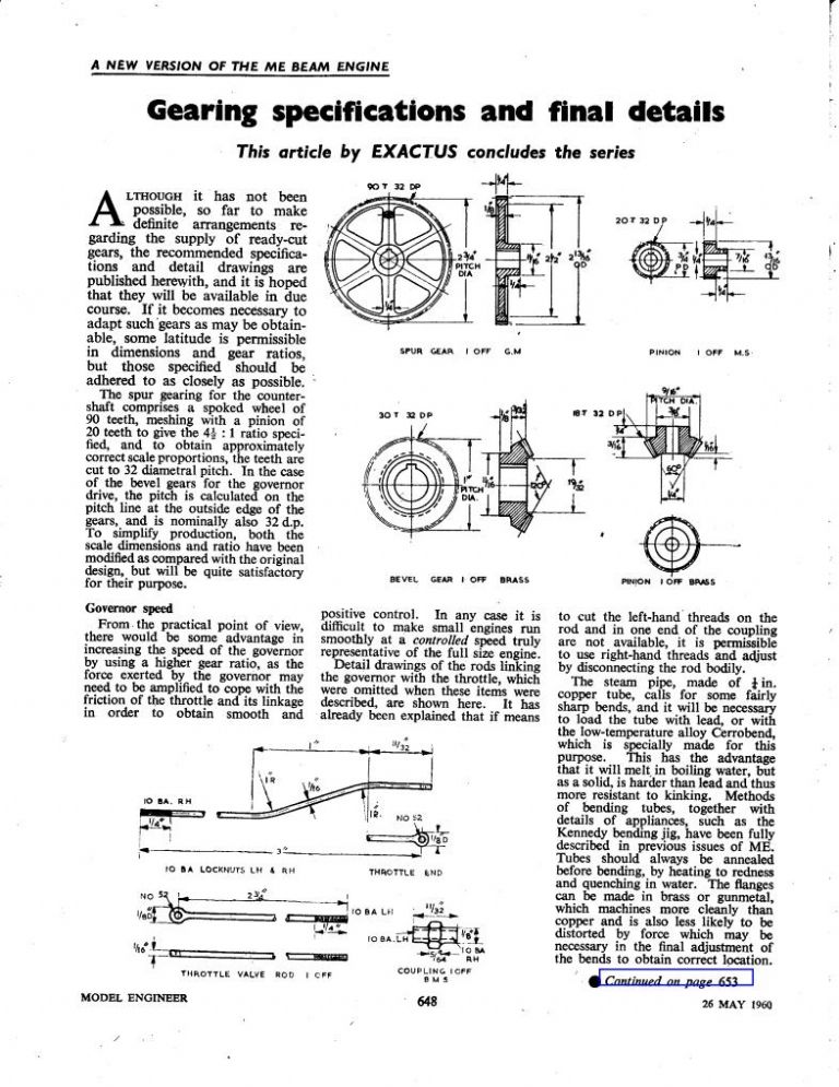

                  The drawing of the gears is shown on page 643 in the 25th may 1960 model engineer book.
                  I think this may be volume 122, issue 3072
                  Edited By Stuart Rogers on 26/02/2015 14:16:56

                      Its a bit of an odd ratio so unlikely to be found off the self after all but you may be able to get away with a 2:1 set.

                        So now wondering if best to pay the Reeves price, and it may be just as expensive to get the small one cut ?

                          Anyone know which issue of model engineer vol121 the construction series started?
                          Just got the castings and would like to have the artical.
                          #198536
                          c
                            @c
                            3038
                            #198541

                                  The exact ratio is unimportant, as long as it steps up the governor speed by about 1 1/2 times.
                                  Slightly off-topic, but Tubal Cain specifies bevels for Lady Stephanie, hidden away under the entablature. The drive to these is a belt. You can easily avoid the need for the gears just by adding a couple of loose pullies to turn the belt 90 degrees, all hidden and (1) a 'real' beam engine would have had the governor drive more accessible and (2) the gears are hopelessly over-scale anyway.
                                  I suspect he had the gears and was determined to find a use for them!

                                                    Just found another apparent error in the plans, the connecting links for the valve gear are shown as 2 -15/64ths on the plan whilst the original ME article shows 2-7/8ths which seems to be the correct measurment from the center of the bearings to the valve crosshead.
                                                    #232263
                                                    Ian Hewson
                                                      @ianhewson99641
                                                      Just found another misprint on the plans, the bevel gears for the govenor shows a 1/4 inch neck on the pinion gear which should be around 1/16 inch and no method of fixing to the driven shaft is given.
