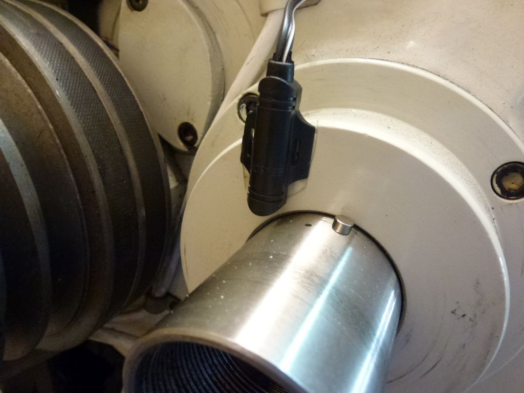

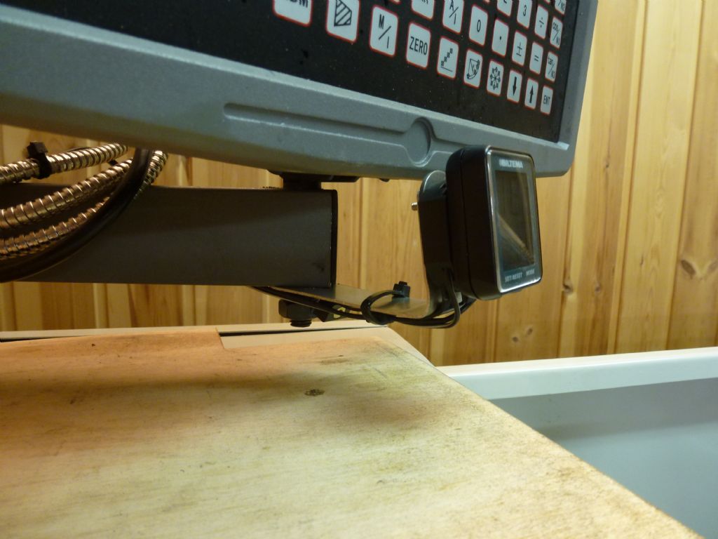

      I really liked the article “Inexpensive rev counter” by Michael Cox in MEW No.178, so I bought a Bicycle computer for about £9 and mounted it under the DRO of my lathe with a simple aluminum bracket.

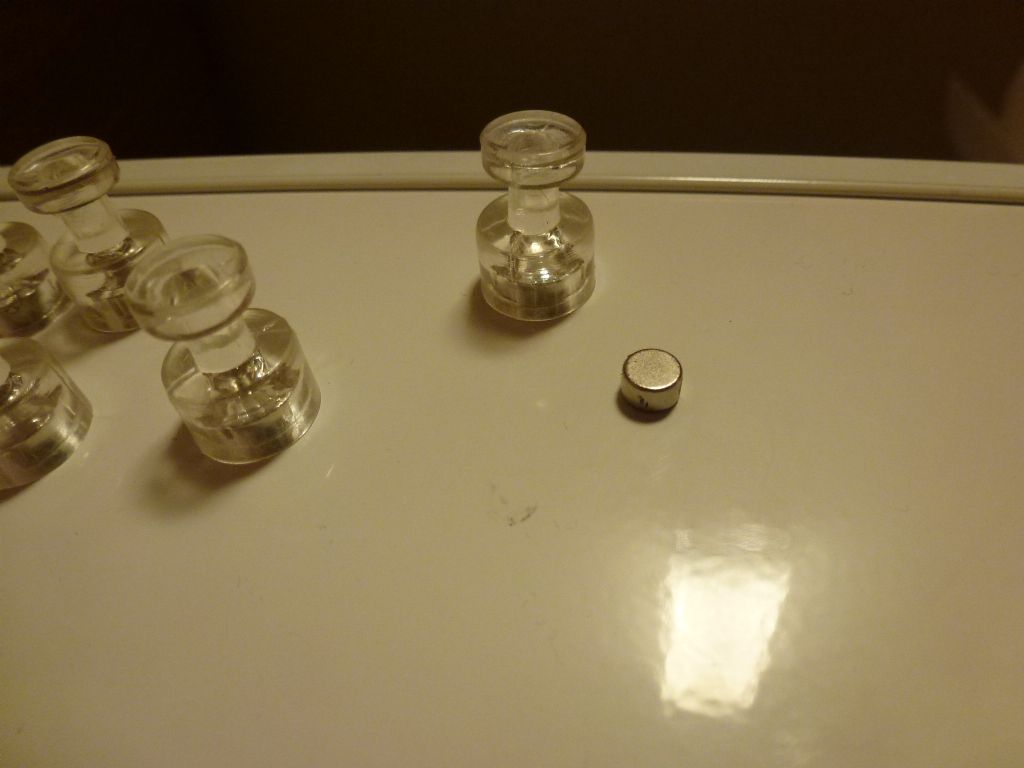

      I then destroyed a “fridge magnet” to get the “magnet”. A small, very powerful one. I payed about £1.50 for 10 of them.
      I then put the magnet on the back part of the spindle of the lathe. Experiments showed it would stay there with it’s own force, whatever revs I tried. The sensor was fastened with double-sided tape after some cleaning.

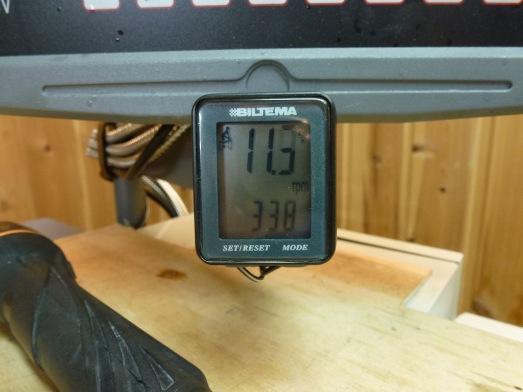

      This worked great! And for a short while I was very satisfied. Looking at the display though, I felt that most of it was giving no information.
      After all, the RPM was some small digits in the lower part of the display, while the speed in km/h was displayed wit large digits in the upper part.
      After some thought, I realized that setting the wheel diameter to 7 inches, the speed display in km/h would be almost exactly (a few % error) the cutting speed for a diameter of 10mm or 1cm. This would be a very quick Cutting speed calculation method. I find it really useful. 2cm -> twice the display….
      For imperial guys, a setting of 27 inches for the wheel diameter will give app. the speed in feet / minute for HALF an inch turning diameter. (You cant set the wheel diameter to 54 on my bike computer. Maybe there are just a few velocipedes around these days)
      Now the whole display gives meaningful information!

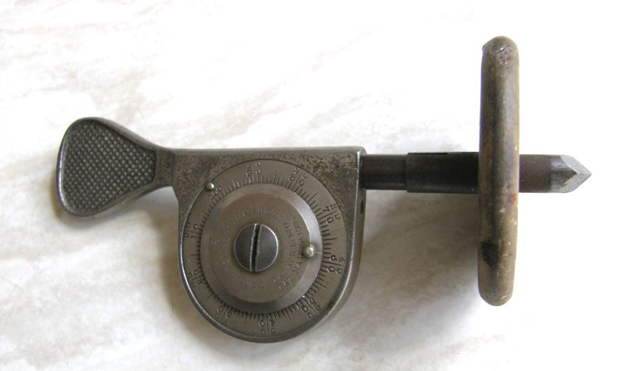

                  I understand that there are speed counters available to hold in your hand, with a special tap put on the mandrill of the lathe, you can read off the speed of rotation, would any one know where I may purchase one. I am a wood turner, but I have an electronic variable speed motor with a inverter, ,also the facility to change the drive belt to the mandrill, this is why I would like to know the speed it is going at any time
