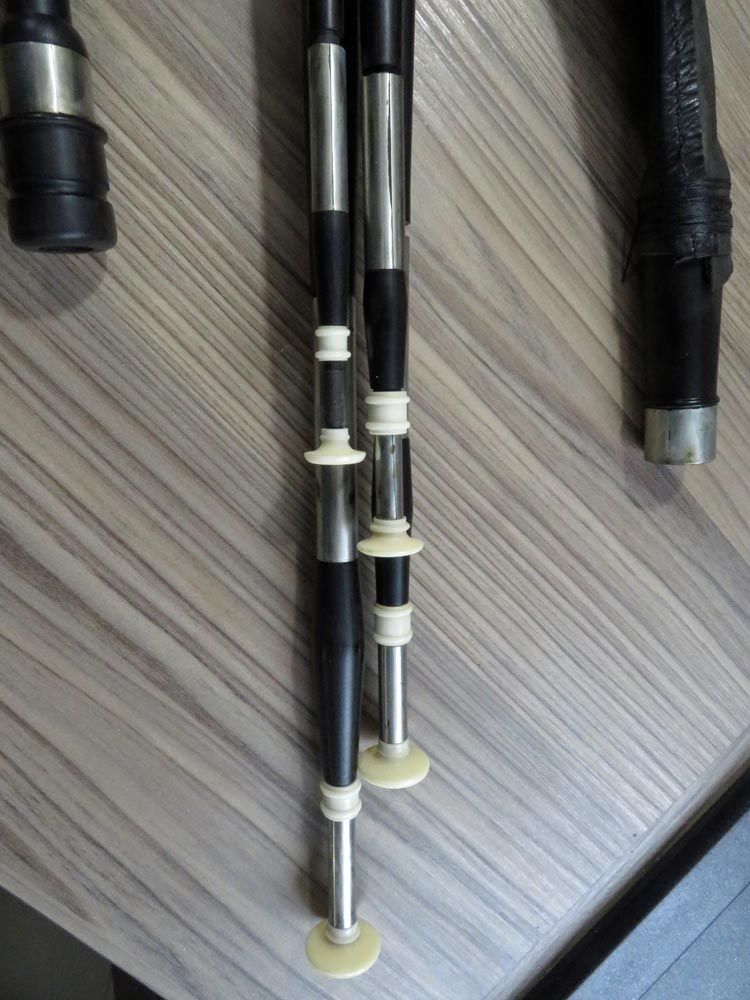

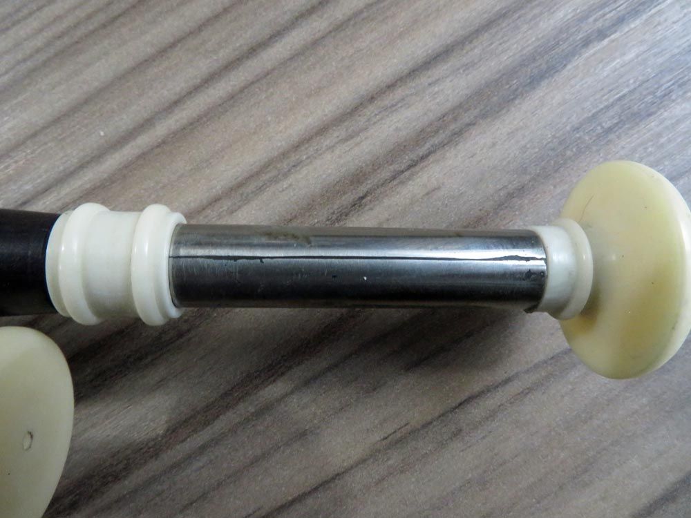

                                  Oh dear, time to 'fess up to another unfinished projectblush
                                  Started a very long time ago, based on instruments described in Cocks and Bryan. The various ferrules were made from nickel silver sheet – annealed and rolled round a former then bound with a couple of pieces of iron wire to keep the edges together while silver soldering. The ferrules were then rammed back on a mandrel for polishing.
                                  The ferrules looked fine when new but over time the silver solder discolours, leaving a dark line.
                                  I think a thin coat of nickel plating will sort that out. These drones are ebony and the "ivory" fittings are some sort of plastic sold as a substitute back in the '80s. I have a length of African Blackwood waiting to be made into a 7 key chanter and I've amassed a collection of old EPNS cutlery for converting into keys. Perhaps I'll actually get round to finishing the set some time.
