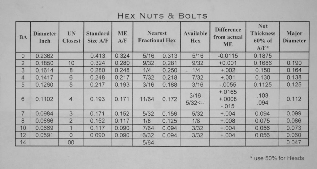

      Hi All,
      I am in Canada. I have a question regarding threading for 3.5 and 5" british locos. The threads on my builds all call out for ME or BA threads mostly. fasteners in these threads (and taps/dies too) have to come from UK. Any concerns or suggestions for alternatives that may be more readily supported in my neck of the woods?

        John Purdy
          @johnpurdy78347
          Gary
          Here's the conversion chart I have developed to convert BA to UNC/UNF threads which I have used on my projects. I normally make all my hex headed screws and nuts from hex stock. If you want I can email you a PDF of the chart if you PM me your e-mail address.

          Clive Foster
            @clivefoster55965
            For all practical purposes metric or American (unified to Brits) of close to the same diameter are a perfectly adequate substitute for BA threads. If easily available metric fine is a better alternative than ordinary metric. The shallower thread of BA is an advantage in small work. If nothing else it makes the life of a small tap easier!
            Similarly the prime advantage of ME is the shallow thread depth. Which helps when getting the proportions of small fittings et al right. Metric fine or AF / UNF will usually substitute fine but you need to watch the core diameter if its a hollow component. I've had ordinary metric pretty much turn into a spring when I wasn't paying attention.

            #597078
              having built quite a few American sourced engines my chart is the other way round but easy enough just to look at the BA colours and choose a suitable UNC or UNF number.
              Revised thread conversion
              You may also need to look at UNEF and the Model Pipe series for some of the finer threads
              Also be aware that standard UN fixings will have quite a large hex so may not fit the space available but you can get small hex from the likes of American Model Engineering, see this and the next page. When you click on the screws it shows a chart of the hex sizes

                #597097
                CHAS LIPSCOMBE
                  @chaslipscombe64795
                  From Jason's chart, I see that 1BA is something of an "orphan" thread with no clear alternative. A nuisance because it was used extensively by Amal carburetters for their motorcycle handlebar levers and ealy carbs. Does anyone know of a closer equivalent. than the ones shown in Jason's list?
                  #597100
                  Dennis R
                    @dennisr
                    UNF 12 x 28 which is only 0.007" bigger and 0.2 pitch difference
                    #597111
                      As 1BA is not commonly used for fixings being a non preferred size I did not colour match it to anything. But if you look at the numbers and just choose the nearest in the system you are using which will be M5 or #12 as Dennis says.
                      The #12 being closest with a 0.007" difference, M5 a little more at 0.012" smaller ( 0.3mm)
                      1BA is also common on gas jets. Which I would rather get 1BA taps and dies for than try and drill such tiny holes. For replacement fixings on Amal parts then you would also want to cut matching threads, or if the casting has stripped you will be wanting a bigger replacement screw anyway. These charts are more for making from scratch than restoration work.
