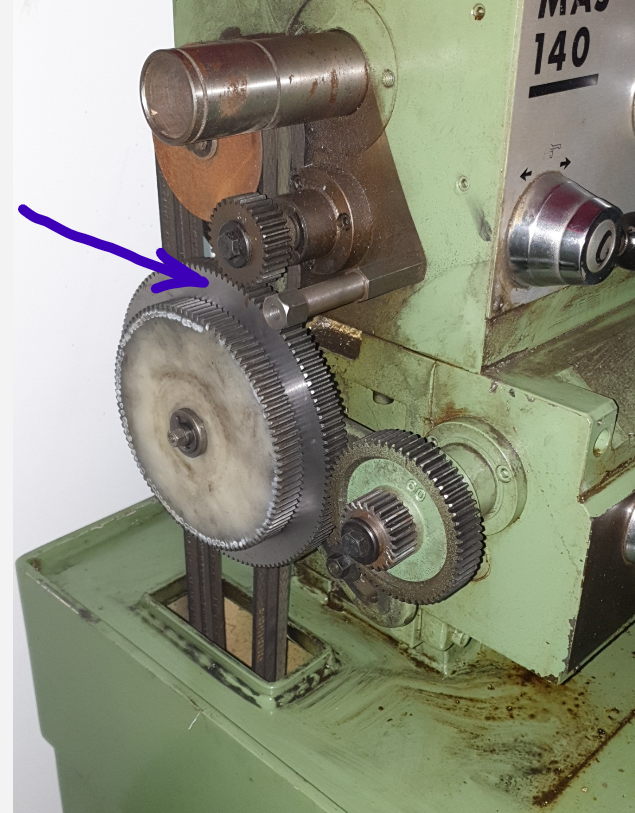

      I'm looking for a grease for all the sliding parts of my lathe. From what I have seen, WD-40 has two types of grease, one with lithium and another with dry PTFE. But I can't figure out which would be more appropriate.
      So far I have a this petroleum jelly grease but it doesn't stick well to metal. Is more like a solid soap. I have also a graphite based grease but is black and it doesn't look nice.

                            My lathe is an AVM MAS 140. Initially I didn't considered to replace the oil.
                            Ok, then the rest is clear. I'll get some 32 and 68 oil. They are available everywhere.

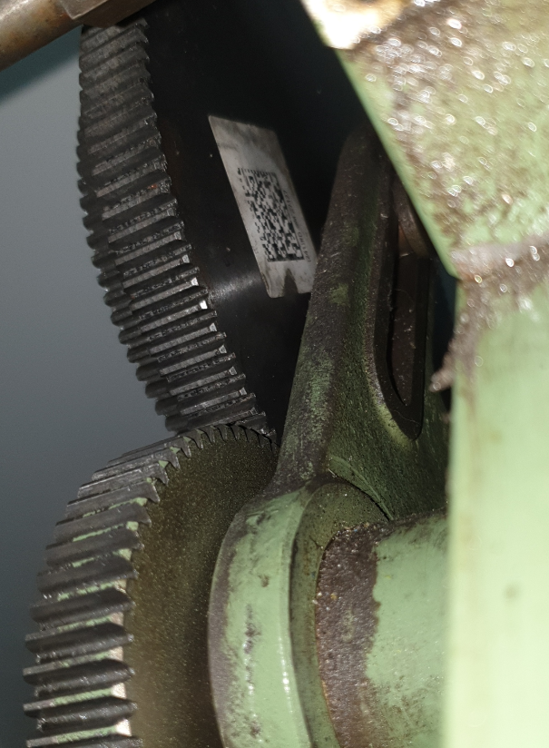

                                      I saw the links, thank you. Not the same model but I don't think that there are too many differences.
                                      I'm not familiar with the lathe market but I would be surprised if this one is from Asia. The seller lived in Italy for a few years and bring it from there. It is possible to be an genuine Angelini lathe. I looked carefully for any clues because I'm curious how old it is. The MAS1xx family dates back at least since late '70s. The only relevant marking is a "Made in Germany" on the chuck.
                                      One interesting details, there is a QR code on a cogwheel! And I'm almost sure that this late is older than QR codes.

                                        Lathes.co.uk identify MAS as Czechoslovakian. The boxy look appeared during the late 1950s and is still current. I'd expect it to be well-made – lots of communist era stuff was competitively priced because they were short of western currency.
