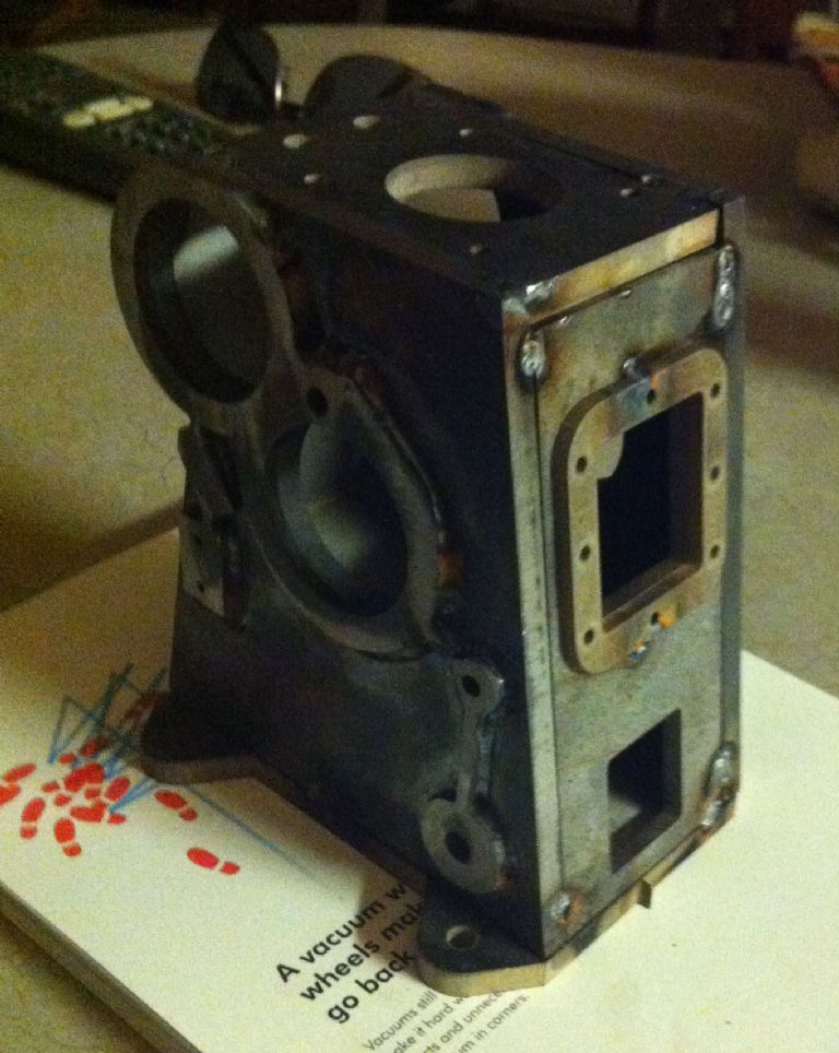

                                      George has been gracious enough to send me any info I want. I cut and welded this yesterday, to see what a fabricated crankcase would be like.
                                      The ribs between the RH bosses are for fabricating and cutting ease. All holes are undersize. I will cut the base, top and ends today. maybe get it assembled tonight.
                                      #115888

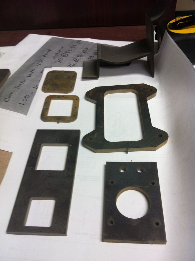

                                          I just finished cutting the base, the cylinder mounting plate(top), the RH end, flange and cover.
                                          I intend to cut the LH end from 2" MS plate, it takes 40 mins on the waterjet.
                                          #115905
                                            Oh thats a thick bit, I would have used a flat plate at the bottom and a suitable section of tube but I suppose if you can get the WJ for free then why not.
                                            How much taper is the waterjet likely to leave over the 2" thickness? I've only had stuff upto 10mm cut and its noticable on that.
                                            #115906

                                                Jason, the taper over the 2" in this case is .011" Our Dynamic head is malfunctioning at the moment, and the taper would have been less than .005"

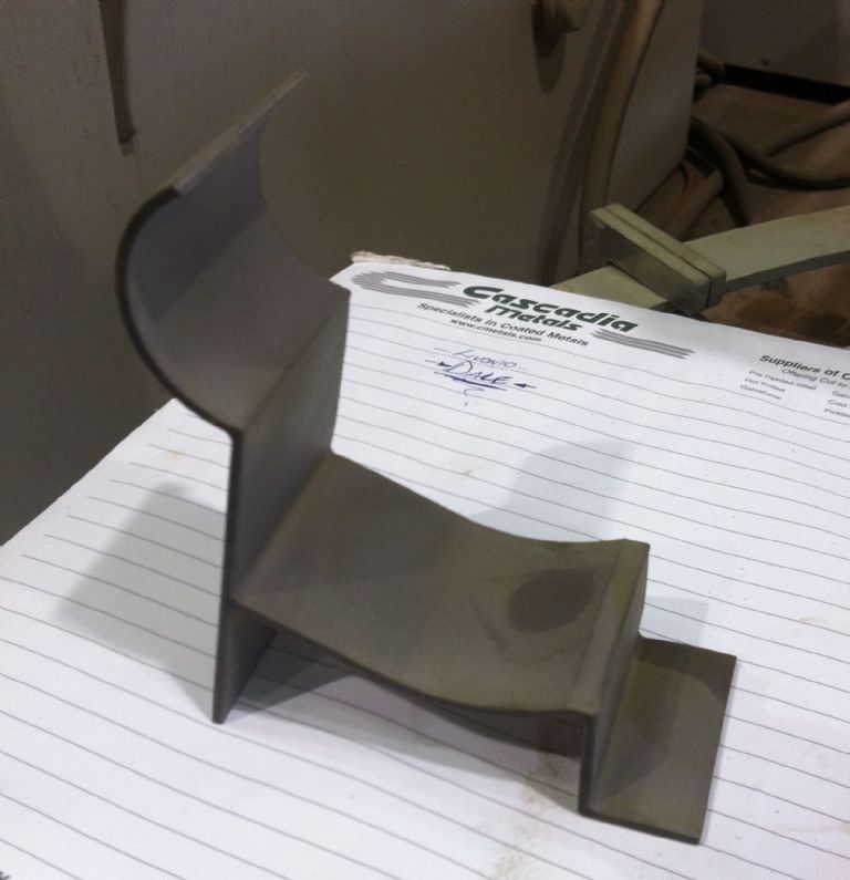

                                                HobbyNut
                                                  @hobbynut
                                                  More Water Cut parts. I now have everything to build the main crankcase.

                                                      Neil, It took 40 mins to cut that piece. Yes, I work at programming and cutting. We have 2 machines.We regularly cut 5" hardened plate for the oil industry. Cost of that piece about $100.00 to an outsider.
