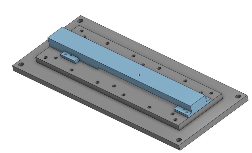

      This was my basic idea.
      The bit at the top represents the lathe bed. Obviously it's not that shape, but I just wanted to model the feet. Normally it's bolted to a thin tray through 4 M6 bolts which secure from underneath.
      My original (current?) thinking was to provide a baseplate (the bottom bit of steel) which I secure to the bench (home built wood) which I would level and then bolt the base (the middle plate) to. This would leave the base level and make it easier to level the lathe bed against it with shims.
      I thought that a simple base of 20mm steel may not be rigid enough to level against, but 2 lots of it would make the lathe (normally about 40k) far too heavy to move about for servicing, but I could probably cope with the extra 10k from the base. So the baseplate stays on the bench nice and level but I can remove the base and lathe without having worry about twist.
      I have two concerns. Firstly, my original (current?) plan was to put some m6 holes in the feet of the bed to bolt it to the base (with shims as needed). The problem with that is that the control box and motor make access to the feet at the headstock end difficult. I wondered if I should use the existing M6 threaded holes from underneath, but then I wouldn't be bolted down to the baseplate and that would lose some rigidity..
      I'm also wondering if the baseplate is actually useful.. The recent article about levelling in MEW talks about straightening a lathe up without it being level (Dollies Dad.and so on).

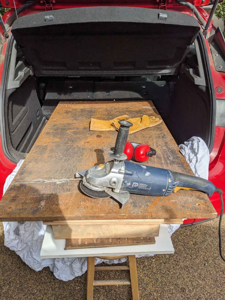

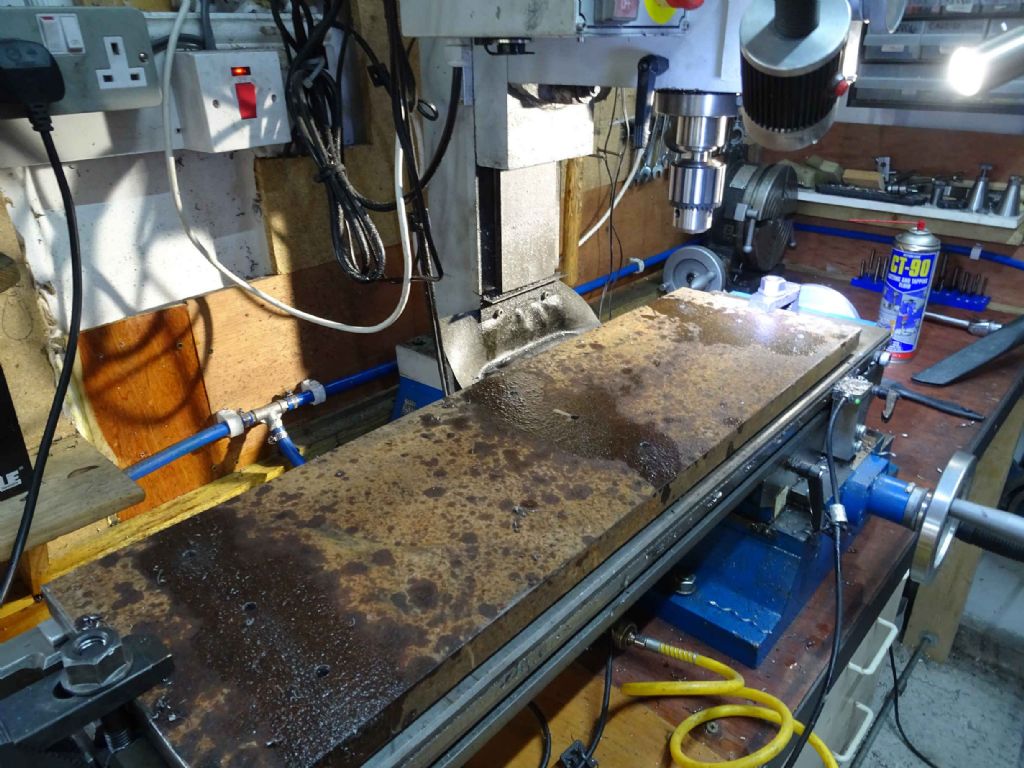

          As mentioned above I have already started on this lunacy.
          First was to find some steel to make the base and baseplate from. A visit to the local scrap yard found a piece that was far too big, but I thought, 'what the hell – cheaper than buying a smaller new bit'.
          The piece in question is about 1.7m x 77cm and weighs about 170kg. I case you are wondering, this considerably exceeds my bench press capability!
          2 strong you men and a forklift got it in the back of my car and I was sure I'd work out some way of getting it out!
          Yup – that's a big bit of steel!
          After panicing mildly for a while (to say nothing of the views of SWMBO) I got the end lifted up with the aid of my son and pulled out a bit. then I cut off the first 200mm (for the base) with a angle grinder (and several blades).
          Having done that I pulled out another 300mm (for the baseplate and cut that off). By now I'd burned through my 8 inch blades and was going through my small angle grinder! But in the end i got it off.
          This left a piece only (!) about 100kg and we were able to slip that off the boot onto the ground and then marched it over the end of my shed where it will stay until I can get round to chopping it up a bit more (I do have some ideas for it, in fact).
          Iain

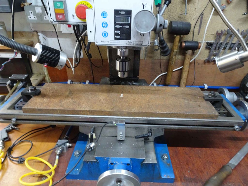

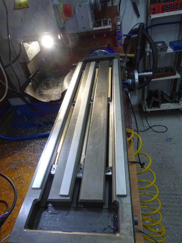

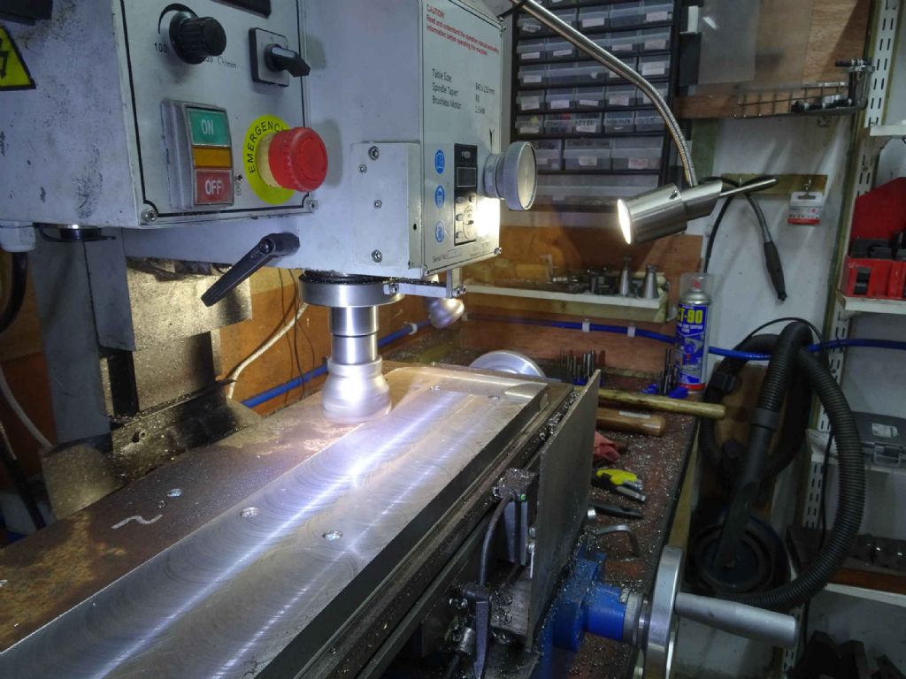

            Now it's all very well having a nice piece of rusty scratched steel, but surely I want it cleaned up?
            Yup. Inside to the Mill. Well first a bit off the end to bring it near finally dimension. The thinner cutting blades have worked much better and I got the end cut off with only an inch or so of wear!
            Fortunately my mill (VM32L) is reasonably chunky and will (just, sort of) fit the base on.
            First trick was to drill and counterbore some 6 mm holes so I can secure it for face milling.
            I also squared up the back of the piece with a 10mm carbide end mill. It would have been nice to use the front, but there wasn't enough travel. Had I been clever I would have mounted the plate further back (5mm would have done) and I could have trued front and back at the same time. I wanted to true one side in this position so I could square it up with an indicator for future operations.
            When I'd done all this I realised that I'd no easy way to get the T slot nuts in the right place. I had to use bolts as my fixings couldn't be proud of the workpiece.
            The solution was to cut some bits of wood which match the distance the nuts would have to be as seen below.
            Then bolted down, square up (the machined edge now at the front) and on to the surface.
            A few passes and mostly it's done. There's a few mm at one end which I can't get to on the surface, but that will come off when I machine to size.
            There are also some bits at the ends I couldn't get to with the end mill and will need to move the plate around on the table to get access to them and the short ends as well.
            Iain

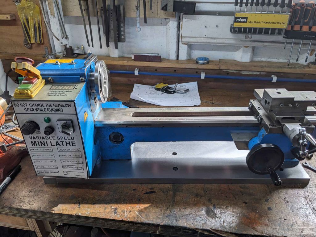

                          I have got to the point where I've built my bed and bolted it to the lather

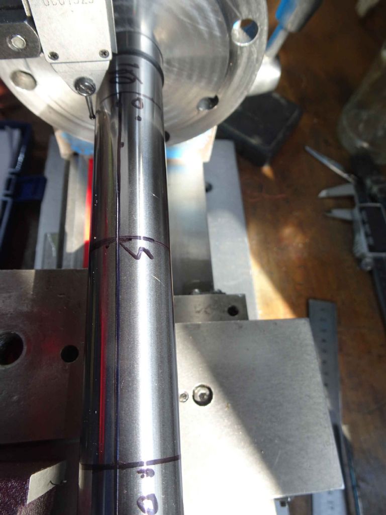

                          I've then run a series of tests as follows:-
                          MT3 test bar in headstock, min and max deviation of distance from toolpost.
                          Fine cut of 40mm bar in 3 jaw chuck. Diameters and devation from 0 along one side.

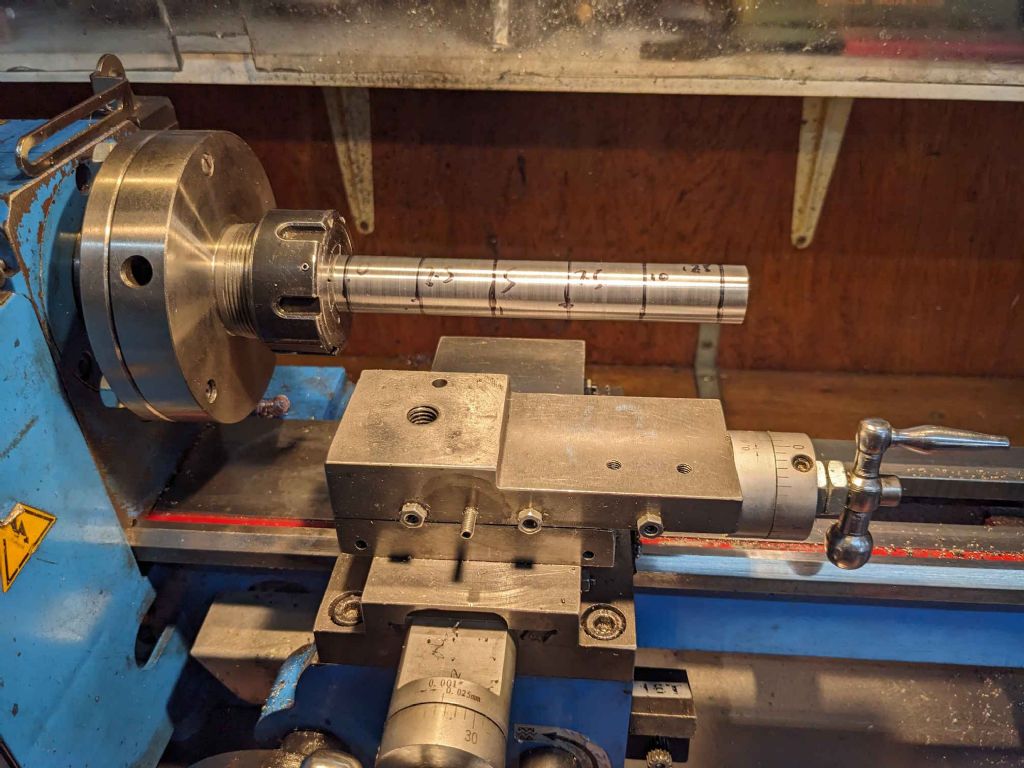

                          Fine cut 20mm bar in ER32 collet. diameters and min and max devation from 0 along along length.
                          TEST BAR
                          20mm bar in collet

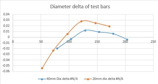

                          Here are a couple of graphs. the first is the diameter measured at a number of points along the length of the test bars with a 20mm bar in a collet chuck (ER32) and a 40mm bar in a 3 jaw). the distances shown are the distance from the end of the spindle rather than from the chuck. the collet chuck is about 47mm deep and the 3 jaw around 75. 20mm bar and test bar measured with a micron digital micrometer. 40mm bar with an analog vernier micrometer.
                          Diameter changes

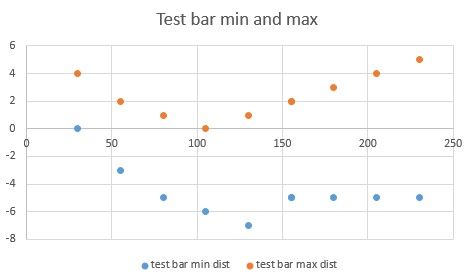

                          The one below is the min and max distances from the tool post to the test bar
                          Test bar min and max from toolpost

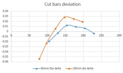

                          The test bar diameter is within a couple of microns all the way along the length, but I can't guarantee it's straight (though I would hope it is, it's new!).
                          If you remember back to my first post, I found that a bar held in the 3 jaw cut to be narrower at the headstock end by a thou or two over 50mm.
                          As far as I can see this information supports it. It would appear that as it moves from the head, the crossslide moves OUT until around 150mm from the spindle. It then starts to move back in a little.
                          IN short the bed appears to have a dogleg in it.
                          All of this (long) blurb ends up with a simple question… 'how can I fix this?'.
                          The base is probably reasonably flat (I don't really have the kit to test it over a long distance). The bed bolted down to it without any obvious stress implying the feet may already be planar.
                          If the bed was just twisted I would have expected to see the movement (change of diameter) in one direction not in two. So I can't see how shimming the feet will help – I could possibly twist out the deviation at the headstock end, but it would make the later deviation worse.
                          Help!

                                I dont quite understand how the diameter of your test bars vary with position in a similar pattern, which would have me checking everything about my method.
                                That aside, your conclusion about a banana shaped bed looks correct. The next step would be to blue up the saddle and see what emerges on the bed and vice versa. It could be something as stupid as a dent in bed or saddle.

                                  Benedict. I would expect to cut wider away from the chuck due to reduced rigidity. However, this is starting to cut narrower + I took a few of spring passes and there was no material being removed (or microns) after. Also, the 40mm bar should be rigid enough to avoid that.
                                  Martin. Looking at the two sets of results, I realise that they don't quite make sense. The test bar should show a closer distance to the toolpost, then further then nearer. I need to have another look at that.

                                    Iain, nothing is rigid. Everything bends. It is just a question of degree. Thicker bends less, but it bends.
                                    That said, you are correct that you would expect it to turn wider further from the head stock.

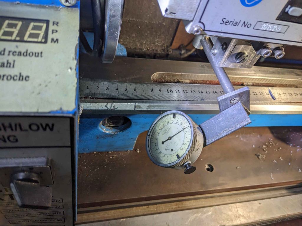

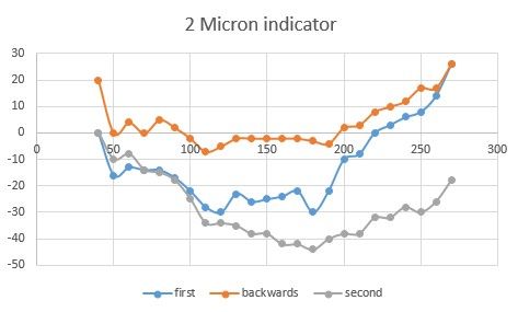

                                              The base is complete (and heavy). Before bolting it on, I put the lathe on the mill table to measure how straight the edge of the bed was. My first concern was that the lathe rocked somewhat and I needed to put a 0.15mm shim under the back left foot to chock it up. Clearly the bed, at some level is twisted!.
                                              I used a 2 micron test indicator attached to the spindle to measure along the edge of the bed. I recorded the results in 10mm increments. Being ocassionaly careful, I ran back in a second pass and ended up in a different place . results are below.
                                              TWO Micron Indicator results
                                              Blue is the first run forward, orange the dun backwards after that and grey a 2nd run forward.
                                              I suspect that either the indicator is being swayed by being pulled sideways along the bed or that the spindle is being pulled slightly.
                                              To try this in a more controlled way, I bolted the lathe to the new base, locked the spindle and broke out my one micron compac indicator.

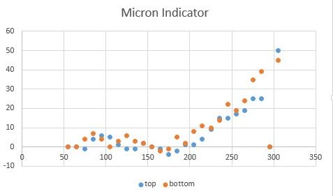

                                              The results of that are rather more consistent:-
                                              Lathe bed deviation in Microns
                                              I took one run at the top and one at the bottom of the edge.
                                              As a reminder, the graph below (now normalised for distance from headstock), shows the deviation from an average of the diameter of the 20mm and 40mm bars cut in the collet and chuck.
                                              Bar deviation in MM
                                              This all makes some mechanical sense if the headstock is angled slightly away from the bed (that is furthest away at the tailstock).
                                              No at all sure what I can do with this.

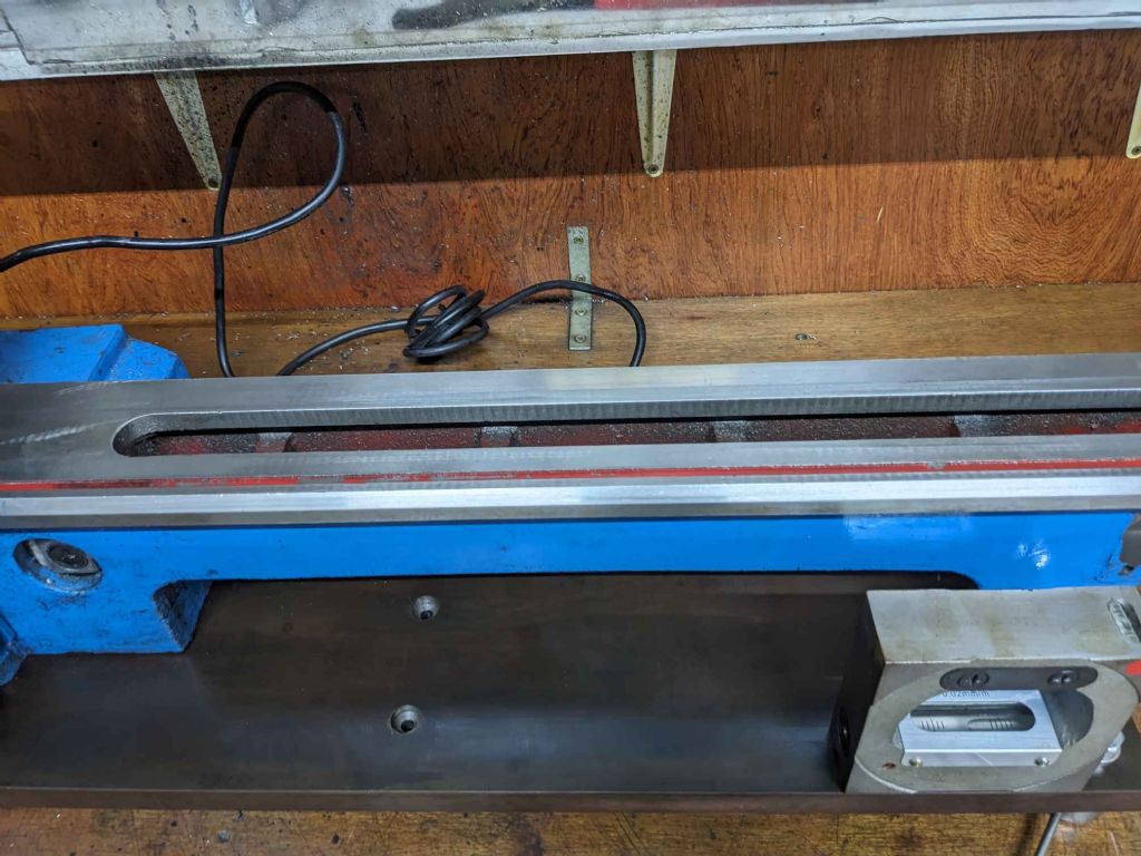

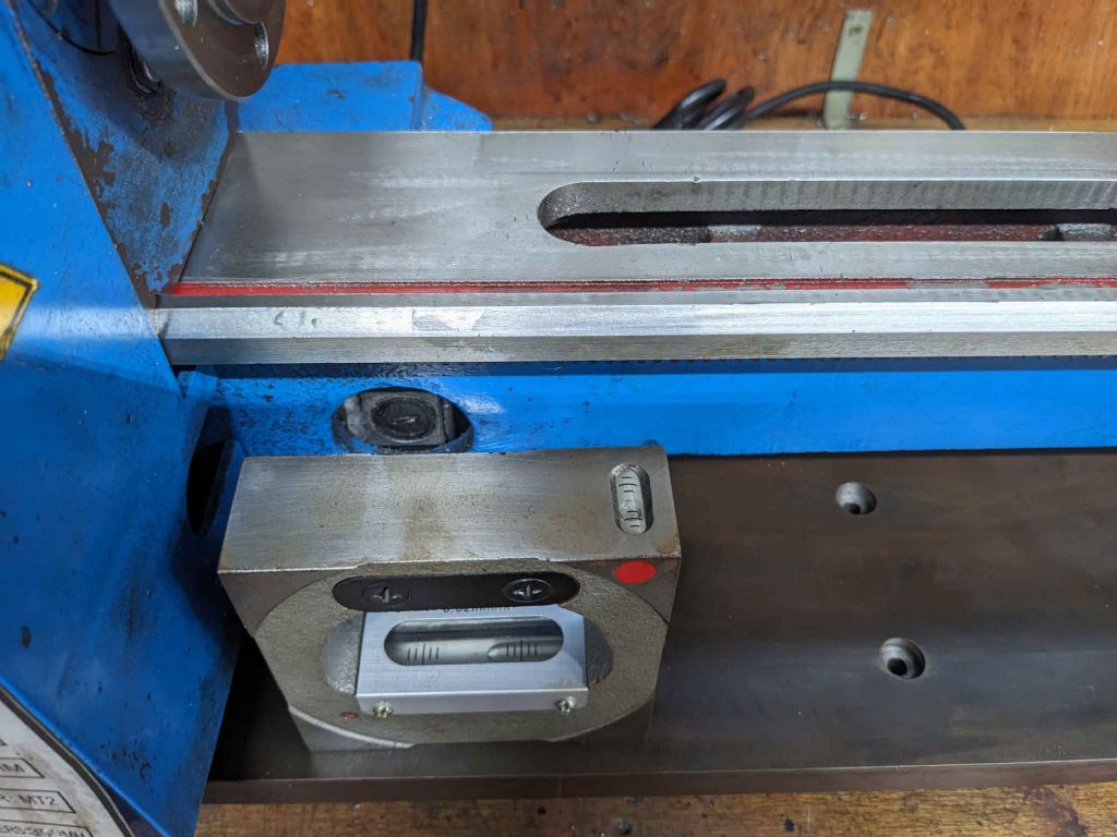

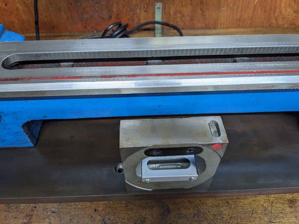

                                                Ah, but, I didn't finish there!
                                                I've made some levelling feet for the base and set up the lathe and attempted to level the base.
                                                Is the base level?
                                                Not really!
                                                It's maybe a bit hard to see, but the centre is pretty level, but both left and right ends slope upwards to the right.
                                                I must say it was a pleasure to break out the engineers level as I've never used it since asking for it for a birthday present about 10 years back! I was sure I would need it…
                                                If I've understood this level correctly each graduation represents 0.02mm / m. In which case the drift upwards is over 20 microns across the width of the (100mm) level. That's taking a guess at how for off centre the bubble is (10 graduations..). This does seem to be maxed out so it could be anything.
                                                When on the mill bed, there was no rocking of the base, but it was definitely spinning around the centre not near the ends, so I expect it is mildly out – Of course as well as straightening up the lathe, this will have twisted the base a little.
                                                I've had a bit of a go at levelling just one end and also looking at the levels on the lathe bed, but it was doing my head in so I gave up for the day.
                                                Any advice will be much appreciated!
                                                Iain

                                                Neil Lickfold
                                                  @neillickfold44316
                                                  All that you need is the two planes in line with the Y axis to be in alignment. It can slope slightly to the headstock or to the tail stock with no issues.
                                                  You can wind the carriage down to the headstock end, and with the level placed for and aft on cross slide, adjust the head stock to level. Wind down to the tail stock end, and adjust to get that end level. A little winding back and forth and you will have it. That will get the bed running true and fairly close. Check the headstock, to see if the run of the headstock aligns to the run of the bed/carriage movement . Indicate a bar to run fairly true at the chuck end and at the end of it's length. A low pressure dti is a big help in this . Most plunger clocks have too much pressure and can give a false reading. I prefer low pressure finger indicators for this type of work. Check for parallel at the top of the bar and from one side. Your test bar wants to be no more than 10 diameters long.
                                                  After that it is a matter of setting up the tailstock to be true to the chuck and check it at a few different length positions along the lathe.. start close to the chuck , and adjust the centre to match to cut the same at each end on something that is short like a piece of 10-13mm ali bar out about 30mm. Then check with a more substantial bar over the full range of the saddle /tailstock travel. If this is out, you may need to adjust the tailstock feet a very small amount to get it in alignment. Then test the centre area of travel and then retest the front section again. When all 3 will produce the same result of a parallel cut, it's as good as it gets.
                                                  Most lathes have the tailstock up to0.05mm or so above centre when new. This is normal.
                                                  Its not as easy on some machine to get right, so expect a day or so getting it right. Others come in and are good from the get go it seems with minimal work required to get them set up. Some lathe stands are a 3 point system with 2 extra pads for taking up the slack, with the 3 main points being the main load bearing ones..

                                                    Iain Downs
                                                      @iaindowns78295
                                                      Hi, Neil. If I can paraphrase:-
                                                      Set the headstock end of the bed via the cross slide to be level across the bed. Move to the tailstock end and tune that until it's level (across the bed). Rinse and repeat until both ends are level …
                                                      I assume that I can set the headstock end level using the adjustment feet on the base. I will then make sure that the base is stable at the tailstock end and use shims between the base and the lathe feet to level the tailstock end.
                                                      I will give that a go.
                                                      Thanks
