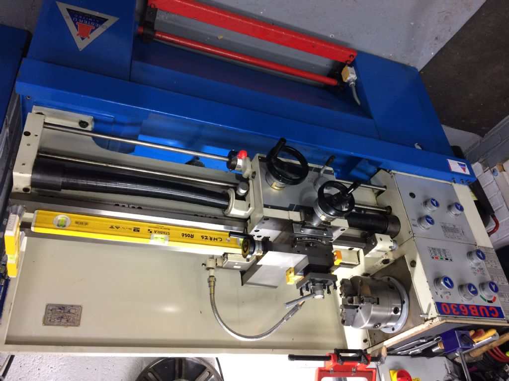

      Right then …. I need a bit of help please. as per my previous post i have bought myself a Chester cub 630 (see pics)…. I thought all was well with my set up until i did a test turn of about nine inches to see if i was turning parallel……alas i was not, at least a millimetre difference from the chuck dia to the tailstock centre, (solid bar about 36mm dia held in the three jaw chuck with the tailstock centre in place..
      And so to my levelling attempts… I fully understand that i need to eliminate any twist from the bed ways and this is what i have got set up.. (see pics), at the moment i don't own a precision level, so i'm just asking is this the correct places to put the levels??. I know i need to take more trial cuts to see if there is any improvement in the setting up…. btw the small aluminium posts that the levels are sitting on have all been checked with a digital calliper for same heights
      At the moment the machine feet are M16 bolts that are screwed through existing holes in the bottom of the frame, so they allow me to make fine adjustments one at a time….. the floor of my garage is concrete and has a slight incline
      thoughts please

              Posted by Chris Rose on 15/02/2018 22:09:56:
              thoughts please
              My thought: You have too big a problem there to cure it by 'levelling'
              … Look elsewhere. [headstock alignment perhaps]

                  Hi Chris,
                  From your description I understand you are using the tailstock centre to support the workpiece, to check for parallel turning you do NOT want to use any tailsock support.
                  You may need to use a shorter length of material chuck mounted only for initial tests.
                  It is neccessary to confirm the lathe turns parallel before using tailstock support, if it turns out of parallel with tailsock centre support the tailsock should be adjusted to correct the misaligned centre axis.

                      If you are using the tailstock centre odds are its a combination of chuck runout and the tailstock being offset a touch.
                      Nine inches is far too long a cut for a simple 36 mm (call it 1.5 inches) diameter bar held in the chuck. Normal rule of thumb is no more than 3 x diameter from start of cut to chuck jaws. Translates to 4 1/2 inches of cut. Half of what you are doing. Quick reference for that sort of thing **LINK** .
                      For a quick'n dirty check I put nylon or, better, delrin collars on the bar. Cutting forces are much much lower so you can get away with far more stick out. Should be OK with your 9 inches. Better to use thick wall tube rather than solid bar as lower weight means less tendency to sag.
                      If the collars are pretty much same diameter you need to verify that the tailstock is in reasonable alignment. Quick way is to fit the headstock and tailstock centres and slide the tailstock up the bed until the points pretty much touch. Ideally they should be exactly point to point. If not trap an old 6" steel rule or similarly thin bar between the points and adjust the tailstock so that the bar lies straight across the bed. If the centres are good and sharp this is a very sensitive test.
                      Really you should be making your alignment tests by working between centres. You need to get an accurate centre in each end of your test bar so its size is limited by the spindle bore. Hold it in the chuck with minimal protrusion, face the ends and put the centre hole in. Then set up with delrin collars at each end and make your test cuts adjusting the tailstock as required to get them the same. Ideally no adjustment will be needed if you et the centres point to point first but in practice small, affordable machines are rarely dead nuts. If need be you can work your way back along the bed to verify consistent behaviour using bars of different lengths. Three should be fine.
                      Personally I'm very skeptical of all this levelling and twisting the bed to make things accurate bit. Careful shimming of the feet so it sits evenly and a good clinometer on the bed during the bolting down process to verify that no stresses are being applied always worked fine for me when I had smaller machines.

                                Stop, stop, stop.
                                Sit down and read up a bit on setting up your lathe. The test you describe above with tailstock centre in place is a (rough) test for the tailstock alignment, not for headstock alignment and bed levelness.
                                To fix the taper you are experiencing with tailstock in place, you need to adjust the offset of the tailstock, not the bed level and not the headstock alignment.
                                Not familiar with your lathe model but usually the tailstock is in two pieces, the main body and the base that slides on the bed ways. There are usually adjusting screws that allow you to move the main body side-to-side and clamping screws that then hold the body in that position.
                                If your test piece is tapered larger at the tailstock end by one millimeter, the tailstock needs moving towards the front by half a millimetre. If it is 1mm small at the tailstock end, the tailstock needs moving towards the back of the lathe by half a mm. Its best to do this test with a bar between centres as the chuck clamping one end can skew the result, unless the bar is gripped lightly with only a short bit in contact with the jaws so it can move ever so slightly.
                                Neil has received a nice article and pics on a beginner's guide to tailstock alignment so keep an eye on future MEW issues for full details of the process. It seems to be something that catches out a lot of beginners.
                                If you do want to check your headstock alignment and adjust the bed twist to correct any error, use a piece of bar sticking out of the chuck six inches (150mm) long and 1" diamter with no tailstock used to support it. Take a light cut along it and measure for taper. The Myford ML7 manual readily available online gives a good description of which way to twist your bed if turning tapered like this. It applies to all lathes, not just the Myford. Do your levelling with the cabinet or bench bolted to the floor and make your adjustments at the bolts where the lathe attaches to the bench. Your level positioning in the photo looks OK but you don't need the long longitudinal level, just the two short ones across the ways. They need to be set to the same reading to ensure no twist, It matters not if the whole shebang is at an angle lenghways, you are using the levels to measure twist in the bed, not really levelness. In fact some prefer a bit of a slope lengthways so coolant flows to the drain hole in the tray. You will still have to do the bar turning test to get the final setting anyway so you might as well do it first and see if the lathe is in fact OK as is.

                                    Looks to be in reasonable condition for an ex-school lathe. I can see from the photo that it is generally level in the simplest mechanical terms. Before checking twist etc make sure it is bolted to the floor with suitable packing to avoid any wobble/twist in the cabinet stand when tightening up the bolts. These lathes are very top heavy and need bolting down. Once safely secured you can then follow the advice above to take out any twist in the bed.
                                    Someone will mention "Rollie's Dad's Method" of lathe alignment so it might as well be mefrown the link is a downloadable PDF from HMEM.

                                        Don't think that because a lathe is heavy that it won't twist. My BL12 -24 weights 300Kg, but will still twist if not bolted down correctly.
                                        Lacking a precision level, turn test bars, without Tailstock support, and adjust/shim the feet until twist has been eliminated from the bed. The Myford Manual gives clear instructions on how to do this.
                                        If you can borrow an Alignment bar; using a DTI, this can be used to check Headstock alignment. Ideally, a Morse taper one will be best, since you eliminate any errors in the chuck.
                                        Assuming that the Headstock is correctly aligned, you can then turn your attention to the centres. True up both.
                                        Once confident of the Headstock alignment, with the Alignment bar between the cleaned up centres,, you can adjust the Tailstock until the DTI reads the same at both ends of the test bar.
                                        If all goes well, you should then have a lathe with minimal or no twist in the bed, with a properly aligned Headstock and Tailstock.
                                        Then go to work!

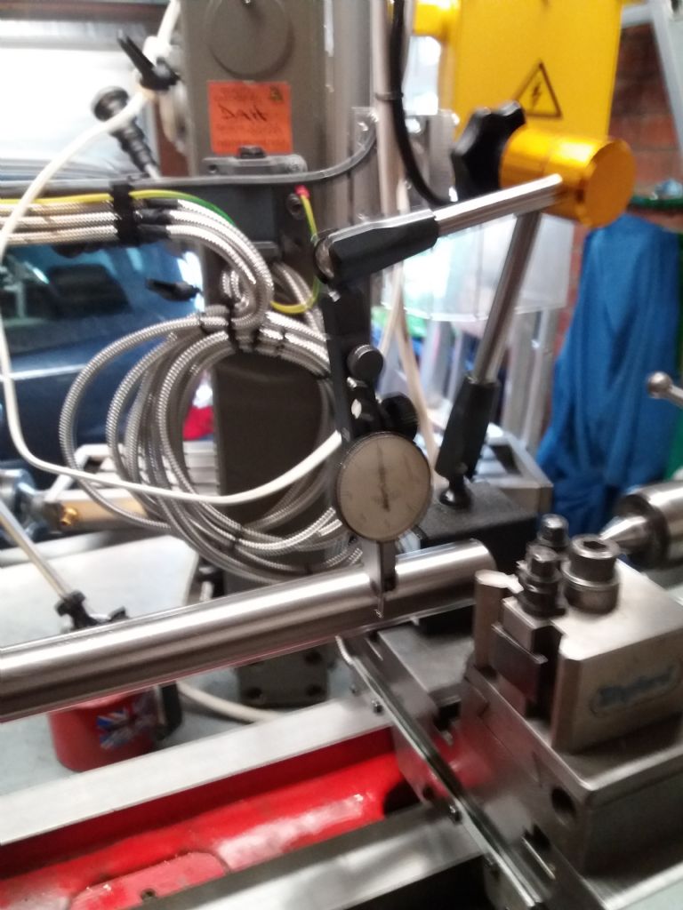

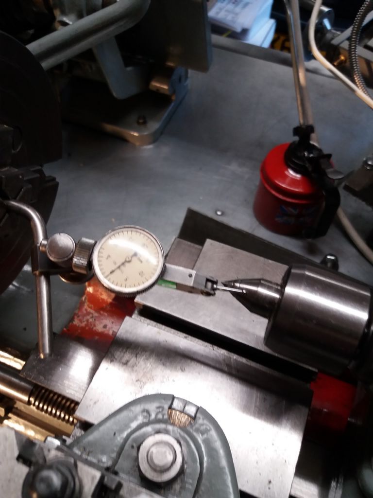

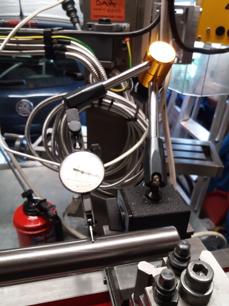

                                          As a service engineer I would always set a lathe with a standard bar as I have a few, 1 1inch diameter by 12 inch long, 1 1 and 1/2 inch diameter by 18 inch long and 1 2 inch diameter by 24 inch long. as I have only my M4 Drummond lathe I only use the small one but it never fails to find and help correct run out, taper, and spindle bearings at fault. You can use a piece of ground silver steel bar as long as it isn't damaged but big enough not to bend 25mm diameter  is what I would recommend for a small lathe like mine.
                                          I put the bar into the 4 jaw chuck and roughly clock it centre then I traverse the clock to the end of the bar and repeat clocking taping with small hide face mallet and repeat clocking both ends till there is no movement of the clock and the 4 jaw chuck is tight but not strained. move the clock to the far end of the bar and zero on top. pull the chuck up and down and record any play. Repeat this with the clock on the front of the test bar on centre height record any movement. If you traverse the clock along the bar there should be no movement if all ok but record any movement if there is. Repeat this with the clock on the top the same should be zero but record.
                                          Then I have a piece of silver steel bent and a knuckle for a clock and put it in to the chuck set it rotating by hand till it scribes a small circle and push the tailstock with a centre in which is clean and not damaged up the clock till it reads. Lock the base and barrel and rotate the chuck and record any movement. Remove the centre and repeat the check but with nothing in the clean morse taper and record any movement. The lathe can now be adjusted to remove any inaccuracies i.e. spindle out of line, bearing play and tailstock misalignment.
                                          Always check by cutting a piece of bar and measuring parallelism.
