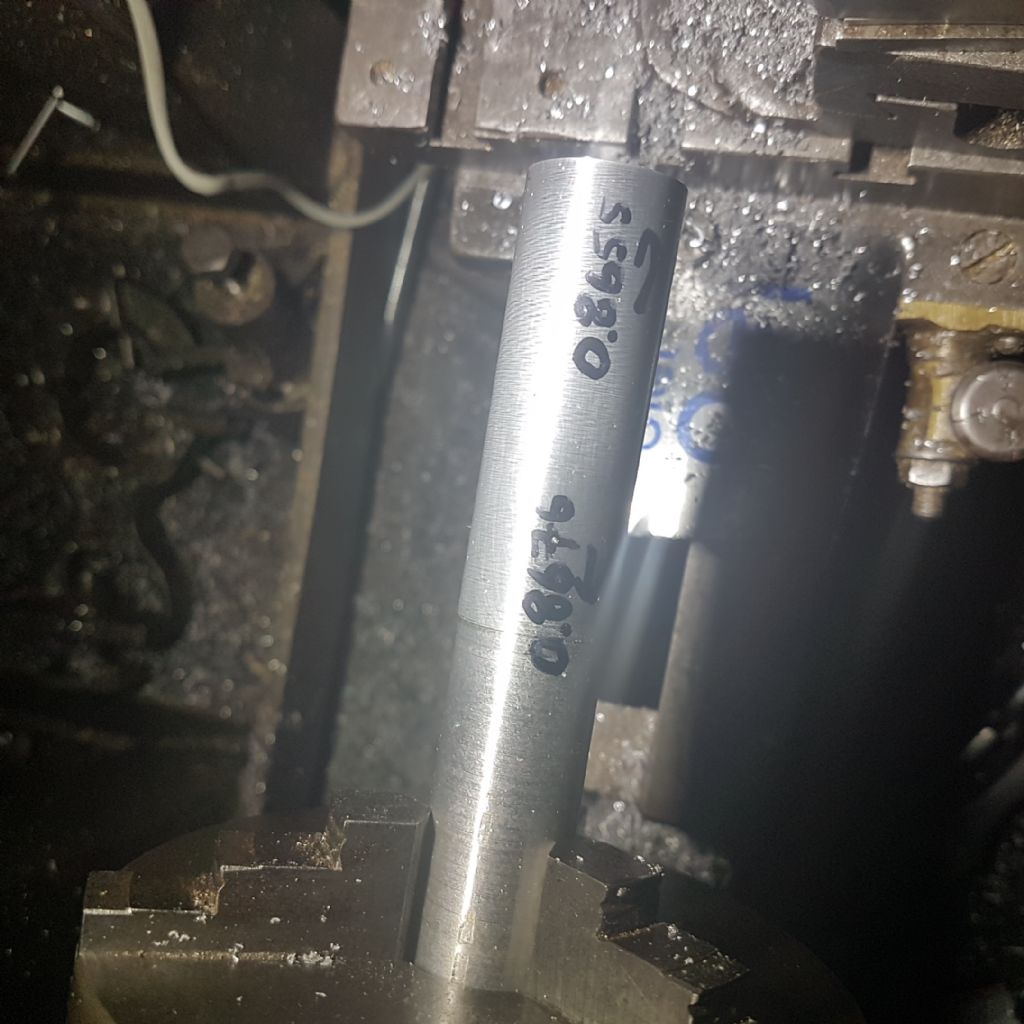

        #347029
        Jon Cameron
          @joncameron26580
          I recently did a test cut having left my lathe all winter in the dark shed. (She was tucked up). I was 2thou out. Will adjust one of the feet my ML4 is setup on and hopefully get it a little closer, the tenth of a thou is approxmate I can only measure 1thou with my dial indicator. 20180319_233210.jpg

          Speedy Builder5
            @speedybuilder5
            Quite impressive, but the surface finish doesn't look so good. I think I would attend to surface finish before I made other adjustments for run-out.

            ASF
              @asf
              Posted by Jon Cameron on 21/03/2018 23:10:55:
              Why do you use a dial indicator to test for parallel turning? I thought the test was turn both parts of the bar and use a micrometer to measure.

              Journeyman
                @journeyman
                I am not quite sure that you can measure a taper using a dial indicator, surely if set in the toolpost it will simply follow the same path as the toolbit and therefore will show no difference from end to end as the carriage is moved. You would normally measure with a micrometer or at a push with a dial/vernier/digital caliper. Once the lathe is turning parallel then a dial indicator could be used to make measurements.

                thaiguzzi
                  @thaiguzzi
                  Posted by Speedy Builder5 on 22/03/2018 08:11:50:
                  BobH
                  I'm sorry to have to agree. That finish is appalling. To such a degree it probably affects "tenths" in a reading.
