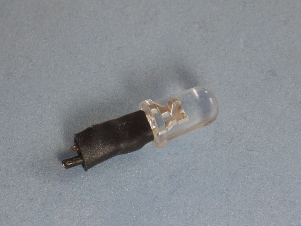

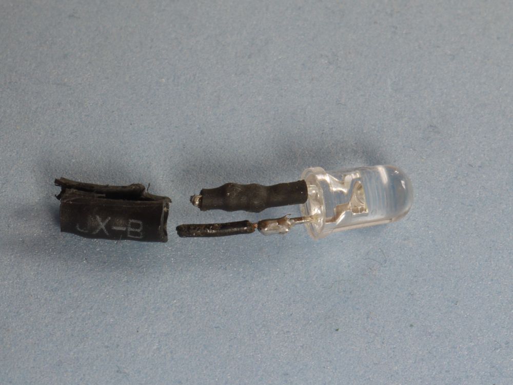

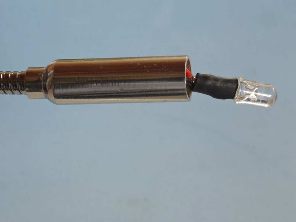

                                    Here's an odd one …
                                    Plugged a little USB 'gooseneck' LED light into the Mac, just to check it.
                                    Mac popped-up a warning message, telling me that the device required too much current, and was therefore being switched off … Odd, because the USB port on the MacBook Pro is capable of delivering One Amp, and the single LED should only draw a few milliAmps.
                                    Thankful that the Mac had protected itself … I had a look inside the lamp: p1180865_s.jpg
                                    Note that the insulating sleeve is just a little shorter than it needs to be.
                                    #166634
                                      < continued >
                                      Sorry, the Red lead broke at the solder joint before I could cut it.
                                      Removing the outer sleeve revealed a very nicely executed Heat-Shrink sleeve inside, covering the dropper resistor:
                                      … Which makes me think they bought-in the LEDs with the resistors attached.
                                      It certainly looks like two different standards of workmanship.

                                        #166652
                                          Hi Michael,
                                          The USB limit is only 150mA for USB1 and 500mA for USB2.
                                          A proper USB controller will only let each device use an allocation of 100mA 'units' if it is 'asked' for permission.
                                          I imagine that your MAC implements this strictly and the LED is not an intelligent device.
                                          #166656
                                            Posted by Neil Wyatt on 16/10/2014 09:43:27:
                                            Hi Michael,
                                            Neil,
                                            May I suggest that you check Apple's specifications … The USB2 ports on the MacBook Pro [and several of the other machines] were upgraded to deliver up to 1000mA, so that they were capable of charging the iPad.
                                            Agreed, the LED lamp is not an "intelligent device" and so the USB port should limit the current … but the point I was making was that the LED lamp had an internal short … and [as an aside] I was pleased to find that the Mac not only protected itself, but informed me how and why it had done so.
