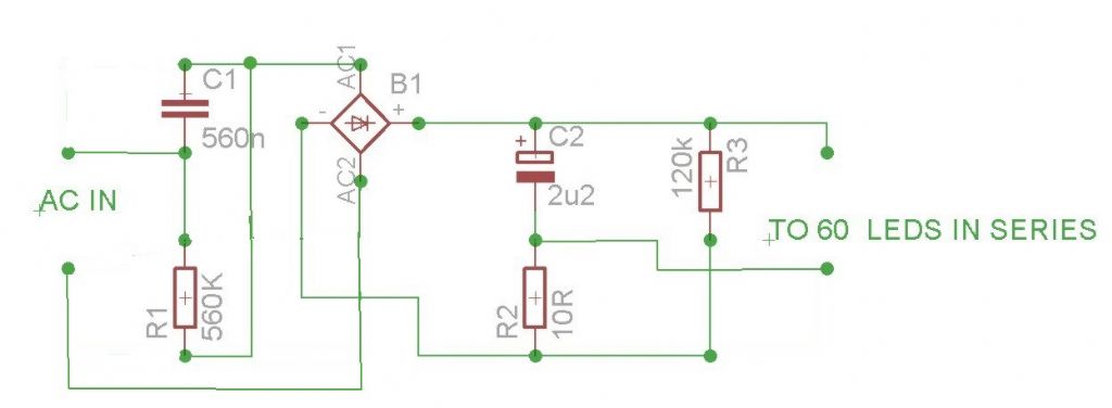

                          The 'drive circuit' built into the LED lamps is little more than a bridge rectifier. Hardly sophisticated, but nice to have a noise filter on the input!
                          Back in the early days I heard of a petrol station canopy burnt down due to a cascade failure in a fluorescent replacement LED bar where the failure mode was for the LEDs to go short, rather than high resistance… can you see where this is going?
                          Edited to correct circuit diagram – again

                              #164524
                              Les Jones 1
                                @lesjones1
                                Hi Neil,
                                I think your schematic is wrong. I think you will find that the 560K resistor is in parallel with the 560 nF capacitor. Also the 560 nF capacitor will be between one AC input and the bridge rectifier. The capacitors purpose is to limit the current trough the LEDs. It will have a reactance of 1/(2 x pi x f x C) = 1/(2 x 3.142 x 50 x 560 x 10^-9) = 5683 ohms. A capacitor is used rather than a resistor so that no significant amount power is lost (And heat generated.) I think the 560K resistor is just to make sure that the capacitor is discharged when the lamp has been unplugged.
                                Les.

                                #164527
                                Ian P
                                  @ianp
                                  Posted by Les Jones 1 on 24/09/2014 16:04:44:
                                  Hi Neil,
                                  Les.
                                  Edited By Les Jones 1 on 24/09/2014 16:05:28
                                  I like the last bit Les!
                                  They are obviously very concerned lest somebody get a mild electrical shock from touching the terminals after the bulb has been unplugged. That assumes they are not already dead! Oh, but if they were dead they couldn't unplug it, catch 22.
                                  The circuit does look a bit fishy, I only glanced at first and thought the 2u2 capacitor was the dropper, than I saw the bridge. I find 'Eagle' (I think) schematics not a patch on the diagrams that I grew up on in Wireless World. Having junctions appear in the middle of a single wire for example confuses the eye.

                                  #164529
                                  Les Jones 1
                                    @lesjones1
                                    Hi Ian,
                                    I agree that the resistor is a bit pointless if this is one of the units mentioned that do not have a glass cover over the PCB with the LEDs on. I also found the You tube video about these lamps amusing. The guy that made it seemed to think that the connections on the front would only be live when it was plugged in one way round. He obviously did not consider the bridge rectifier.
                                    Les.

                                    #164539
                                      Hi Les,
                                      Yes you are right. I thought I could make out where the traces went on that side and didn't check them with a meter.
                                      This is one of the glass fronted bulbs, and C E (not CE) marked too!

                                          #164597
                                            Posted by Neil Wyatt on 24/09/2014 17:43:20:
                                            Hi Les,
                                            Just "for the record" it might be helpful if you would please post a corrected schematic.

                                            #164599
                                              I just did that (in the original post to 'lose the incorrect version), then scrolled down and read your post.
                                              It's a bit clumsy as I didn't save the original in Eagle.
                                              P.S. the extra junctions are the result of me being over-enthusiastic, not Eagle, I wanted to be sure it was clear..

                                                #164615
                                                Les Jones 1
                                                  @lesjones1
                                                  Hi Neil,
                                                  I think your schematic is still wrong as you have the resistor and capacitor connected across the mains. The two components (In parallel.) should be in series with the mains input to the bridge rectifier.
                                                  Les.
