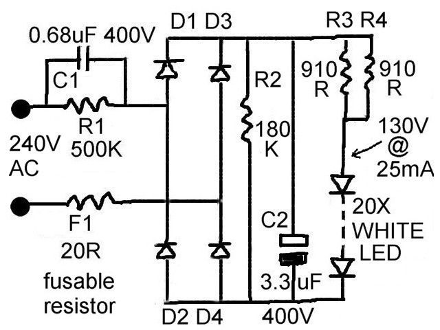

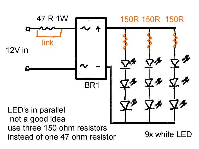

                                          Hi Micheal
                                          have a look at this MR11 lamp
                                          breaks the rule of having LEDs in parallel with a common dropper resistor
                                          (more pictures in the album)
                                          the GU10 mains lamp has 20 LED's in series
                                          C1   the 0.68UF capacitor acts as a Wattless dropper instead of a resistor
                                          (the resistor  R1 provides a discharge path for C1 )

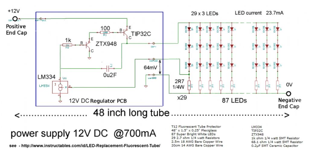

                                          this DIY 4" tube replacement could give you ideas
                                          I like the fact it runs of 12V , usefull when the mains is lost

                                          #165774

                                              Posted by Michael Gilligan on 24/09/2014 13:05:49:
                                              If you are interested in failure modes of LED clusters … this is worth a look.
                                              John,
                                              Thanks for the schematics, but I'm not sure what you mean by "breaks the rule of having LEDs in parallel with a common dropper resistor" … It's certainly not a good rule. [see link above]
                                              There do seem to be many variants on the theme … which is why I thought it worth starting this thread.
                                              … Keep 'em coming !!

                                                  #165788
                                                  john swift 1
                                                    @johnswift1
                                                    Hi Michael
                                                    typing finger and brain not in sync
                                                    should of been – breaks the rules having LEDs in parallel with a common dropper resistor"
                                                    the forward volt drop across LED's will not be identical
                                                    the LED's with the lower Vf will take a larger share of the current , run hotter
                                                    resulting in the Vf dropping and the LED current increasing
                                                    this runaway condition will destroy the LED
                                                    the regulator in the     http://www.instructables.com/id/LED-Replacement-Fluorescent-Tube/     project
                                                    monitors the current through the 3 LED's and adjusts the supply voltage accordingly to keep the current constant
                                                    simple but has a problem if one of the first 3 LED's fail
                                                    the circuit on page two of the ON semiconductor application sheet    http://www.onsemi.com/pub_link/Collateral/AND8109-D.PDF     looks like solution
