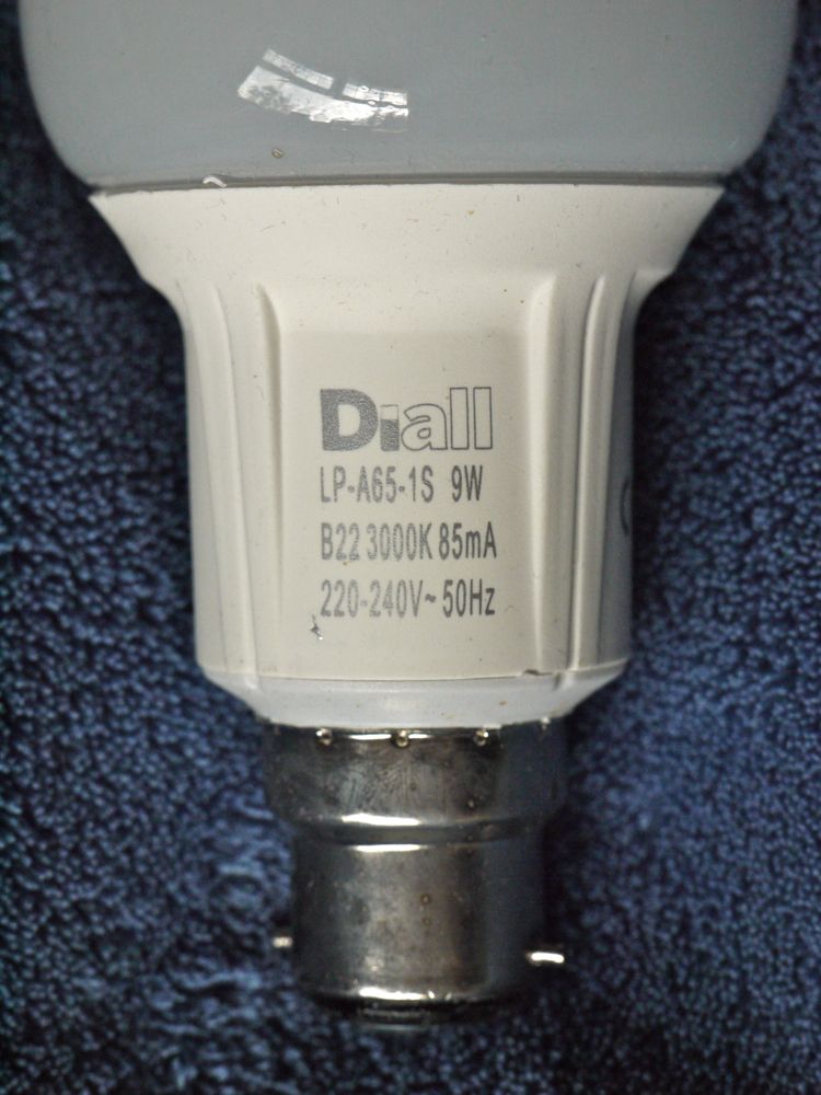

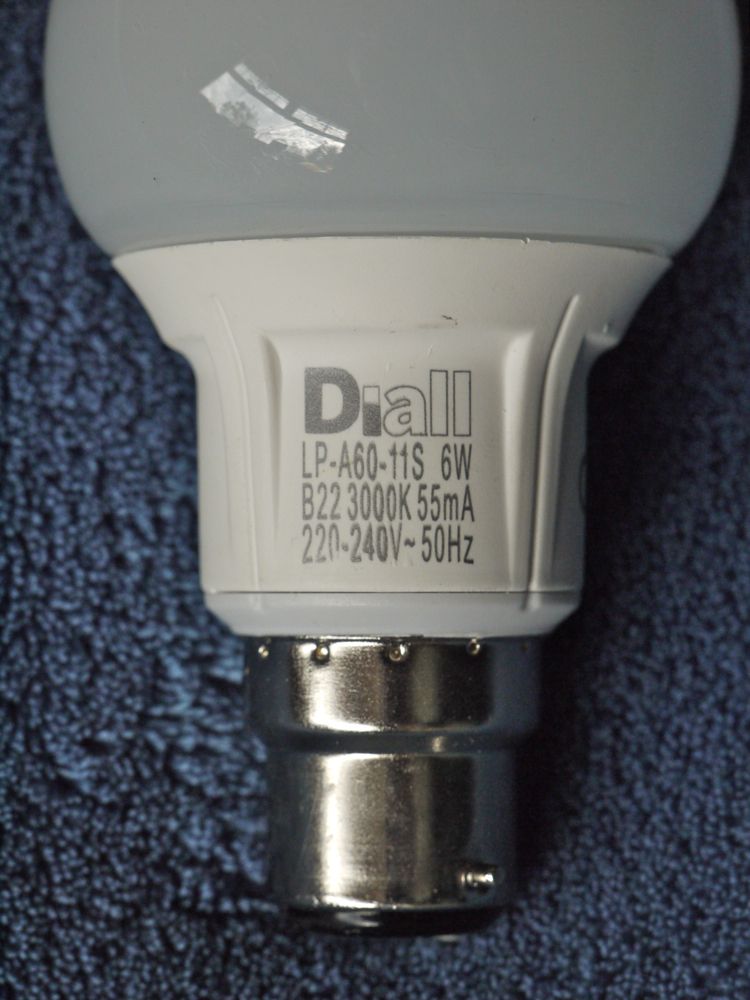

                  #165492
                    Posted by Muzzer on 03/10/2014 01:18:47:
                    Do they rate these lamps according to the input power or the LED power?.
                    Hi, Murray
                    Here are a couple of photos, showing the "rating plates" for 6W and 9W Diall bulbs.
                    … Clearly rated by input power [which is after all, what all the eco-legislation is about]

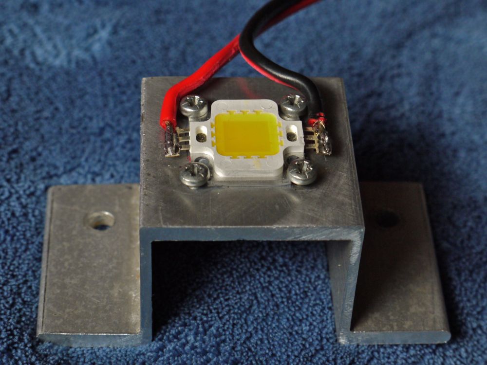

                    #165494
                      Here is a picture of my 10W LED on its Test HeatSink.
                      There is nothing special about the HeatSink design; it was just a convenient scrap of channel that will easily accept additional fins.
                      As it stands, it is woefully inadequate for this LED running at the full 10W.
                      Compare it with the size of the 9W Mains bulb and you will see why I want to know how they keep those bulbs cool. [for scale: the metal plate of the LED is about 20mm square]

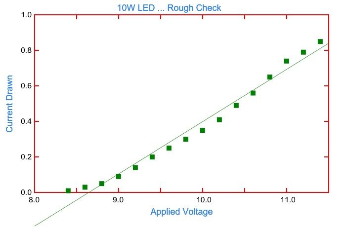

                                    For info. here is a quick check on the 10W LED pictured earlier.
                                    Applied Voltage vs Current Drawn [you can work out the Wattage for yourselves]
                                    I used two digital meters, each of which has only two decimal places; so it's fairly rough … but it shows the general characteristic.
                                    P.S.  the image was posted into my Album as a .png file [and presumably the forum software has converted it  to .jpg] … which shows that you can't believe everything you read in the intructions.
                                    Edited By Michael Gilligan on 04/10/2014 10:01:25
                                    Edited By Michael Gilligan on 04/10/2014 10:04:42
                                    Edited By Michael Gilligan on 04/10/2014 10:09:13
                                    #165550
                                      This is interesting, you can see the hint of the non-linearity as the diode starts to conduct.
                                      Ttwo examples I looked at in detail, both show (but don't mention) the interesting effect that as current increases the voltage across a green LED increases and then drops. I wonder if other colours do this is over-driven?
                                      LED I/V transfer curve
                                      #165567
                                        Posted by Neil Wyatt on 04/10/2014 10:35:03:
                                        … and also [I believe] the roll-off as the LED saturates beyond about 11v.
