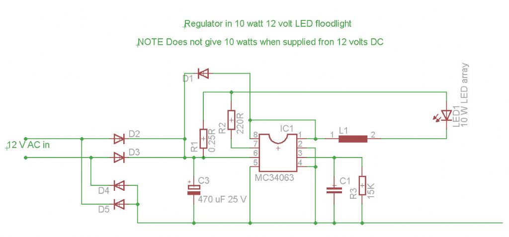

                                            This is the schematic of the driver used in the 12 volt version of 10W floodlights.
                                            I have some drivers for 3 watt lamps (3 x 1 watt in series) bought on Ebay. The circuit is the same but with changes in the component values.
                                            Les.

                                              #165100
                                                Posted by Les Jones 1 on 29/09/2014 20:01:44:
                                                Thanks for the schematic, Les

                                                #165101
                                                Les Jones 1
                                                  @lesjones1
                                                  Hi Michael,
                                                  It looks similar to the one in your link. In my photos folder "LED lighting" there is a picture of the actual fitting. I bought it in March 2013 but have not been able to identify the seller. I think it was from one of the Chinese sellers that ship from the UK.
                                                  Les.

                                                    #165104
                                                      Posted by Michael Gilligan on 29/09/2014 17:28:23:
                                                      P.S. [Wallace] Thinking about the chip inside your MR16 lamp … I suspect it's probably a Constant Current Driver [which would be particularly useful in that situation; where the LED lamp is intended as a drop-in replacement for Tungsten-Halogen] … I look forward to your disclosure of the details.
                                                      Wallace; for info …
                                                      I suspect that this [or something similar] is the additional circuitry in your MR16.
                                                      If so, then I agree that the lamp should work OK on an unregulated supply; because the Constant Current Driver will overcome the Voltage fluctuations.
