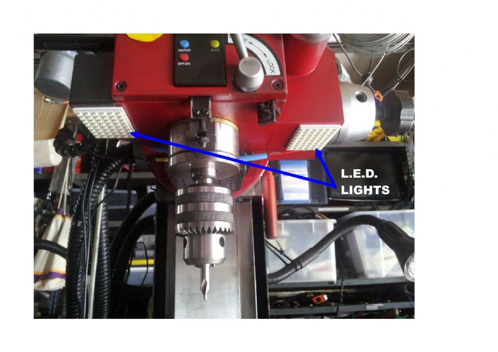

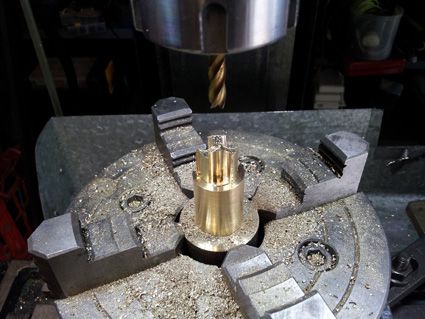

    Paul Lousick
      @paullousick59116
      These are 48 white LED panels which I have mounted on my milling machine. Bought them on e-bay for $2.59 each which included free postage from Hong Kong.
      Powered them from an old 12v plugpack. They come with double sided tape which I stuck to the underside of the mill head. (shown below iluminating work area)

        #110482
          That looks a bargain. Paul
          Thanks for posting.
          #110484
          Paul Lousick
            @paullousick59116
            Michael,
            A bargain and better than the lights which I had already added to the mill. The originals were mounted on flexible arms and mounted to the side of the column. (you can see one of them in the top photo) They originally had incandescent lamps fitted but they would not stand up to the constant vibration and quickly failed. Replacing the globes with LED's solved this but they were always getting in the way of the drill lever and the electric cables powering the drive motor. These do a much better job, there is no glare from the lights and they are directly over the work area.
            Paul.
