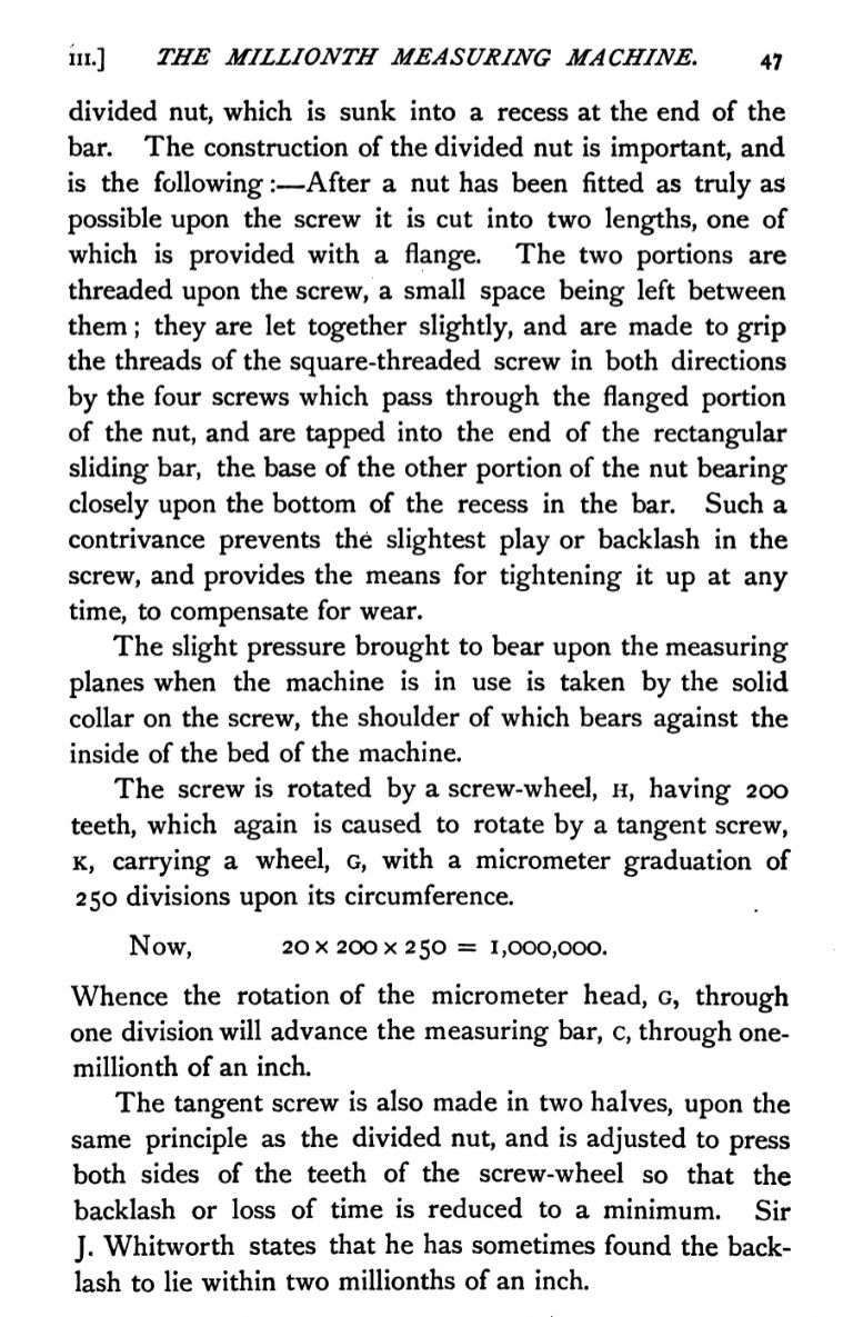

                    I've just been trying to think about the wear aspect..
                    Small nut, wears more than the leadscrew. Make the nut longer and its lasts longer (more metal to wear away) but presumably wears the leadscrew by taking the highs of the threads that are out of pitch relative to the average pitch. Once the screw high spots are worn away, the lead of the screw becomes a more consistent pitch.
                    No idea if this is what really happens but I have a vague memory of Joseph Whitworth using long nuts on early metrology equipment.

                    #485555
                      Posted by Ian P on 13/07/2020 22:33:24:
                      Posted by Michael Gilligan on 13/07/2020 21:37:31
                      The only caveat being that both the long nut and the screw will wear comparatively rapidly, if they are busy averaging-out all those variations
                      Good thinking, Ian
                      … In reality the distribution and severity of the wear will [I believe] be largely determined by the nature of the errors in the ersatz leadscrew. : Pitch variations, lumps & bumps, eccentricity, etc.
                      P.S. ___ Yes : Sir Joseph Whitworth used long nuts on his metrology equipment, but he also used very good leadscrews.
