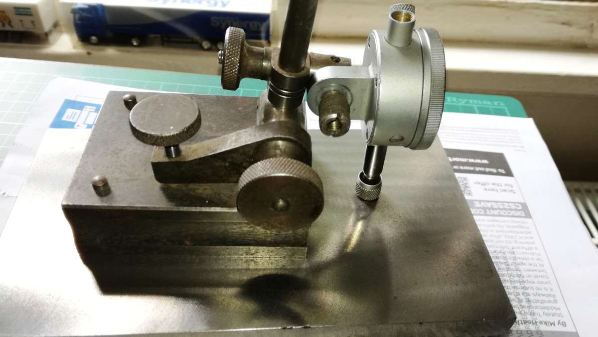

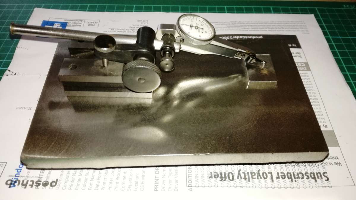

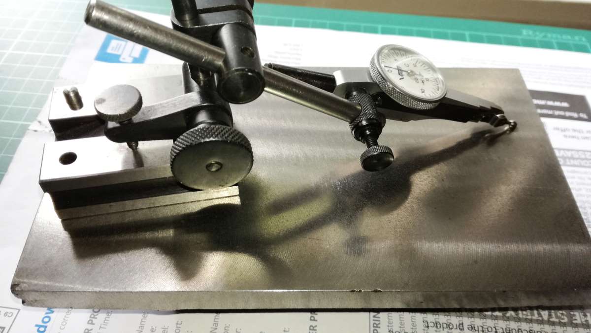

        Hi Sonic Escape, I prefer these types of surface gauges, rather than a magnetic base.
        Surface Guage 1
        Surface Guage 2
        Regards Nick.

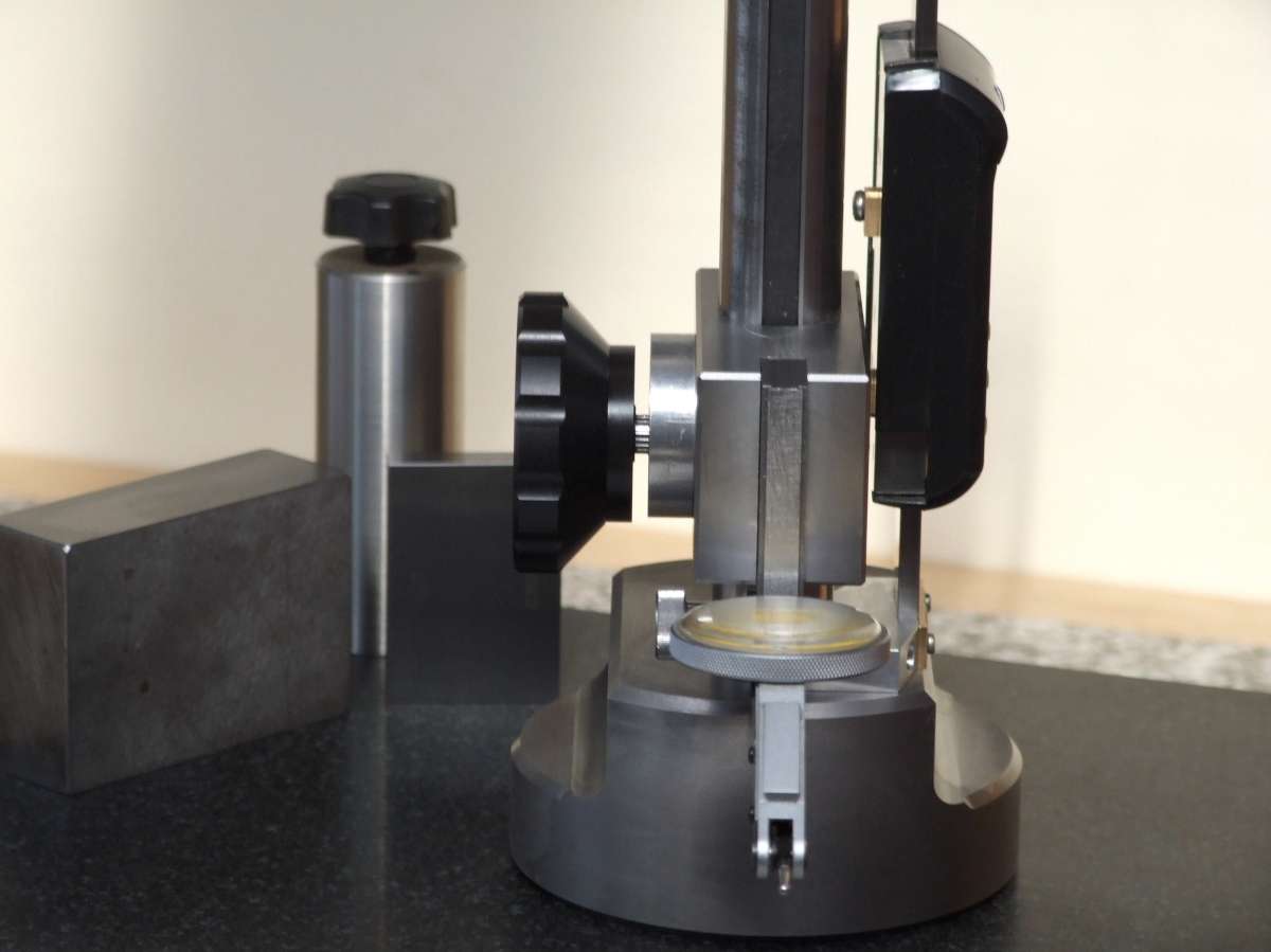

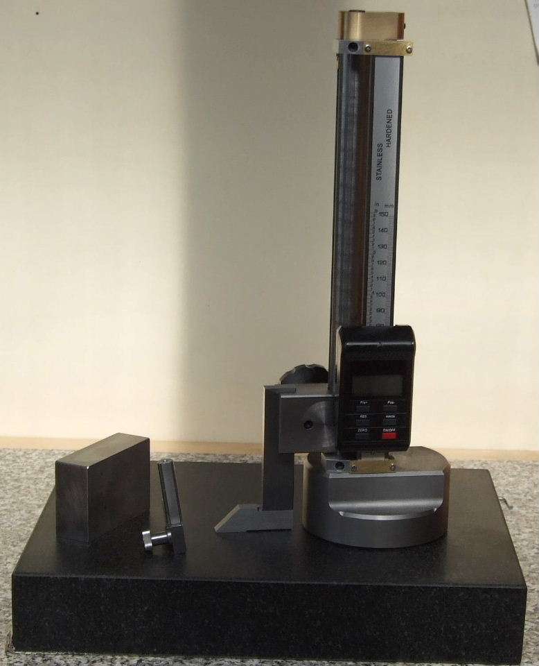

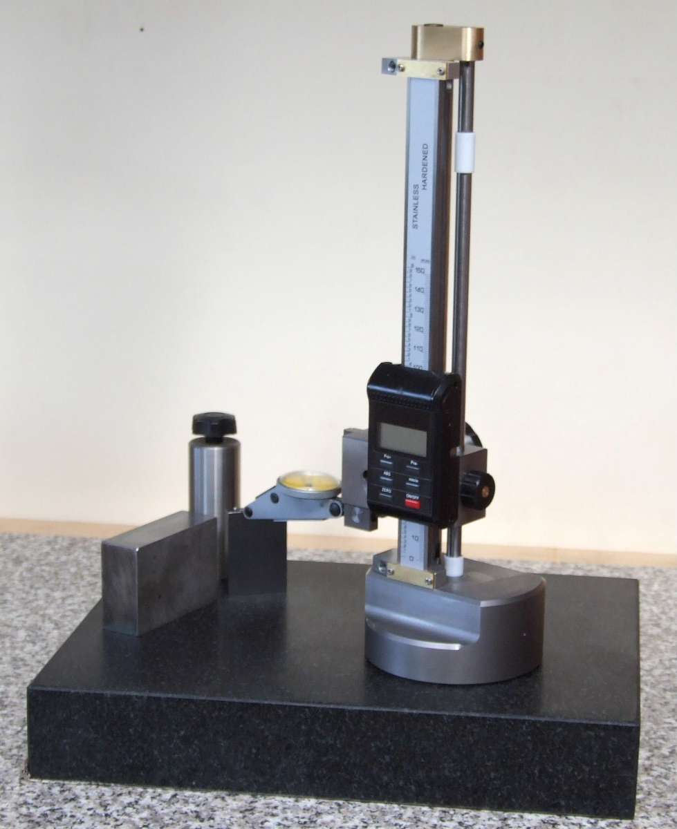

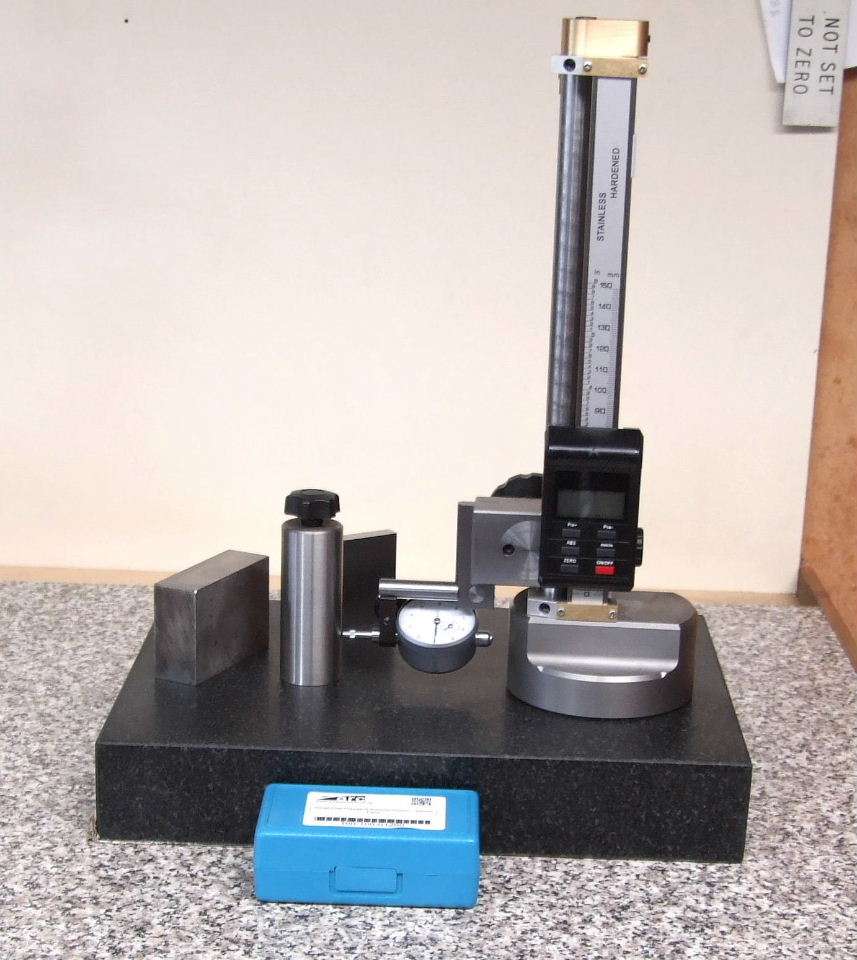

            My first Surface plate was a Glass Platen from a Photo-copier. This was mounted on a board with a felt, baize layer beneath it and edged with wooden narrow beading strips. When not in use it was stored up on edge next to the bench out of harms way.
            As regards a Surface gauge I use mostly a Starrett Scribing block. That is until I use my 0,02 mm per division clock when this gauge struggles to give repeatable readings.
            Checking the Roller setting
            Then I use the Multi-purpose Clock stand I made some while ago.
            The Clock that started it all
            This has the advantage that it can be used to check verticals as well as flat items.
            Perpendicularity Check
            It also doubles as a height gauge thanks to Ketan.
            Scriber in place
            The handwheel provides a fine and a coarse adjustment just by pulling the handwheel out or pushing it in.
            Direct Drive Knob position
            Or
            Reduction Drive 4 to 1
            Regards

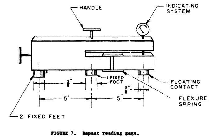

                  The correct instrument for simple checks of a surface plate is a Repeat Reading Gauge A.K.A Repeatometer.
                  American Federal standard GGG-P-463C (google it) has details of proceedure and gauge
                  This alows direct comparisons between plates with different gauges.
                  Robert.

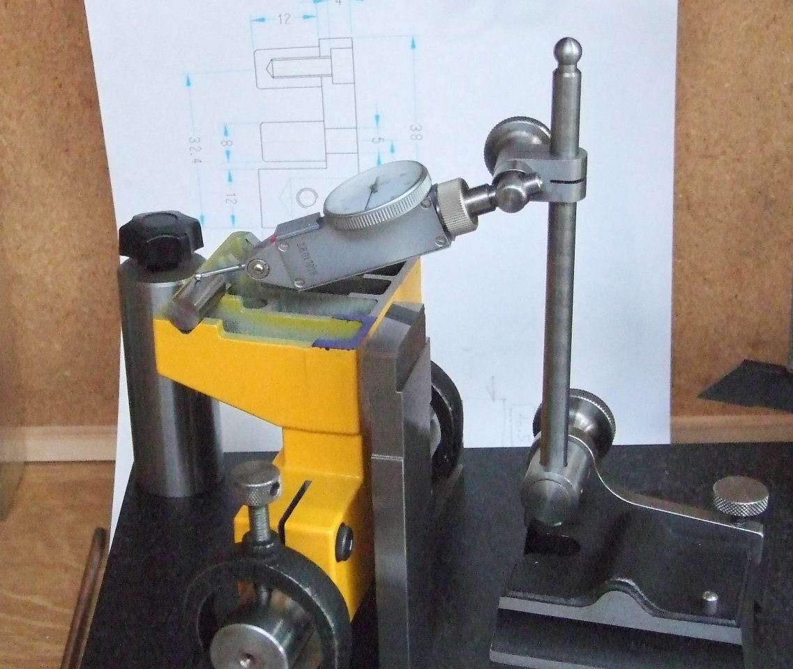

                        Nicholas Farr
                          @nicholasfarr14254

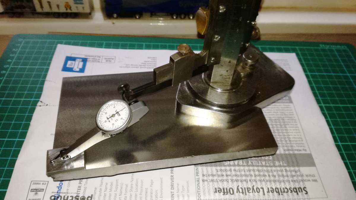

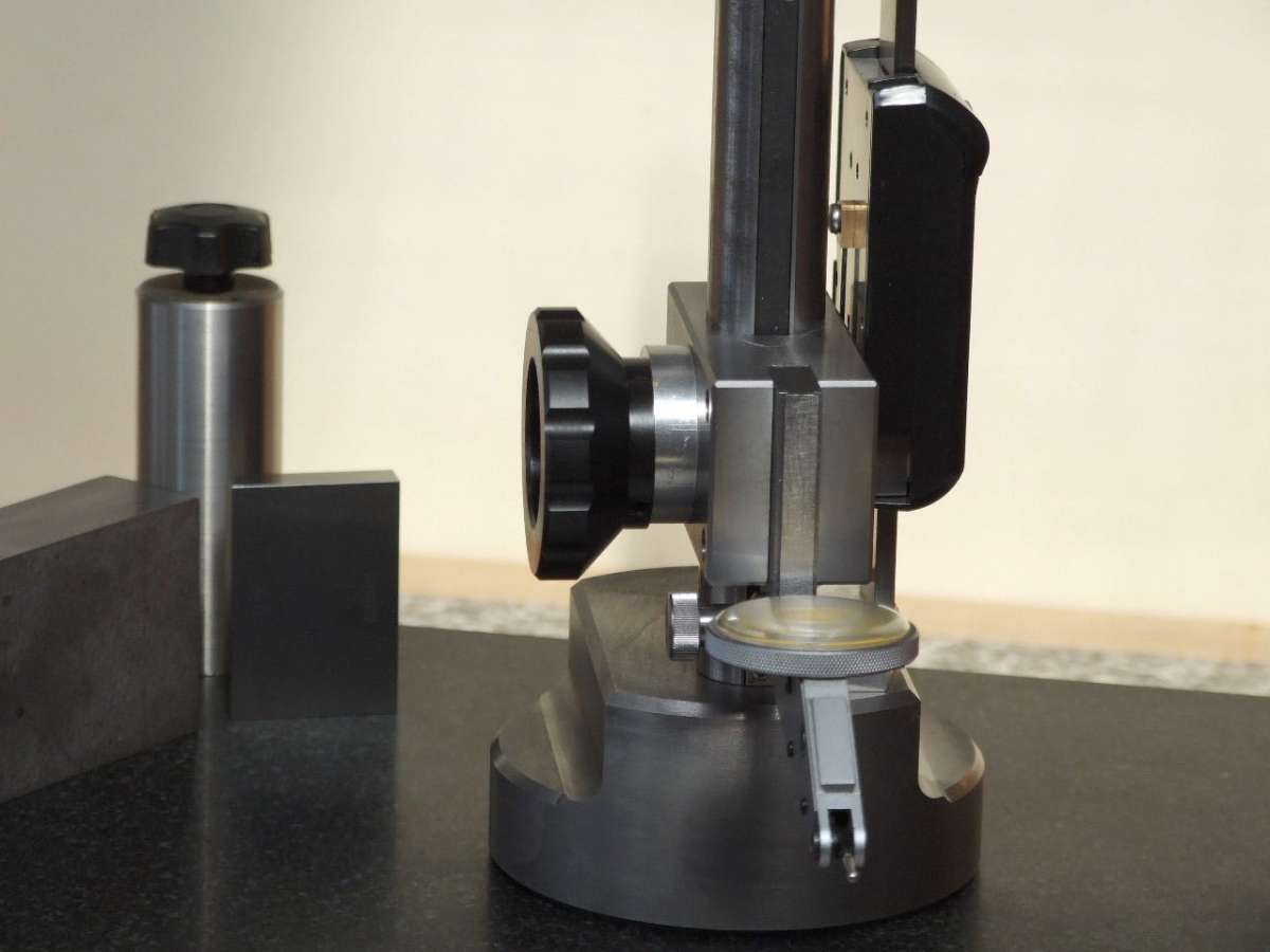

                          Hi, I can use my Chesterman height gauge with my DTI, but it’s a bit OTT for my little table.
                          Surface Guage 3
                          However, my small surface gauge block, can be configured to low profile.
                          Surface Guage 4
                          Regards Nick.

                              Clearly, I’m not the only one with a VHG that can be too large for a small plate.  The small surface gauge here looks similar to one I bought from Tracy Tools for around £12.00.  Maybe not a Starrett, but excellent for the price (or was I just lucky?).  Some fettling with a stone to smooth the sharp edges and it works as expected.

                                  That standard was used because it has details of the measurement device which is the same for all plate types.
                                  The standard for cast iron plates, GGG-P-453A does not include details of the gauge.

                                    The key difference between a repeat-o-meter and a marking out base or height indicator is that it has 3 defined points of contact rather than a flat base. Tne classic amicrian design is 3/8″ diamleter “feet with the single being spaced 5″ from the pair. The moving measurement contact is also 3/8″ and spaced 5” from the single foot.
