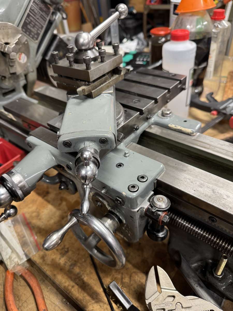

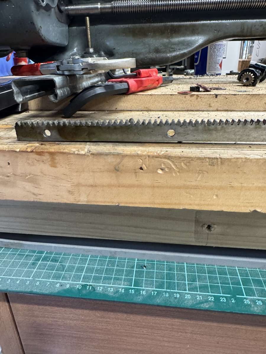

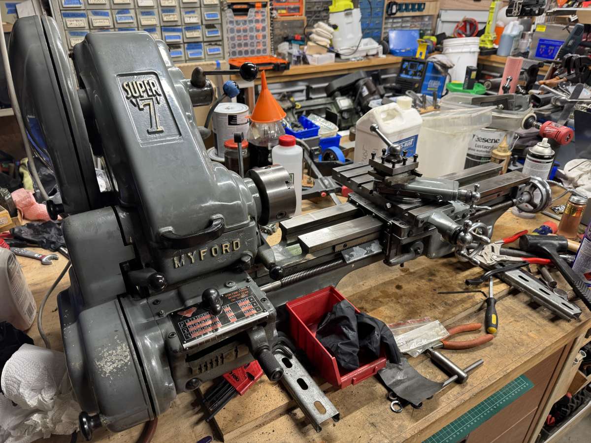

                Hi again Howard – you were right of course, I have taken a silky smooth, but filth dirty machine and made it much cleaner, but also much less smooth! 🙁 I don’t think I have broken anything, and I was very careful to put everything back just the way it came to pieces, but the gibs etc have clearly been tuned by an expert and so now I have tight spots… oh well, I had to learn the hard way ;/ Thank you and to Nigel and many others who have confirmed that I have an imperial machine – alas! DRO’s for me….
                The cleaning has also damaged the paint work in some places but I couldn’t live with the dirt, so I guess a repaint is also in my future… (ignore the 4 way post, that is a WIP), also check out the bend in my carriage rack! This is where the tight spots are coming from I guess…
