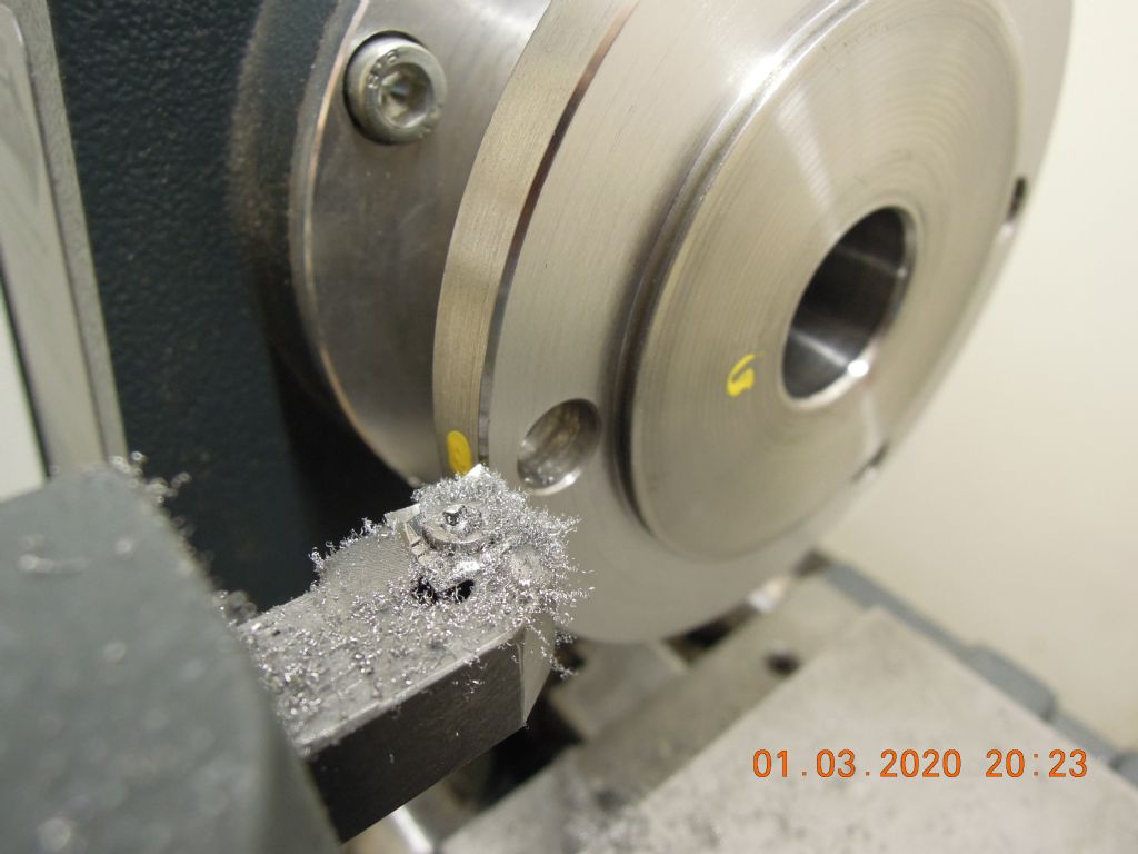

      Here's a question I haven't seen asked before. Today I was just trueing up both sides of a faceplate and marking it so I can mount it in the same rotational orientation next time I fit it. But would it not be a little more sensible to skim the spindle flange face before trueing the faceplate ?
      The lathe came with a certificate indicating its spindle flange face runout. (I cant recall the figure now but it was probably in the order of 5um or so.) This figure will be an accumulation of several things: basic machining errors on the spindle, runouts in the bearings and runouts from assembly error. These are maintained unless the spindle is dismantled and rebuilt slightly differently. So providing I don't dismantle the spindle, by skimming the spindle's face I can remove all of these errors and reduce the measurable face runout to nominally zero. This can only improve the runout and wobble on any subsequently fitted part such as a chuck, and remove the need to orientate the fitments, cant it ? And if so, why wouldn't a manufacturer do it ?
      Perhaps I'm missing something ?
      Gerry.

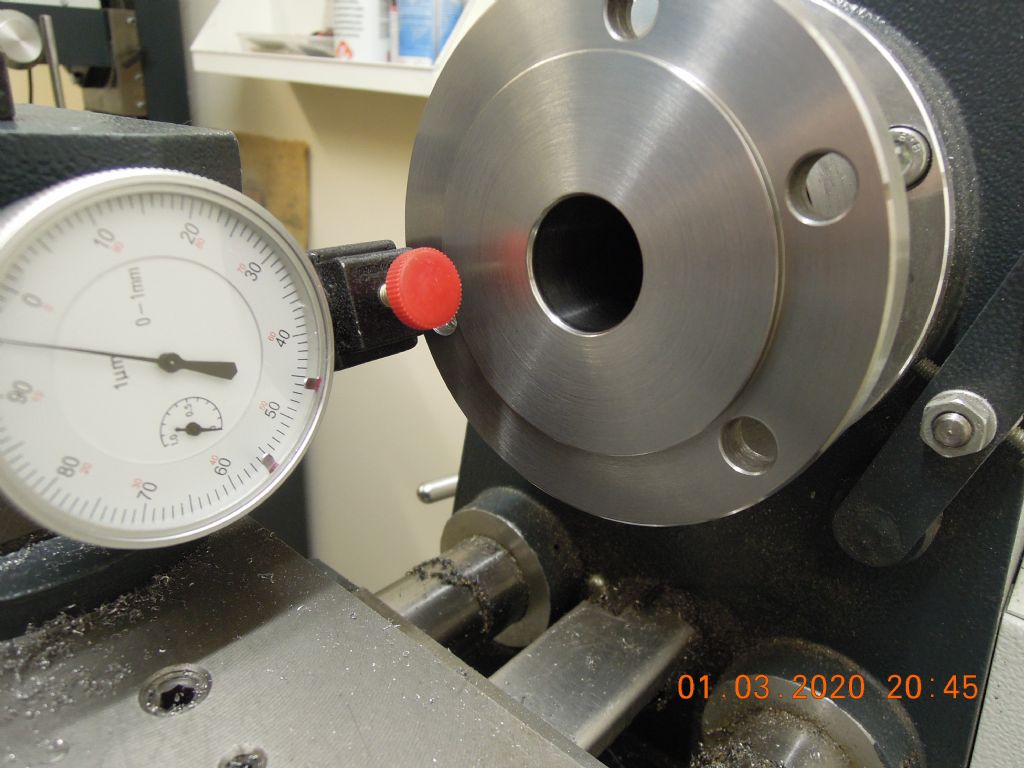

                          Thanks all for your comments. I have to admit to having a bit of a thing about precision so I would have probably given it a go anyway . I did however try to measure the actual runout first but that wasn't that particularly successful due to pretty poor surface finish on the flange. But overall it looked to be about 5um including the chatter. So I proceeded to make a very light cut starting on the bolt pcd then moving in and out to cover the whole flange. Considering the lightness of the cut I expected to see areas appearing that were not cleaned up. But there weren't any, which suggested that either the depth of my 'fine' cut was of the same order as the runout (or far bigger of course!). Anyway here was the result:-
                          The intermittent cut from the bolt holes wasn't detectable at all and I was careful not to touch the spigot diameter. The 0.2 rad on the tip appeared to match the existing one quite well too. I then tried to remeasure the flange runout like this:-
                          …and guess what…. it wasn't much better than it was before despite the significantly improved surface finish. What I could see though was that the runout was absolutely not synchronised with the rotation of the spindle. So there are literally other forces at play here – possibly variations in drive belts or drive train making the spindle do strange things.
                          Well no harm done and a few things leaned. A good way to finish a wet Sunday.
                          Gerry.

                                  Hi Hopper, thanks for your comment.
                                  The spindle bearings are fine. They are taper rollers and positively preloaded. With the spindle stationary, using the micron DI its easy to see the elastic deflection as one pushes and pulls the spindle axially. Rough estimate was that the deflections are about 2um/Kgf in both directions and it returns exactly to the centre position when unloaded which confirms no clearance in the assembly.
                                  That's deflection figure is probably a bit too compliant for TRs so I suspect that a good part of that elastic deflection is deflection in the aluminium structure walls in which they are mounted.
                                  Absolutely agree on the elephants foot. I didn't think of that ! Will give it a try later.

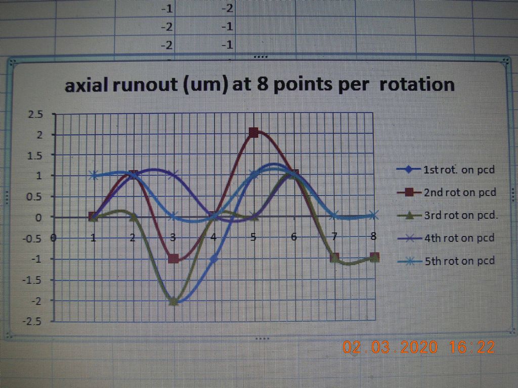

                                                Nigel B – you are absolutely right. NRR or non repetitive runout is often caused by rolling element size differences or shape errors. Its non repetitive because their own rotational speed relative to the raceway surfaces, and their speed around the bearing is not synchronised with the ring rotations. so they can produce almost random-like motion in the rotating shafts. NRR used to be a big challenge on computer hard-drive spindle brgs where precision was all, but I have never heard of it being and issue in big brgs before. Good to hear about your case.

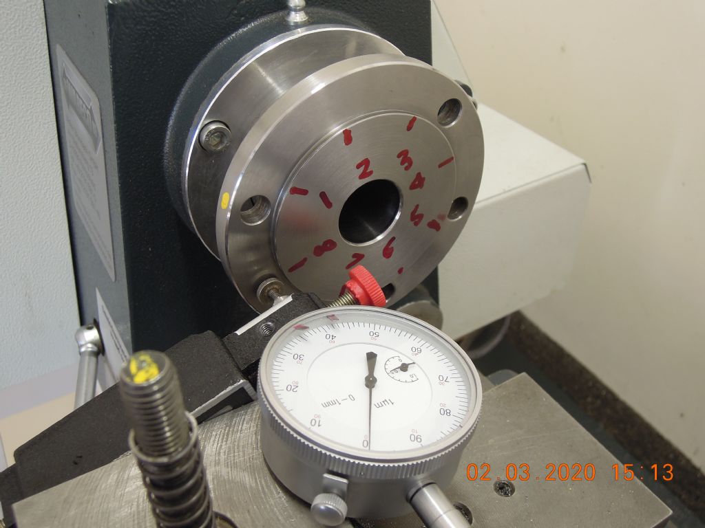

                                                I have just rechecked my spindle face axial runout with the 'Hoppers Elephants foot' and it has really cleaned things up. Here's the set up:-
                                                And here's the results:-
                                                The spindle was turned by hand and the DI was pulled back to go over the bolt holes. I was careful not to touch the slides, (which I forgot to lock down anyway!)
                                                There is an obvious underlying runout but there is also clearly a non-repeating element to the figures of around half the magnitude of the fundamental. As was suggested by Michael G, with a very fine and slow grind, one could remove another micron or two from the repetitive runout but there is no simple way of removing the non-repititve part without improving almost every other part of the machine. Its difficult to say precisely what's causing the NRR but the main contributors have to be the drive train and bearings
                                                When I got the machine the belts (6 ribbed poly-vee) had a pronounced sets moulded in and these caused an audible bump every time they hit one of the pulleys. So I sliced the belts into two 3-ribbed pieces and staggered the moulding inconsistencies. This really reduced the noise and although I didnt think of it at the time must have helped the true running of the spindle. Perhaps there are some better belts available which wont cost an arm and a leg. Of course runouts in the pulleys themselves will cause load variation too.
                                                As for the bearings, these are just standard precision eastern European taper roller type. There is no point in using a better quality product as I already know the housings are quite poorly machined. It makes no sense to put a good bearing in a rubbish housing because the geometric errors just get carried through to the raceways. I have actually wondered about replacing the TRs will ball bearings as a simple "upgrade". I know some people will frown at this say that its going the wrong way, but the advantage here would be that because the balls are more compliant they will absorb some of the geometric irregularities instead of passing them straight in to the spindle.
                                                I'm certainly not going to be short of things to do when retirement arrives, that's for sure ! But for now I think I've just about done as much as I can with the spindle on this bag of old nails, short of speeding real money.
                                                Gerry

                                                  4 microns tir is an excellent result, when a chuck is fitted, the results will multiply 10 to 20 fold, so chasing that tiny amount already present is a total waste of time.
