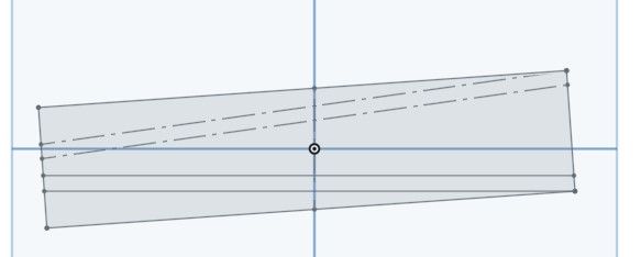

                      Chris, If I've understood your question correctly, the diagram below might help..
                      The angled rectangle is the bar in a chuck which leans away from the operator. Left hand side is the chuck end. Note that the chuck is in line with the spindle and the bar rotates around its axis.
                      the bottom horizontal lines represent the travel of the cutter. the lower one is the outside, then inner the bore.
                      The dotted lines are what the travel would be on the other side of the bar..It's a bit hard to see, but if you tilt your head so that the bar is horizontal you will see what I mean.
                      Thus the part near the chuck is narrower (inside and out) than the end.
                      Hope that makes sense!

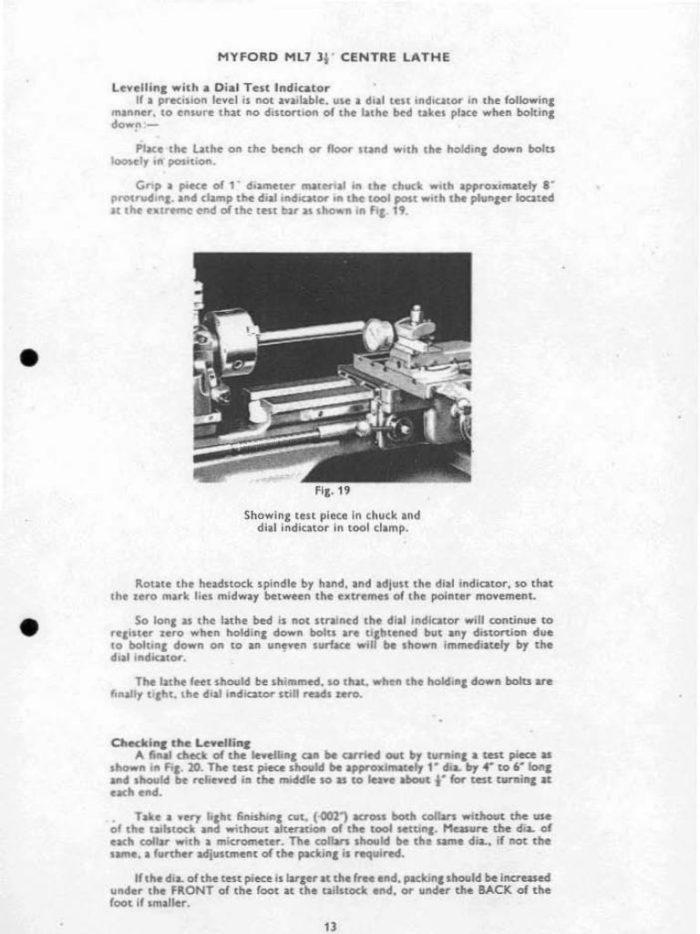

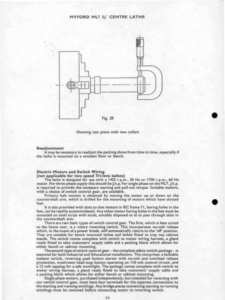

                          #648190
                          Hopper
                            @hopper
                            If you are going to bolt it down to a solid steel base as per the video, you might be best off to set it to turn parallel as he did by shimming the tailstock feet to get it to turn parallel. Standard procedure on many lathes, including Myfords. See Myford manual pages below. See the bottom of the first page. Saves risking doing irreparable harm to the headstock mounting.

                              Hopper
                                @hopper
                                Posted by Iain Downs on 11/06/2023 16:22:50:
                                Hi, Hopper. I tried lifting the corners of the splash tray on which the lathe is bolted, which should have had the effect of twisting the bed – at least a little. In fact this had little effect on the alignment.
                                As flexible as the bed appears to be in the video above, I would expect a splash tray would flex before the bed would.

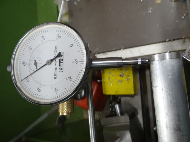

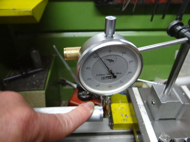

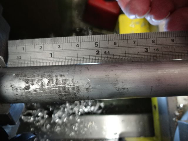

                                  Posted by Iain Downs on 11/06/2023 12:43:53:
                                  As the deviation is about 0.03 over 50mm …
                                  Just a thought, but have you confirmed the pipe isn't bending under cutting pressure? Long jobs bend most when cutting furthest from the chuck where the cutter tends to remove less metal than the lathe dial suggests. The dial is more likely to be right close to the chuck where the job is well-supported.
                                  In this demo, I bent a 150 long length of ⌀20mm solid aluminium rod 0.08mm off-axis just by pushing it hard with my finger:
                                  A cutter driven in by the cross-side screw is much more forceful. I managed to bend the rod nearly 3mm off-axis before getting scared I might damage the nut:
                                  Not a good picture next – I couldn't hold the rule and camera accurately enough to highlight the whole curve. But laying a rule along the rod with a light underneath shows the rod is bent:
                                  I notice work starts to bend when turning anything more than about 3x diameter long beyond the jaws, worse when taking heavy cuts with carbide. Anything over 6x diameter in length is likely to bend under its own weight and has to be supported – tailstock, steady or lump of wood.

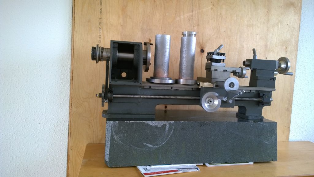

                                      All my lathes have been put solidly (bolted to) a solid foundation before I started to worry about accuracy

                                        When I got my 330 Lathe new, it came with a metal stand not Cast Iron, and was given advice to lift it like 200mm.
                                        So when I did that I thought it a good idea to fit a heavy 90Kg 12mm metal plate between lahe and tray which sits on stand and bolt all together. I understand that doing that you might or will twist the bed unless this plate is grinded 100% on all sides parrallel.
                                        I proved that I can shift the taper cut from chuck side to tailstock side depending on where I shim the tailstock end of the bed. After much effort I got it to cut straight on very light cuts unconnected to tailstock, however this did not stay put over time. Before test cutting I made sure it was squared in chuck at least by measuring runout near and far form chuck.
                                        What I did not do so far was to mount the lathe on rubber mounts instead, so the bed will reflect the factory gring quality in cutting.
                                        About twisting the bed, I am just not sure how accurate this twist method overall is to a fit grinded job in theory if that is even possible, probably only on sturdy sections like on large expensive latghes with cast iron bases, but even they are "twisted" by feet adjustment. Maybe grinding it to accuracy is the last step.

                                          Hopper
                                            @hopper
                                            Posted by Chris Mate on 11/06/2023 19:43:36:
                                            Edited By Chris Mate on 11/06/2023 19:44:41
                                            As the video posted above shows, the minilathe bed is about as flexible as a wet noodle if not bolted down to a solid base. But 12mm flat plate can be quite flexible, by precision engineering standards, especially if perched on top of the type of sheet metal cabinet supplied with many lathes. A stout box construction of square tube or angle iron is more solid than flat plate.
                                            The trick to bolting down a lathe to a solid base, which seems to be universally forgotten, is shown in the Myford manual pages above. You don't surface grind the bench or base to be flat, You measure any gaps when the lathe is sitting loose on the base and insert shims so you don't distort the lathe when tightening the bolts.
                                            I think if Myford recommends using shimming the bed feet to achieve parallel turning, you can rely on their hundred years or so in the lathe manufacturing business
                                            I have to say I am astonished at how flexible the minilathe bed is in this video, as measured with a DTI.

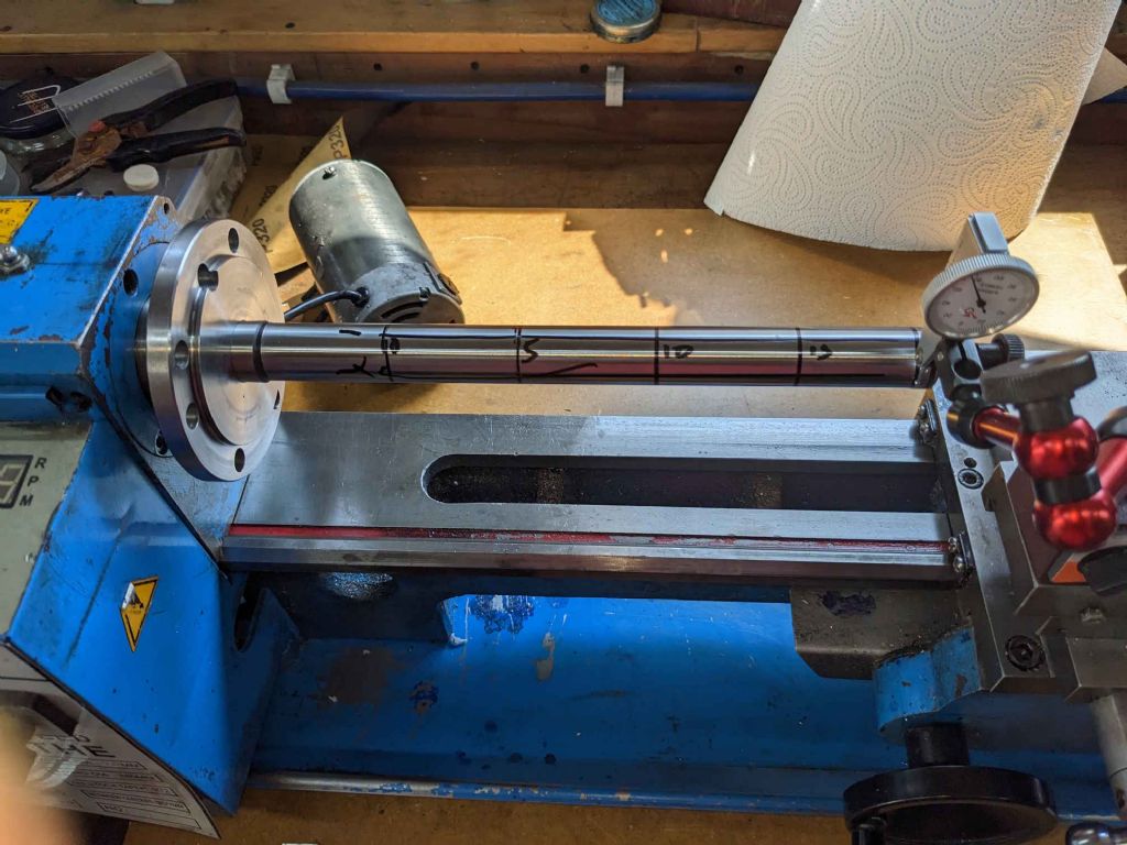

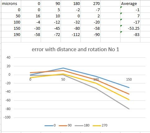

                                                I decided that a bit of measurement was in order.
                                                I put my test bar in the spindle and marked rings at 50mm intervals and lines lengthwise at roughly 90 degrees. the bar is consistent diameter through the measured area within a couple of microns.
                                                The picture below is the test set up.
                                                I took care to set up the indicator (a 2 micron jobbie from China) in line with a centre in the spindle first.
                                                Here is a snapshot of the results. Note that I repeated this twice with the test bar in different positions and each time ran through the measurements twice – the results were not identical, but were reasonably consistent.
                                                you will see that the spindle appears to move away and then towards the indicator with a maximum error (on average) of 83 microns 150mm down the bar. I can only assume that this is due to a twisted bed, something I'm not in a position to fix at the moment.
                                                This does seem to show that the average error is now under 20 microns (< one thou) for the first 100mm, which is reasonable.
                                                I'd be interested to get input from anyone who is better equipped to interpret this data – I certainly am not!

                                                  Posted by Iain Downs on 12/06/2023 16:43:49:
                                                  […] you will see that the spindle appears to move away and then towards the indicator with a maximum error (on average) of 83 microns 150mm down the bar. […]
                                                  Good thinking yes
                                                  I’m happy to be wrong, but … My first instinct is that the bar should be sagging under its own weight, and therefore your figures need to be inverted.
                                                  The ‘bump’ at the beginning is a bit odd, but it’s small enough to possibly be an indicator error
                                                  … alternatively; if it’s real, then I would be checking the fit of the Morse Taper rather carefully.
                                                  Edit: __ Apologies: What I wrote may be nonsense … I’ve just realised that you were using a lever indicator on the [presumed] centre-height of the bar, not a plunger measuring vertically.
                                                  Your arrangement could complicate the geometry somewhat. blush
                                                  Edited By Michael Gilligan on 12/06/2023 18:05:49

                                                    Huub
                                                      @huub
                                                      The bump in the measurements could indicate wear (not worn) of the lathe bed. It can also indicate that the gibs are to tight or a combination of both.
                                                      Measure once moving the carriage from left to right and once moving from right to left. If you find similar results, the gibs are not to tight.
                                                      20 microns/100 mm isn't bad for a "stock" mini lathe. Beware, it would mean 0.04 mm in turned diameter. If you are happy with these results, than all is OK.
                                                      If you have a chuck mounted, the first 40 mm of the lathe bed aren't used. So it is to be expected that this part of the lathe bed is in mint condition.
                                                      This is how I measure the headstock alignment with the chuck in place:
                                                      Measuring headstock alignment
