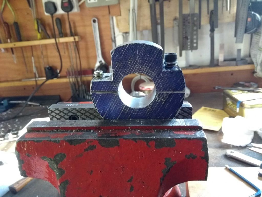

      As practice I decided to use my micron indicator with a slide I've made to ensure alignment was spot on.
      The original intent of the exercise was to see if I could use the outside of the collets to align the topslide to skim the collet chuck spindle. I've not quite got there, but some interesting results along the way.

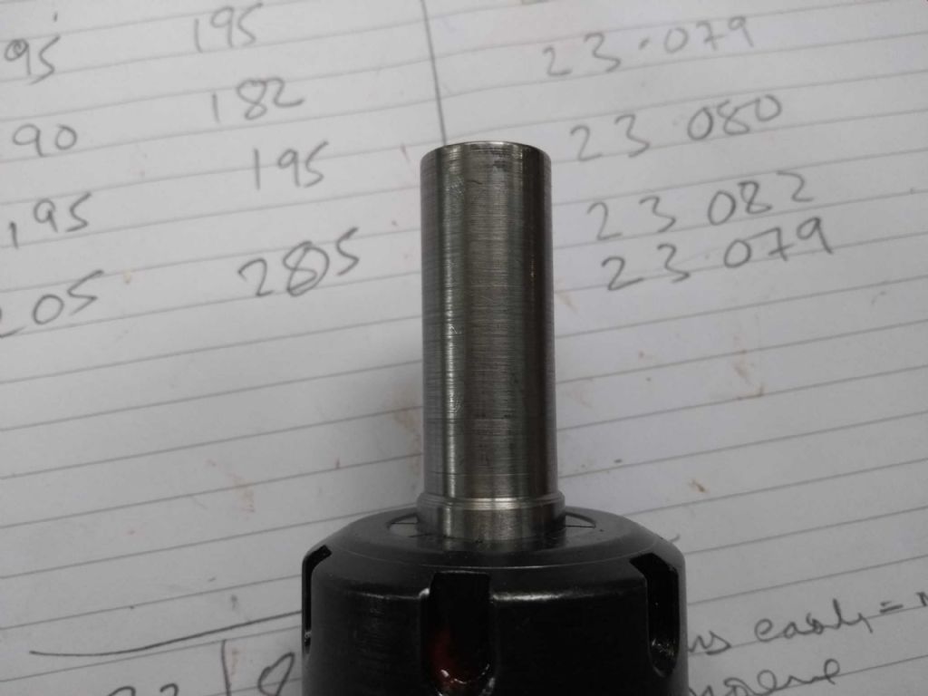

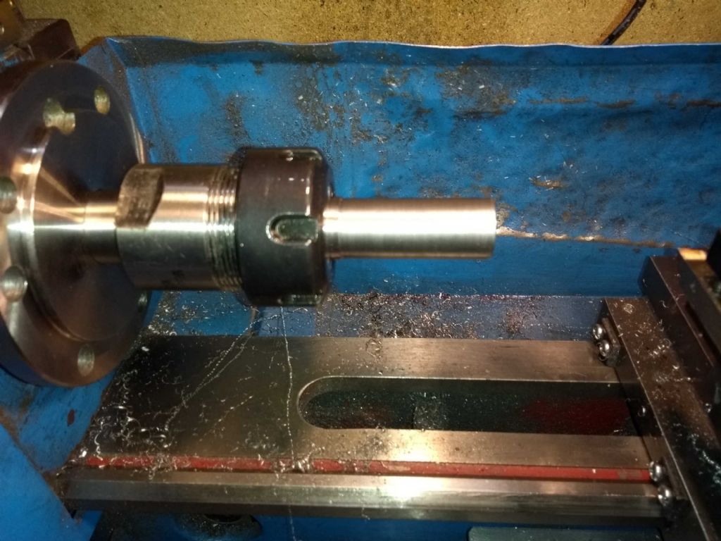

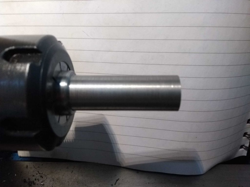

      This is the set up with a 20mm silver steel bar mounted in the collet chuck and then turned down to 18mm.
      The first thing I checked was the straightness of the bar.
      To do this, I set up my indicator and adjusted the height to get the centre of the bar.
      This isn't a good photo actually as it shows a cylinder connecting the indicator to the slide. This reduced rigidity and I removed it for the actual measurements.
      I measured the 'indent' (the depth the indicator was measuring) at 5mm intervals along the bar with the indicator and also took measurements of the diameter with a micron precision digital Micrometer.
      Naturally, I took several sets of readings and found them to be surprisingly consistent (3 sets of indents, with a maximum spread of 8 microns, the micrometer was consistent within 2).

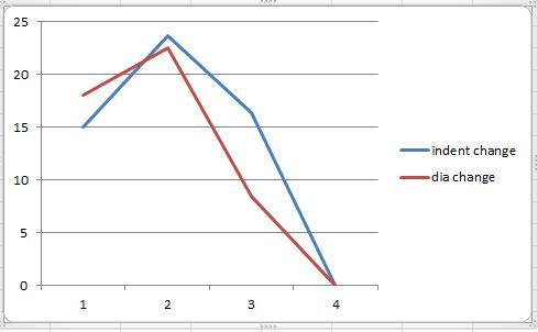

      Here is a graph of the delta along the bar (the end of the bar at the start of the graph)
      I think that the initial rise is because I took an extra cut on the first section of the bar, but for the rest it shows the bar being narrower near the chuck.
      What's less clear is why the indent and the diameter are about the same. I would expect the diameter to have twice the variance of the indent. I have no explanation for this.
      The bar was pretty round. Hard to tell how round because the roughness was significant, but to within a few microns (say 5).

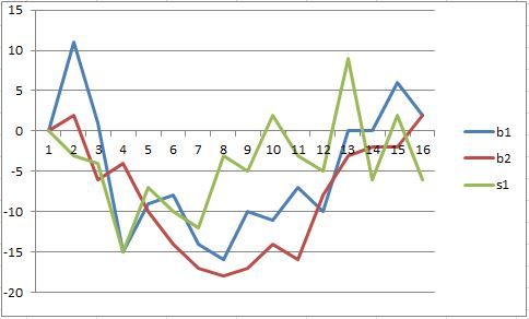

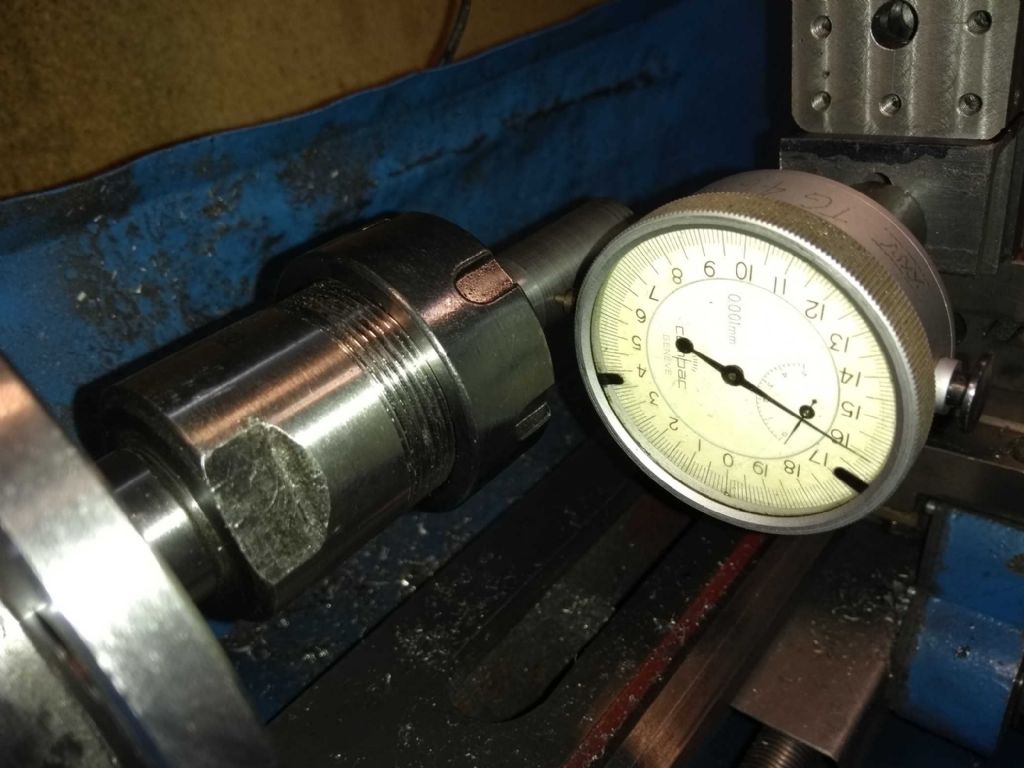

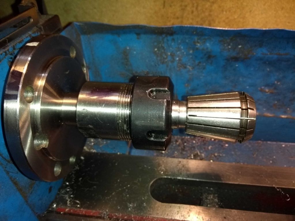

      Next I set up the collet and measure the indent between each slit at the inner and outer edge of the taper.
      Incidentally, when I took a measurement, I would pull the lever out with the button on the indicator, move the piece and gently allow the lever to touch down. If I wasn't careful, I would move the cross slide which has about 0.1mm of backlash, rather ruining the accuracy!
      In this case, pleasingly, the 16th reading was close to the first – within a few microns, so I reckon I wasn't jarring it too much.
      This is a graph of my findings. B1 and B2 were the thick end and S1 the thin end.
      Again relative movements in microns.
      What this seems to show is that the collet is offset from the centre by something like 15 – 20 microns ( a bit under a thou), but that there is a skew on it – that is the peaks for the thin end don't coincide with the peaks at the thick end. I'd attempted to deburr the collet prior to the measurements.
      What I did notice though is that even a small pressure on the bar caused quite a bit of deflection.
      I put the indicator near the end of the bar and a luggage weigher next to it. Applying 1kg of force would generate a 20 micron deflection and 2kg around twice that. Beyond 2kg there wasn't much more movement.
      This led me to wonder if I've not settled the spindle in correctly. I replaced it a while back with Tapered roller bearings and a great deal of trouble with pressing the bearings into place. They were VERY VERY stiff fits in the headstock.
      My thinking is that the deflection could be a cause for the taper on the mandrel. if it was being pushed off by a thou at the far end by the force of the cutter, that would create a taper.
      Can any one comment on this? Also, if this is likely to be the case, how can I improve it? I have tried to tighten up the nuts on the back end of the spindle, but they really are tight and I guess I'm afraid to provide too much force.

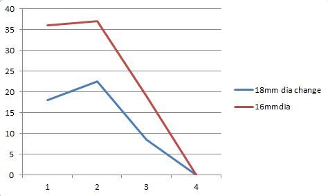

            I think turned my test piece (back to the bar in the ER32 collet) down to about 16mm (2mm reduction). in this case I was careful to do full passes from the end to the headstock, particularly with the final cut. I required 4 passes for the tool to stop removing material.
            The good news is that the finish was better this time, though I can't be sure it wasn't me being better.
            Quality at 18mm (before adjustment)
            Quality at 16mm after adjustment
            I was still seeing a lot of movement (1 – 2 thou) on the bar or on a chuck with moderate pressure – this didn't seem to have got better.
            Also, I still see the same decrease in diameter towards the chuck – this time even more, which surprised me.align 18mm16mm dia.jpg

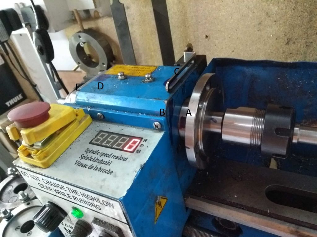

            So today I ran some temperature tests. I measured them at 5 points on the lather.
            The black marks show a location on the spindle, 3 on the headstock and there's one on the rear of the spindly you can't see (E). I only measured these last two later on in the test.
            Broadly, they all started off around 27 degrees (nice day, wasn't it!). I ran at 500 for five mins, 1500 for 10 mins and 2000 for 15 mins.
            By the end I had
            A – Spindle: 33
            B – front of headstock 40
            C – front top of headstock 39
            D – rear top of headstock 44
            E – rear spindle 41
            From what I've read in the link I should be able to see 10 – 15 degrees more than this without unduly worrying about the temprature.
            what concerns me is that the rear bearing seems to be hotter than the front one. This supports my concern that the inner race isn't moving freely on the spindle so isn't getting the pre-load.
            I really don't know what to do next. I've made an extension to my spanner so I now have 2 feet of leverage not 4 inches, but this won't do any good if the front bearing isn't benefiting.
            Any advice or experiences welcome.

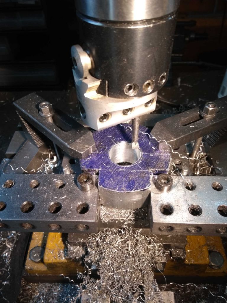

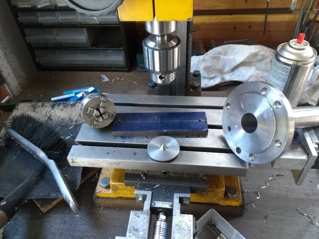

                          I'm thinking I might try and make a spindle polisher with my micro mill.
                          I have a 4 jaw non-independant chuck on an MT2 spindle which will hold the back end of the spindle and I'm thinking of making a very short centre to slot into the other end of the spindle. That will engage in a centre drilled hole in a shallow bar on the mill bed.
                          I have the old spindle and with a bit of luck it might just fit.
                          he idea was to turn a spindle on the end of a short piece of bar which would exactly fit in the spindle, together with a threaded hole. Turn it round, put the spigot in the spindle, tighten in place with the bar and turn a center on it. The idea is to have no more than a bout 10mm from the spindle face to the point of the centre.
                          My first attempt at this has not been too grand. I cut a spigot in a piece of 50mm bar which very nicely fitted in the end of the old spindle. The new spindle unfortunately has a narrower aperture, so back on with the chuck and cut. Unfortunately too much, so the damned thing rattles and is easily offset with an over firm cut. So I think I will have to start again and be a bit more patient with the cutting and chuck swapping. Needless to say if I if I take the piece out of the chuck, the chuck off and replace the chuck and piece, the chance of it being centred is slim. I will consider my 4 jaw for this, though I can see a certain amount of frustration ahead of me.
                          In the meantime, it's time for a cuppa and some dinner. Not sure if I'll get back to it this afternoon – we're off out for tea a bit later – and there's only so far my patience will stretch in a given day!.
                          Iain

                            Rightio.

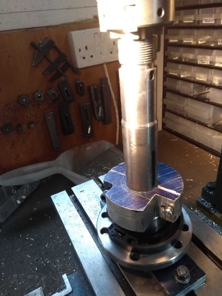

                            The plan was to remove the spindle from the lathe and mount it in the mill with the unholy collection of components shown below.
                            Underneath the bit at the front with the cone is a spigot which fits nicely into the spindle throat. The top end of the spindle gets gripped by the 4 jaw in the mill spindle. the bottom end slots into the coney thing and the cone sits in a centre drilled hole in the marked up plate which is bolted to the mill. Once I drill the centre it's going to be difficult to do anything else with the mill until the work is finished so that's the last thing to do. As the spindle rotates some (probably) 1000 grit will take a little bit of the surface enabling a better fit.

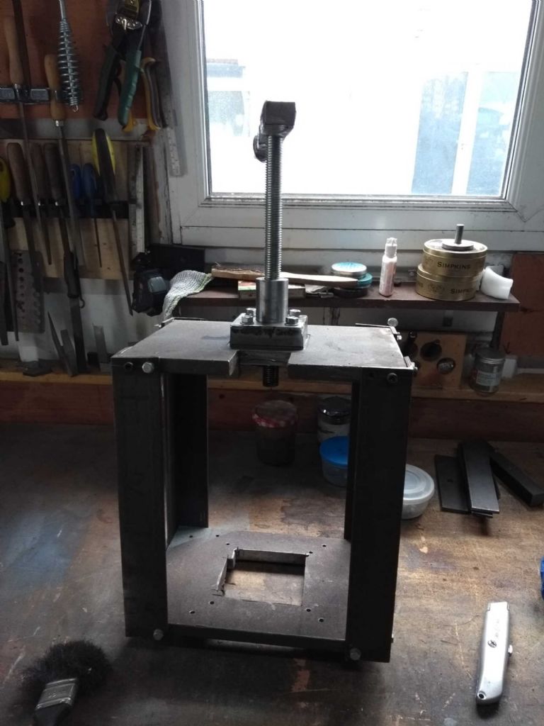

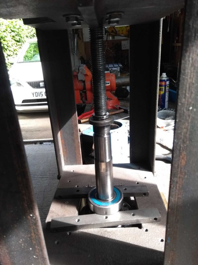

                            So, next was to strip down the lathe and press the spindle out. The stripping down went fine.
                            I'd made a press out of scrapyard junk for the last time I had the spindle out. Whilst I just about got the job done there were some design issues. Mainly that the screw wobbled terribly which made the work piece move. The solution was to add a support column to the above the screw. A 2 inch steel bar with an exact inside diameter and slotted (and glued – green loctite, so nothing's moving it) into a recess bored in the top.

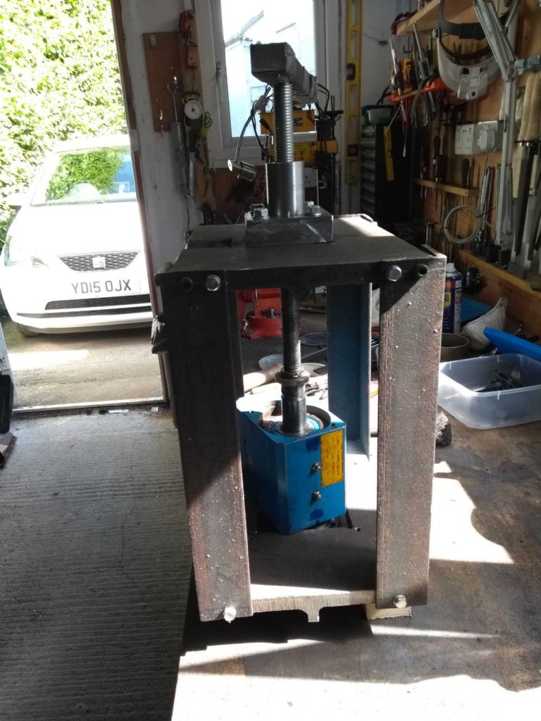

                            That's made a big difference.
                            Next to press out the spindle

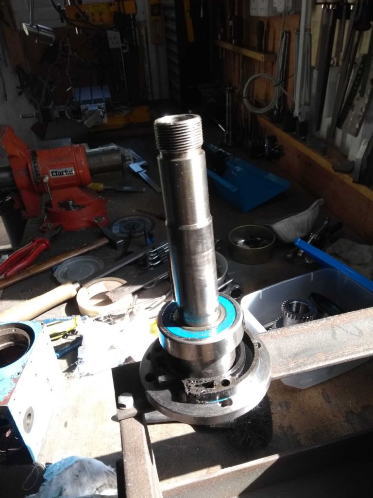

                            The results of that were quite interesting. From earlier comments the outside of the bearing should be an interference fit and the inside a slide fit. As you can see below, even with the creaking from the press, the outer bearing fit proved weaker than the inner bearing – that is the bearing stayed on.
                            This wasn't ideal news. However, it did provide evidence for my theory that I wasn't able to correctly pre-load because the inner bearings was jammed.
                            How to get the bearing off? Press to the rescue.
                            I thought things were going OK until the bearing got to the rear bearing position. At which point the damn thing burst open! Bearings all over the shed…
                            I was able to get the bearing off, but I think I will need to to get a replacement bearing(s – might get the pair), I don't feel that it will ever be the same even if I do find all the balls!

                                            Hi, All.
                                            Some time has been spent working on the spindle. John – I took your advice about a split lap.
                                            I had a handy piece of 1 inch wide 3 inch aluminium bar which I cut some shoulders on, drilled, and bored out.
                                            With this being the 'finished' product
                                            The offset shoulders is not some clever attempt to apply differential pressure, but as a result of my 6mm tap breaking off in the left had hole. This was most annoying, partularly as it was my favourite spiral tap. Finished the other hole off with my traditional set and hten drilled and tapped to 4 mm on the left having reduced the shoulder as you can see.
                                            Although the original advice was for valve grinding paste, I actually don't have any of that, but I do have a set of diamond grinding paste. I started off with what I think is 5micron (green) and after 10 or 15 mins I didn't see much change I upped to 10 micron (gray). I'm testing this by attempting to press the bearing home with my fingers after wiping the paste away.
                                            As I was getting bored turning the lap by hand, I finished of my polishing machine.
                                            Which seems to work rather well. Thankfully, there's enough throat to be able to take the spindle off without moving the lower plate so it stays nice centred.
                                            I would like to ask if 10 micron grit is about right – and how long I should expect this to take. The last thing I want to do is to take to much off!
                                            The other thing which I found was that the bore in the split lap was not round. it's a thou ish different across different axes. When you're boring on my little mill there is a good deal of vibration and I think that the head is more rigid in one direction than the other hence less movement and more cut.
                                            I don't think this invalidates the lap, mind you, just something to think on in future.
                                            Iain
                                            #428100
                                            old mart
                                              @oldmart
                                              Don't go overboard with relieving the fit of the bearings, they weren't designed to be sliding fits. You could easily end up with a scrap spindle.
