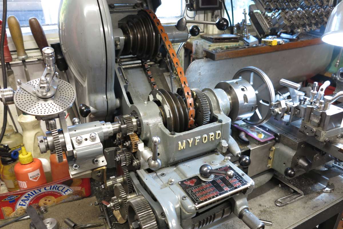

            You couldIMG_7654 do this

              Love the Myford solution – its a work of art- but given the amount of use it will get it is probably a bit OTT for my purposes.

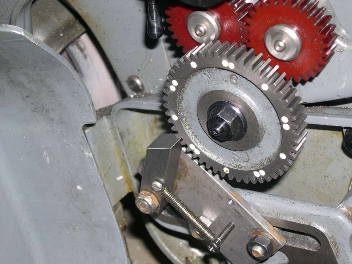

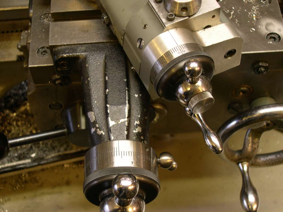

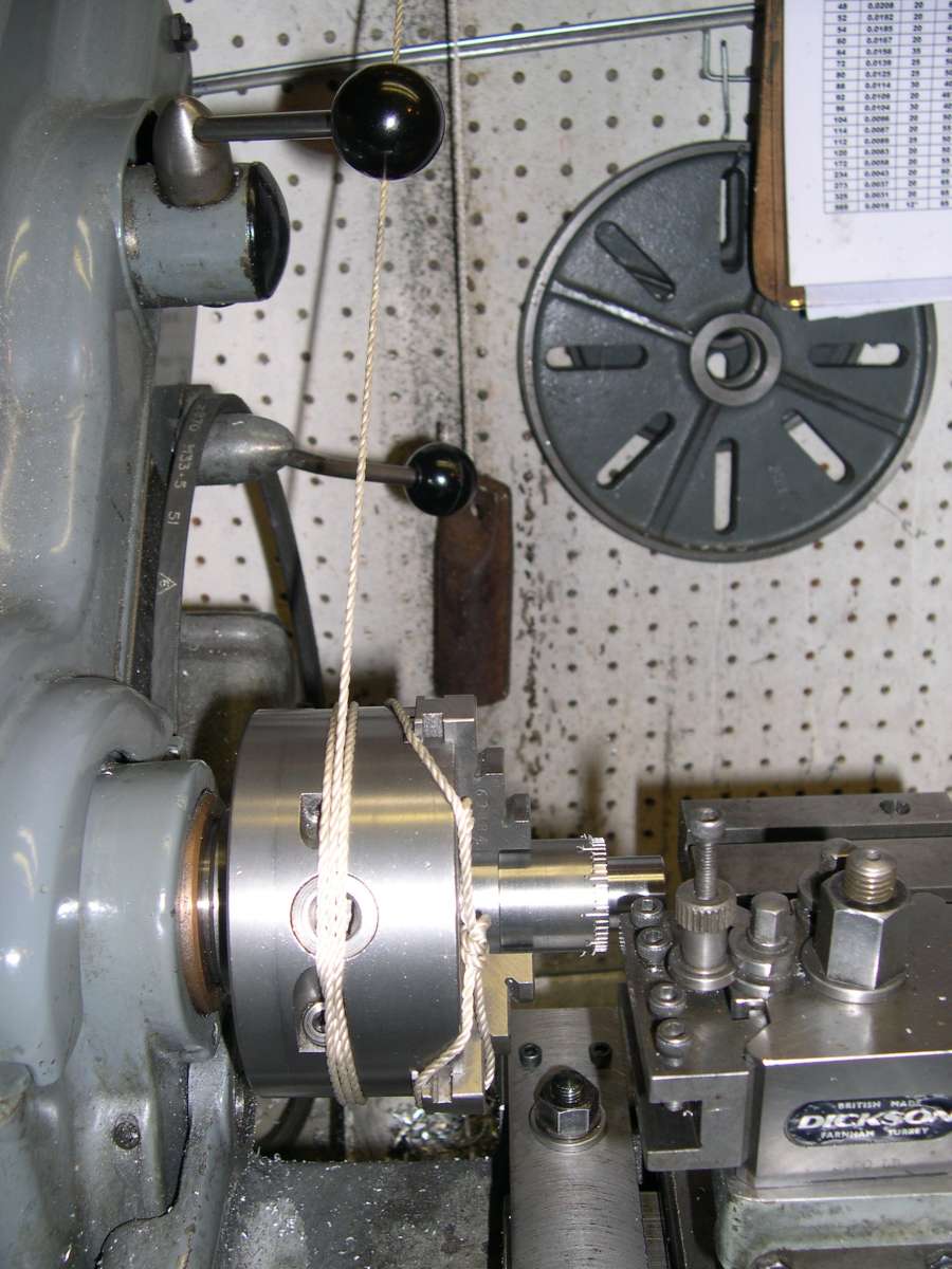

                    Simon
                    Here’s the system I have used to index the lathe to scribe the graduations on quite a few various dials ( Quorn, boring head, lathe cross and top slide, rotary table, etc …). By setting up the change wheels any divisions can by indexed. The picture below is set for 50 divisions. The cord wrapped around the chuck goes up over a pulley screwed to the bottom of the shelf on the wall behind the lathe and is connected to the old sash weight visible behind the chuck to eliminate backlash in the gear(s).

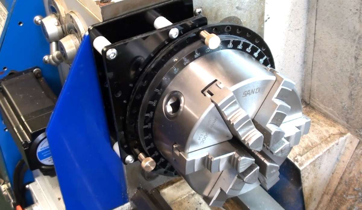

                        John Hinkley
                          @johnhinkley26699
                          Simon,
                          As far as I can see, you haven’t said which lathe you have, but if it’s of any use or gives you food for thoiught, I offer my take on it.
                          It’s was a progression from my simple indexing feature in MEW some while ago, further explored in my low-profile rotary table.  It consists of an annular ring which slips over the chuck and is secured thereto. Another ring, drilled at 10° intervals around the outside is overlayed by a segment plate, drilled at 11° intervals.  More complicated than is is, actually.  A picture paints a thousand words and a video or two even more, so …..
                          Spindle indexer mounted
                          It used to be in an album, now drifting in the multiverse, but a video to watch is here on YouTube.
                          It effectively gives you the equivalent of 360 holes drilled radially in the chuck backplate, indexed by a pin of some sort.

                              John Purdy
                                @johnpurdy78347
                                Simon
                                To do 360 degree graduations, use a compound gear train.  What I used for the Quorn and the rotary table was 75 x 25/70 x35/60 where 75 is on the tumbler, 25/70 on the first stud, 35/60 on the second stud, with 60 being the count wheel, each tooth being 1 degree. Any gear set up that will give a 2:1 and 3:1 reduction driving the 60 tooth count wheel will work.
                                In my second picture in my post above note the belt hanging on the lathe belt tension lever behind the chuck – that’s the primary drive belt removed. The last thing you want is the lathe to be inadvertently turned on when it is in this set up!!!

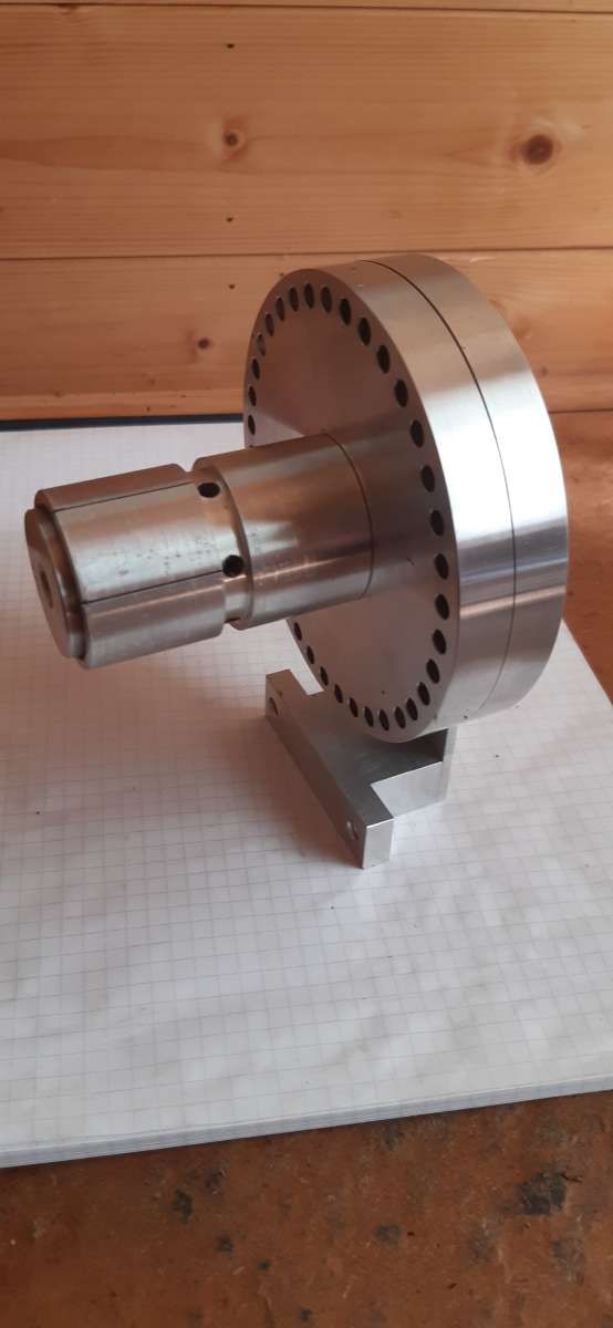

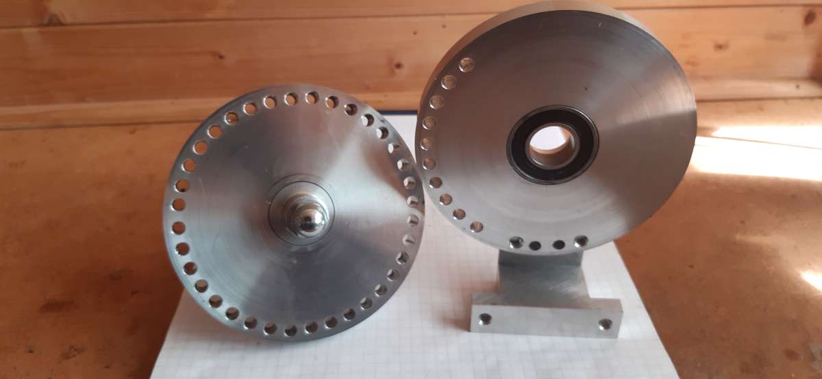

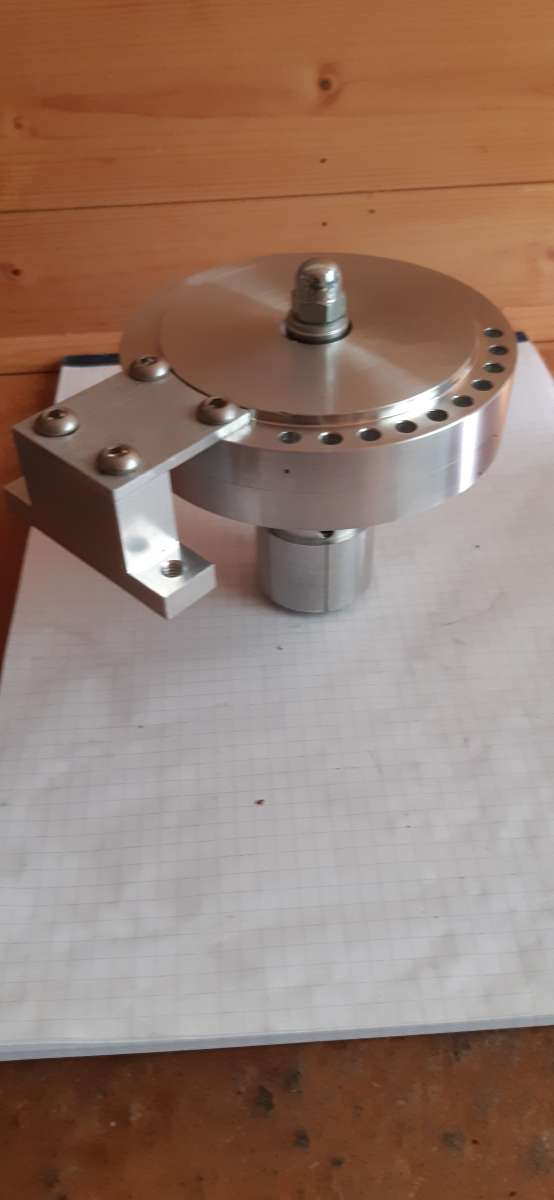

                                Simon Marks
                                  @simonmarks43050

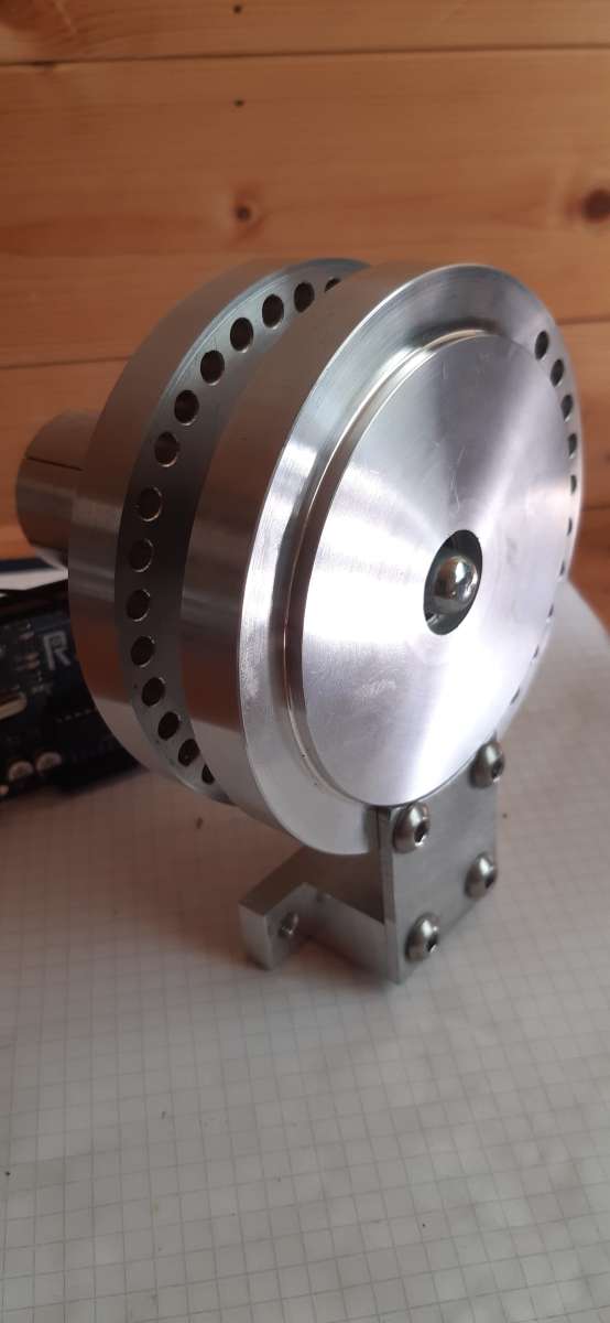

                                  Good afternoon,
                                  For those who might be interested and anyone who might want a solution to the same problem I thought I would update this thread and show the solution I came up with. This is for a Warco 290V.
                                  As I stated in an earlier message I have “borrowed” the spin indexer principle with 36 evenly spaced  holes in the inner plate and 10 holes spaced at 11 degrees on the outer.
                                  The nut in the Centre pulls on a tapered plug which locks the inner disc to the chucks rotation. The outer disc is fixed to the lathe body. This will give me the 360 graduations I need but will also give any number which is a factor of 360 so might prove useful for another project. These were all drilled using a bit of schoolboy maths and my DRO. Probably not the most accurate solution but after I reamed them through it seems be sufficient for my purposes.
                                  All I have left is to number the two plates, Anodize the parts and Loctite the outer disc in place.
                                  Regards
                                  Simon
                                  ps Sorry if this is a bit simple for most of you but I thought it might help another beginner facing the same problem as I was.1234
