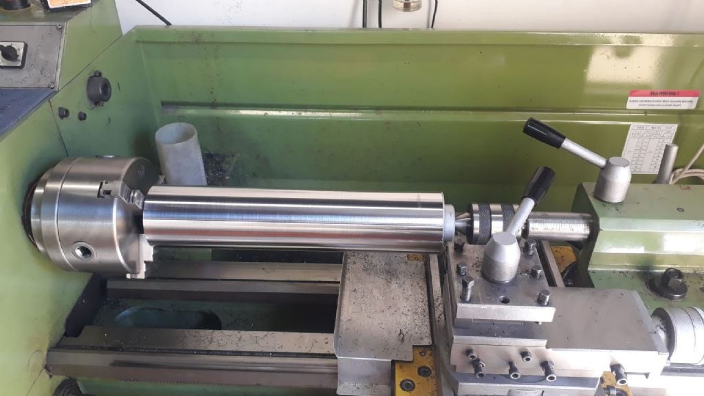

      Not having much where to go I spent the afternoon in the workshop helping out a friend with a project he has. Part of the project required an 18" length of 3" dia schedule 80 pipe to be turned down to 68mm dia. I set up the pipe on my WM280 lathe, one end held internally on the 3 jaw and the other end supported on a revolving centre – I had to fit a cap to the end of the pipe to be able to support the pipe on the centre.
      As there was quite some material to be removed and the pipe was quite long this was going to take quite some time so I set the feed selector on B (the highest).
      Initially I started with 0.5mm passes at about 400rpm but this left a very poor finish for around 4" to the tailstock end. The finish was almost similar to steep angled knurling! I tried reducing depth of cut and use a finer feed selection but with same result, chuck side is close to mirror finish, tailstock side looks like a multi-start thread.

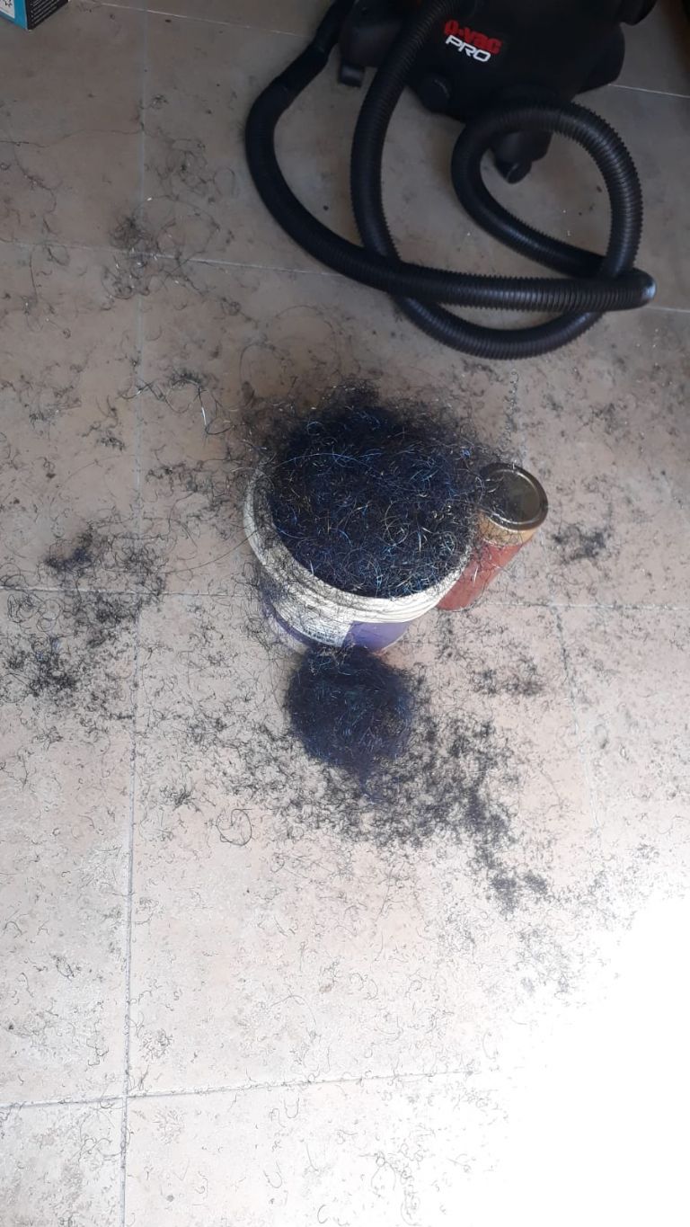

      Out of frustration I cranked up the speed to 1500rpm with a shallow 0.1mm cut and the problem with surface finish disappeared – mirror finish all through the whole length. Not happy tho, I hate blue stringy swarf which does not break off. I was using a TNMG carbide insert which I normally use without any problems at all.

                        I'm pretty sure the pipe was not the seam welded type, it machined pretty well for the 3/4 part closest to the chuck, it was the last quarter which gave me a headache, which is strange, but then again, I had never turned that length of pipe. Spring passes in the end solved the issue, I was more worried about the swarf getting at me!
                        Finished
                        Swarf!!

                          Personally, I'd be pleased with that, well done!
                          The multi-thread problem at the tail-stock end is likely due to movement; it doesn't take much to spoil things. Maybe a steady would have helped.
                          However increasing speed and depth of cut is often a very good idea with carbide. There's some combination of tool-shape, surface cutting speed and feed-rate that works best with the material being cut. There's no guarantee in a limited home workshop that all four can be satisfied at the same time. HSS may be easier because it works well at slower speeds than carbide, but grinding the tool is your problem!

                              The only time I've seen frizzy blue swarf like that shown was when turning hardened silver steel with a CBN insert. The turning was done at high speed, shallow DOC and a high feedrate. The swarf was also very brittle.
                              Andrew

                                The swarf was brittle when I was taking a deeper cuts at a higher feed rate, but there were also some sparks and thought the insert would not like that, so I reduced the feed and depth of cut.
